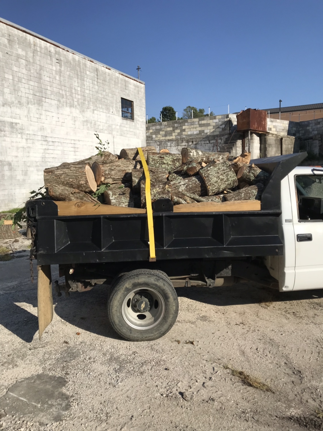

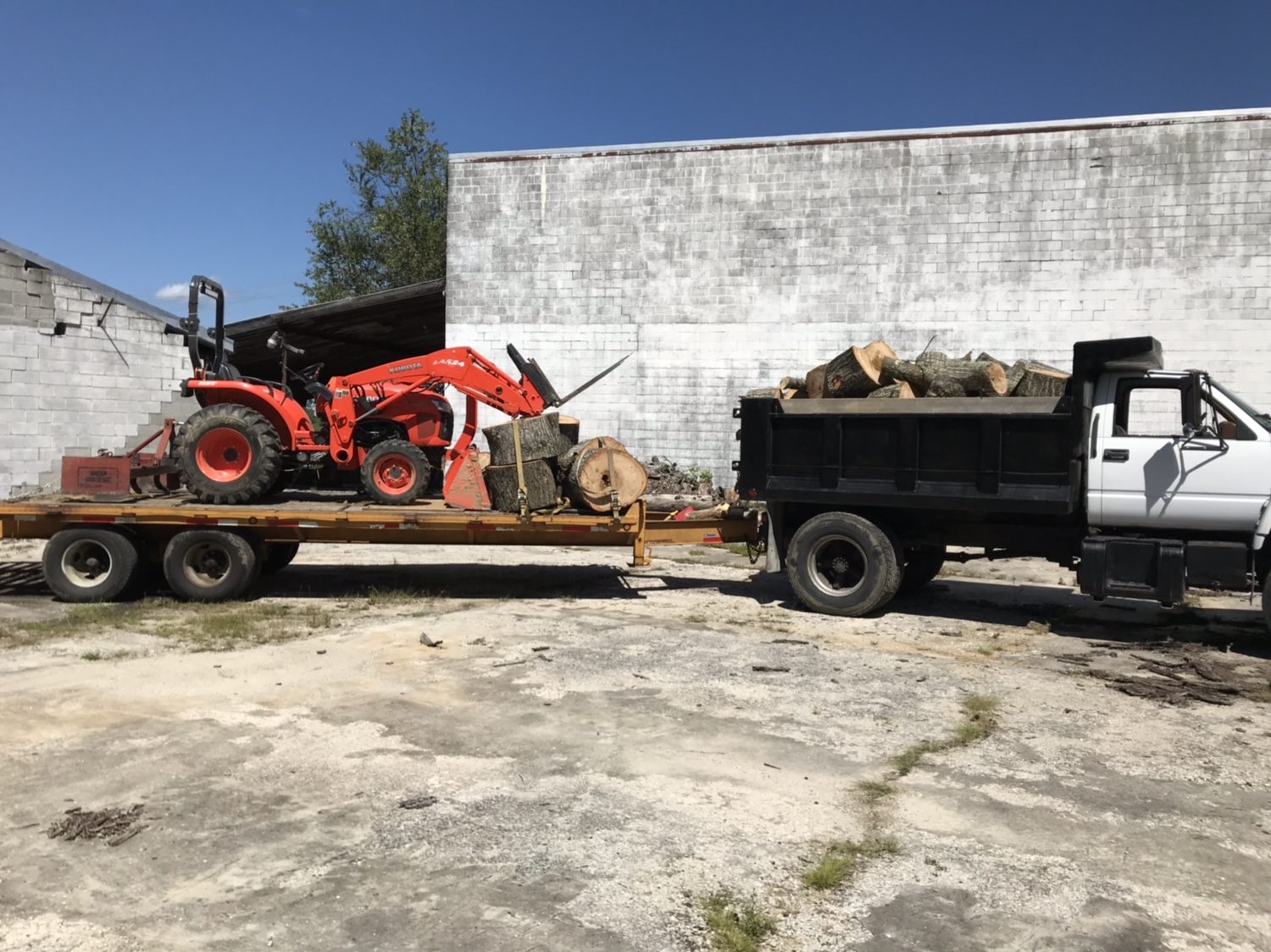

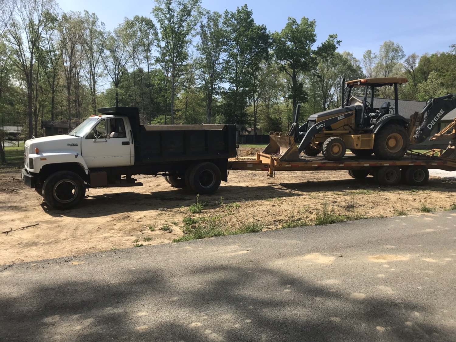

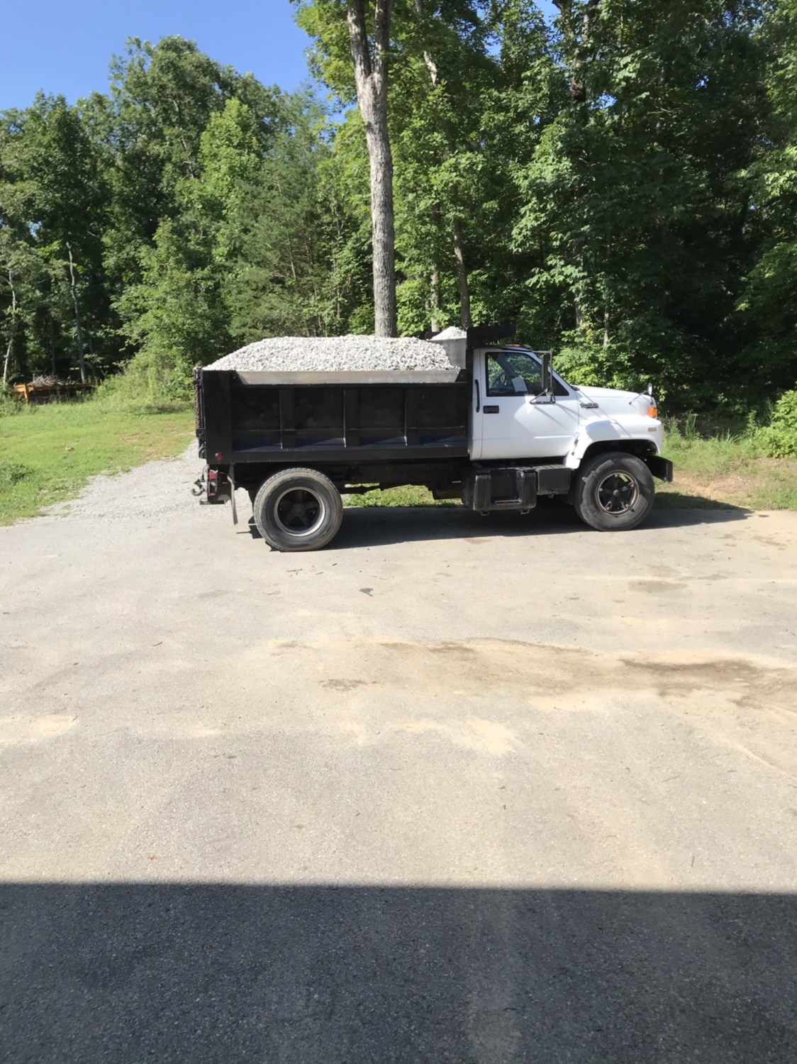

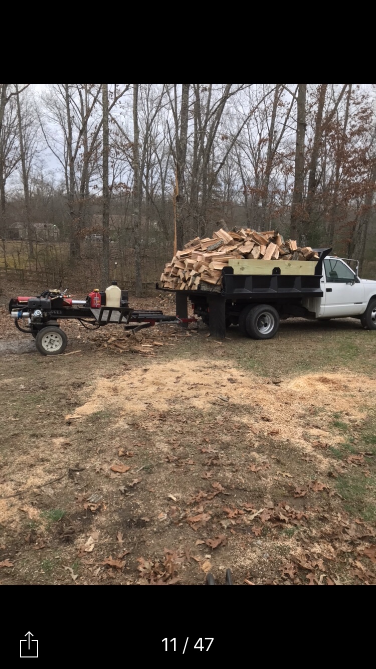

It doesn’t set land speed records with the 366 gas burner but its a workhorse. My one ton doesn’t sit around collecting dust but it’s a far cry from what the Topkick is. IMG_7369.JPGIMG_7076.JPGIMG_6825.JPGIMG_7422.JPGIMG_7070.JPG
