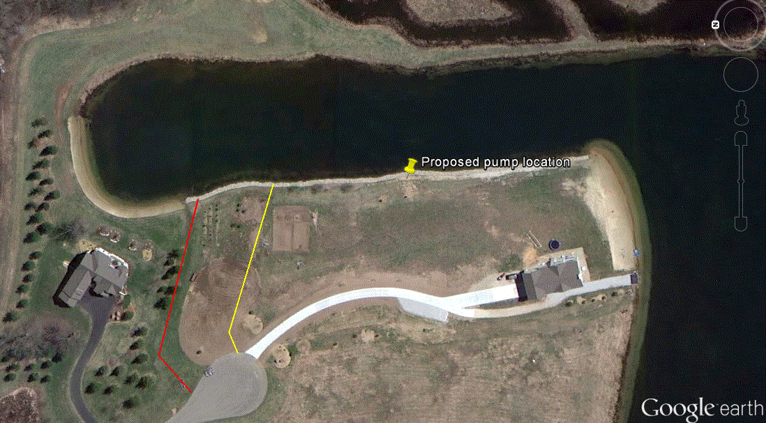

One of the joys of developing a 3.5 acre lot is the never ending list of projects that needs to get done - let alone all the seat time I get on my Kubota!!
My next project is to install an irrigation system for the property. Here's my question for the more creative minds out there - what is a good way of hiding the pump and associated plumbing manifold that will have to be installed near the shoreline. One idea that my wife had was to build a bench with an arbor around it, hiding all the bits under the bench. Not a bad thought!!
What other creative thoughts are out there? Or perhaps you have already conquered such a project and would like to share your results. Pictures are especially welcomed!! :thumbsup:
Here's a Google Earth picture of our property with the proposed pump location indicated.

Irrigation valves are designed to be installed below ground inside plastic boxes with lids. There are several types of the boxes from ones that only cover one valve to ones that can hold a manifold with several valves.
This is, of course, if you intend on using electric irrigation valves that connect to a clock timer for operation. If you were planning a "manual" manifold with gate/ball valves - think again ... a few trips to a manual system when you are tired or whatever will make you wish you had automated the system.
Is the well already in or are you pulling the water from the pond/lake? Will the pump be above ground or submersible? There are many ways to disguise them, and they each have their good/bad points.
Are you planning on installing the system yourself? Much will depend on the flow your system delivers when it comes to designing and installing the system.

Thanks for the great feedback so far.
Here are some additional points in response to your questions. I am planning on pulling water from the lake and have already acquired the pump, intake screen, etc. I had a professional design done by a local Toro vendor and plan on installing the system by myself.
Some of my main questions are related to how best to situate the pump and associated output to the multiple zones that will be needed. I plan on doing the system in phases and so will need to plan for that when designing the output end.
Also, I will need to be able to easily disconnect the pump (electric and pipe fittings) to bring it in for the winter each year.
So, again - looking for ideas as well as pics / drawings on what has already been done by all the great members of TBN.
Keep the ideas coming!:thumbsup:
