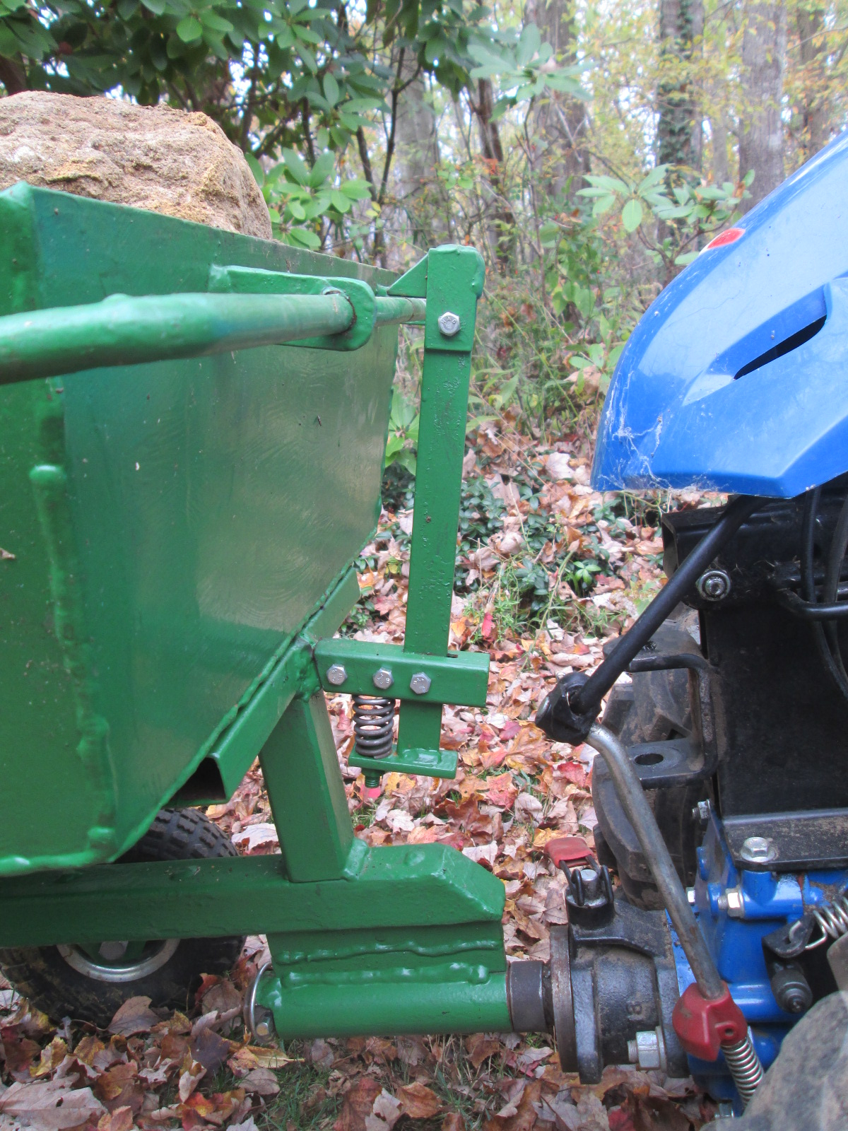

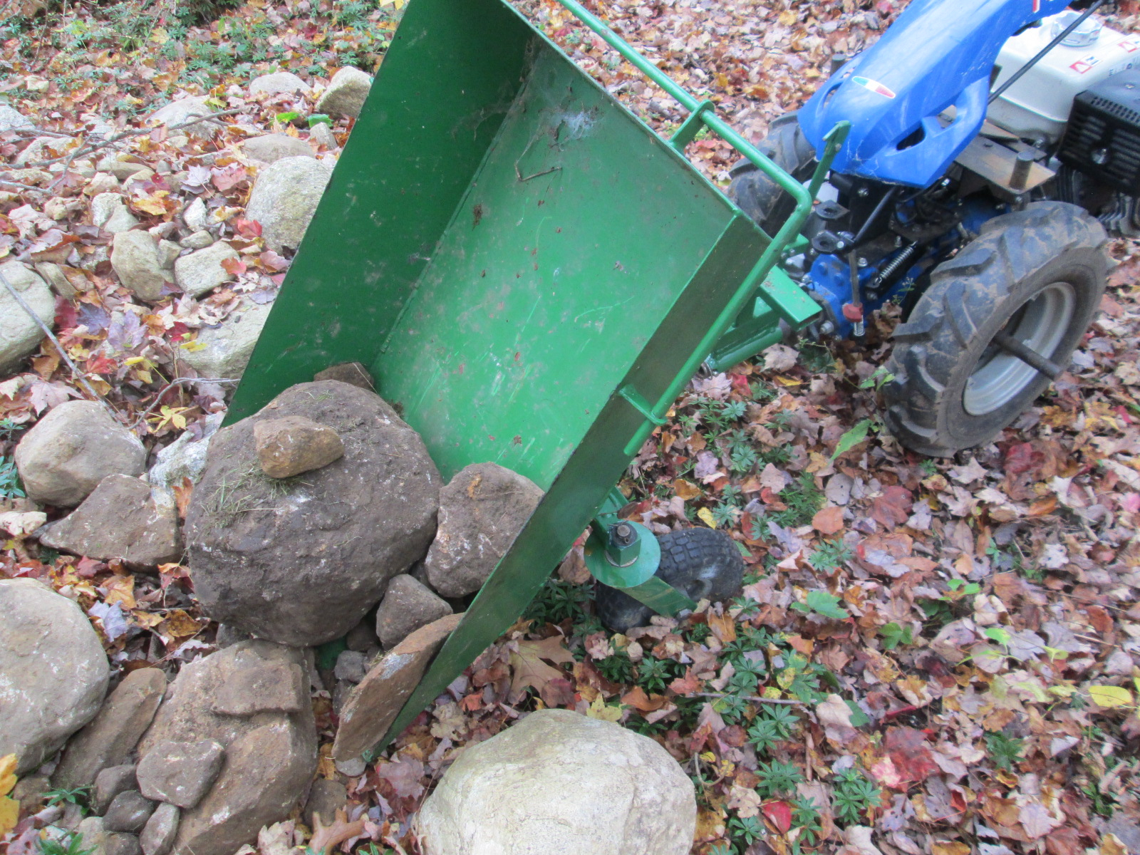

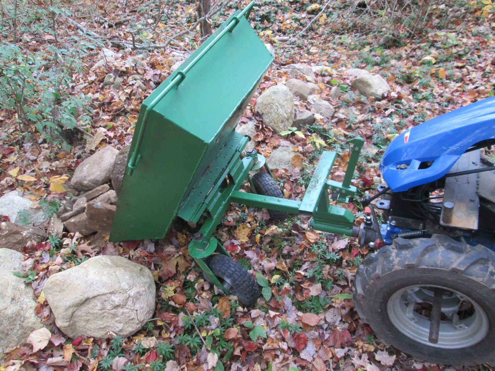

I tried to copy some of the designs I saw in the forum here. Worked out very well and does carry a heavy load. The latch mechanism uses a stainless steel exhaust spring off my, now deceased, 1996 Geo Metro. I tried to balance the load about 60% behind the dump pivot to keep the weight on the tractor but still make it easy enough to dump.

Very good job. I think you will find it very useful. I like the box, looks very sturdy. What gauge metal did you use? Also like the rail around the outside, looks handy to tie stuff down and to help lift. My old contractor wheel barrow tub is just about past its useful life, will probably have to rebuild it this year.

I think that is 10 gauge steel cmyoug2. About 0.135 plus a thick coat of tractor supply tractor and implement oil based enamel. It's very heavy steel. I'm sure it will outlast me.
It doesn't take many big heavy rocks for this to really pay off. I could never have even attempted to move that load in a hand wheel barrow. I think I tried to copy yours among others. Yes, needed a locking latch and a handle for easy dumping.
