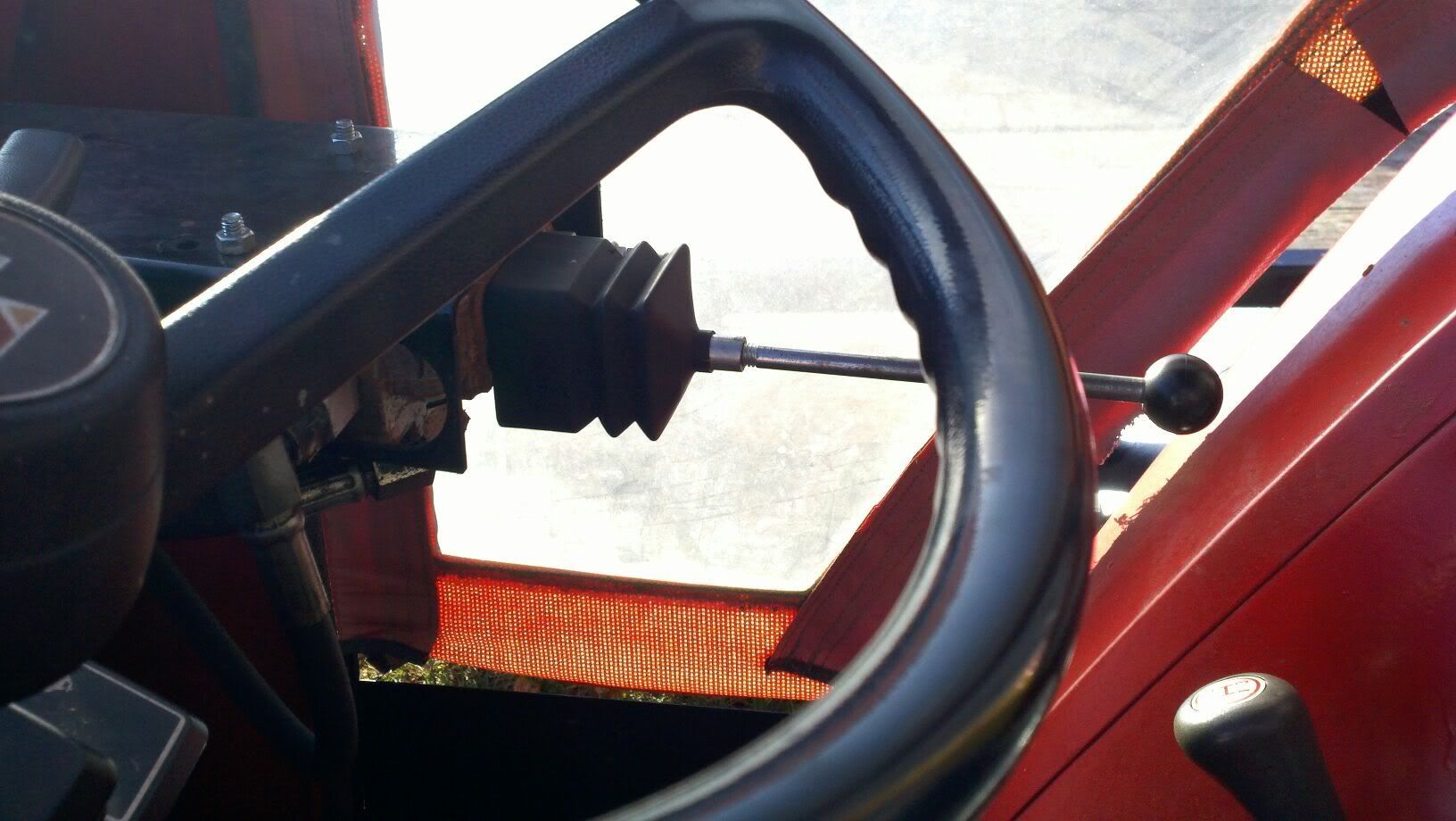

Mine is connected like that and it does the same exact thing. You can feel the detent for the bucket curl, but if you push it too fast for lowering the the whole loader, it flies up in the opposite direction and shakes the whole tractor. I have been dealing with it by being very careful while lowering. But it is a pain. I could post a video when its not raining.
Is your joystick sloppy or sticking? The Nimco valve on my tractor had a mechanical failure of the pivot point. This allowed the valve to actuate valves in a non-standard way.
Specifically, if I pushed too far forward, the loader would initially work as expected, but when the pivot point would lift out of place a bit, the rear valves would be pulled up farther than it was supposed to.
I think this somehow interfered with the normal flow of the circuits, causing a rapid reversal of the cylinder.
I'm sure others can explain this better.
You can try pushing the base of the joystick against the valve assembly and take note if it feels like it is slipping or lifting out of place. May feel a resistance (may feel like a detent), hear a clicking noise, or the valve may seem overly stiff or floppy.
If so, pull the boot up off the valve with the bucket fully down and the tractor off. Move the valve around and watch for any parts coming out of place. Make sure the joystick components pivot smoothly and completely.
Hope this helps!
- JC

Ok guys here is what I have come up with,
The cheaper valve is backwards compared to the nimco. The float for the boom will be to the left. Right now I have it straight up. As in up and down control boom and left to right control bucket. But the cheaper one from surplus is opposite. There is a:
First Spool Regen -
Fourth position allows for rapid
extension of cylinder.
This is supposed to be for the bucket not the boom. I will swap the working ports and post back the result.
-Tim

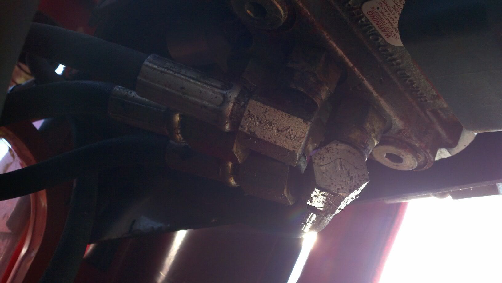

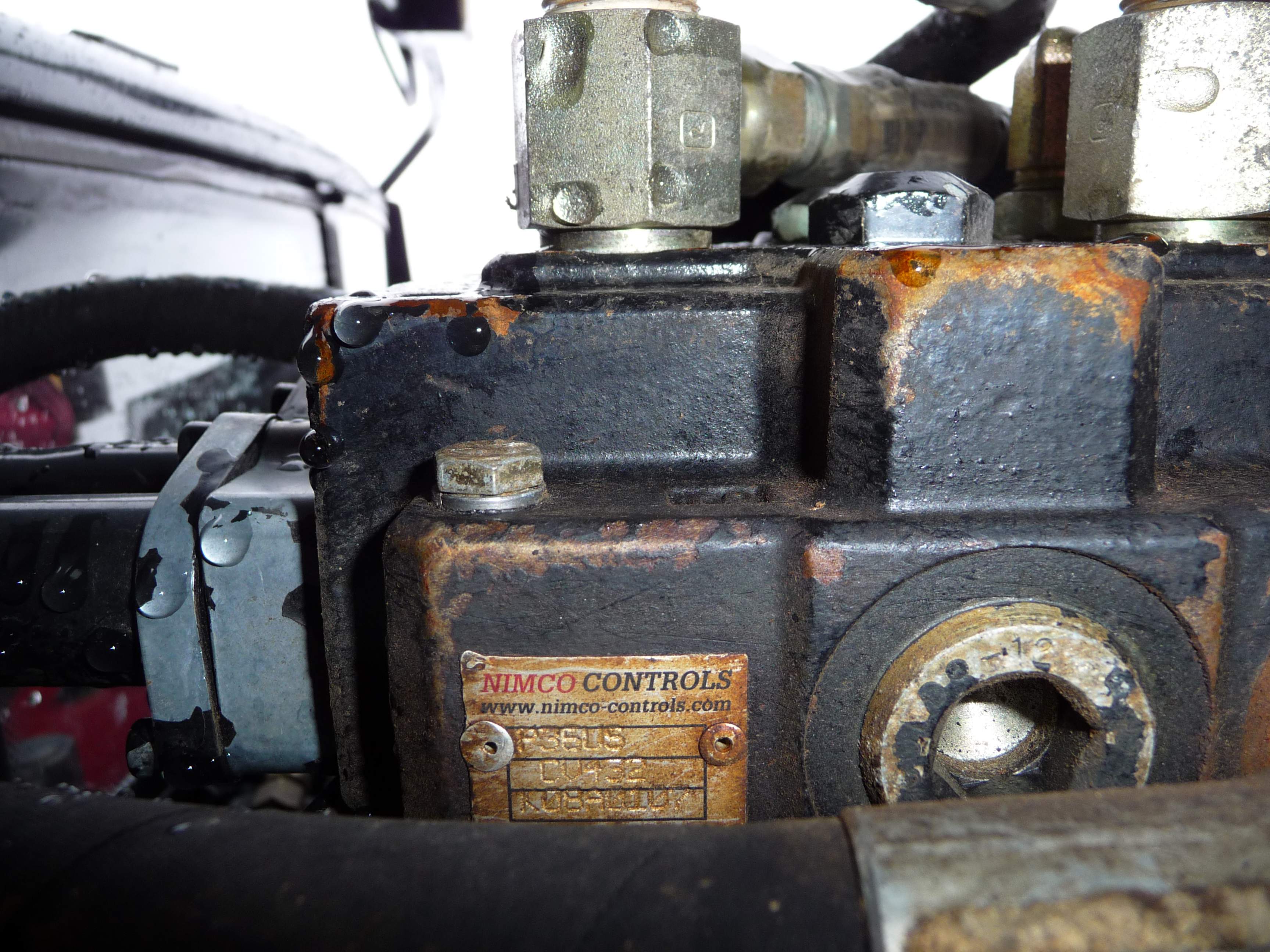

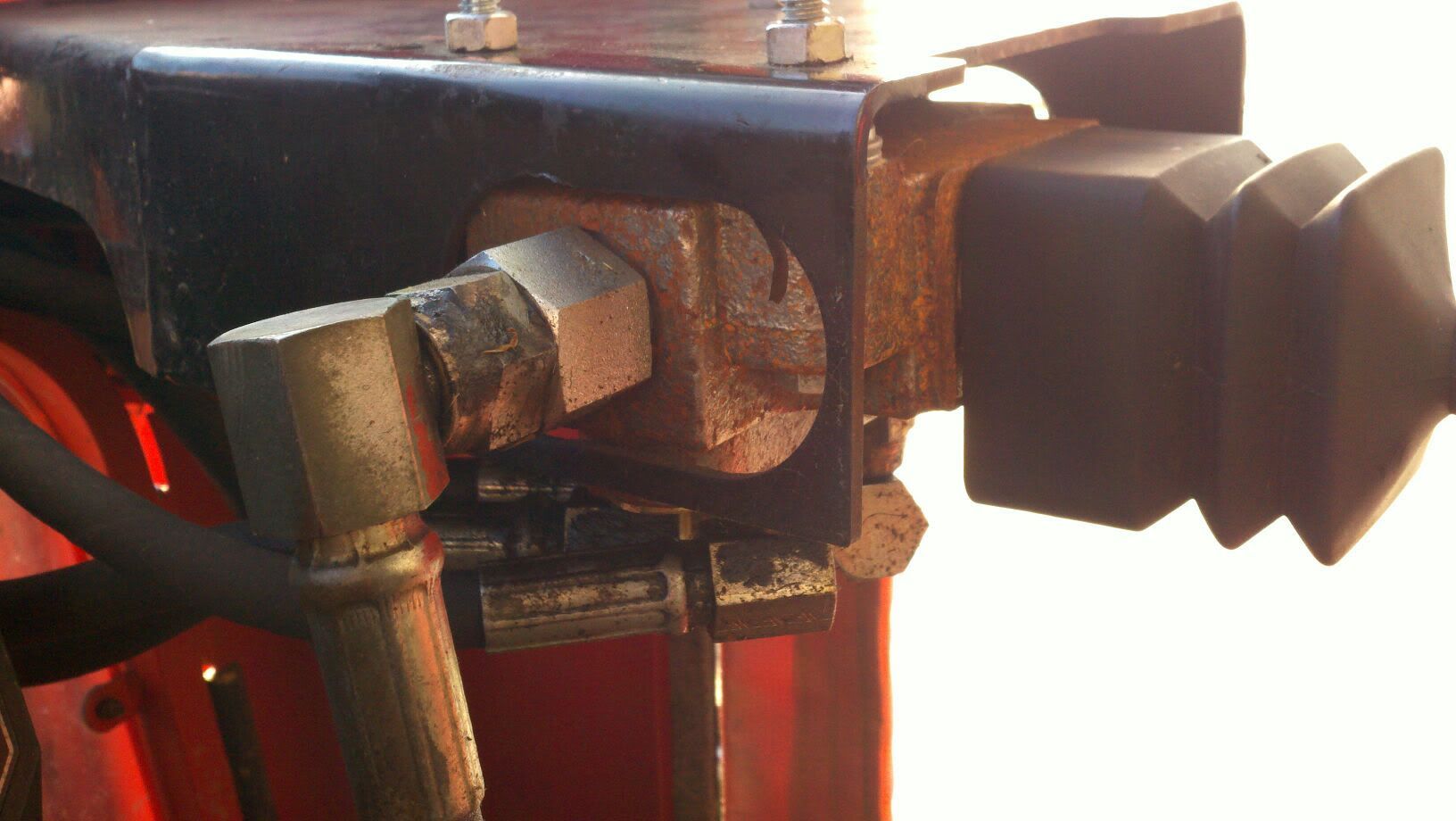

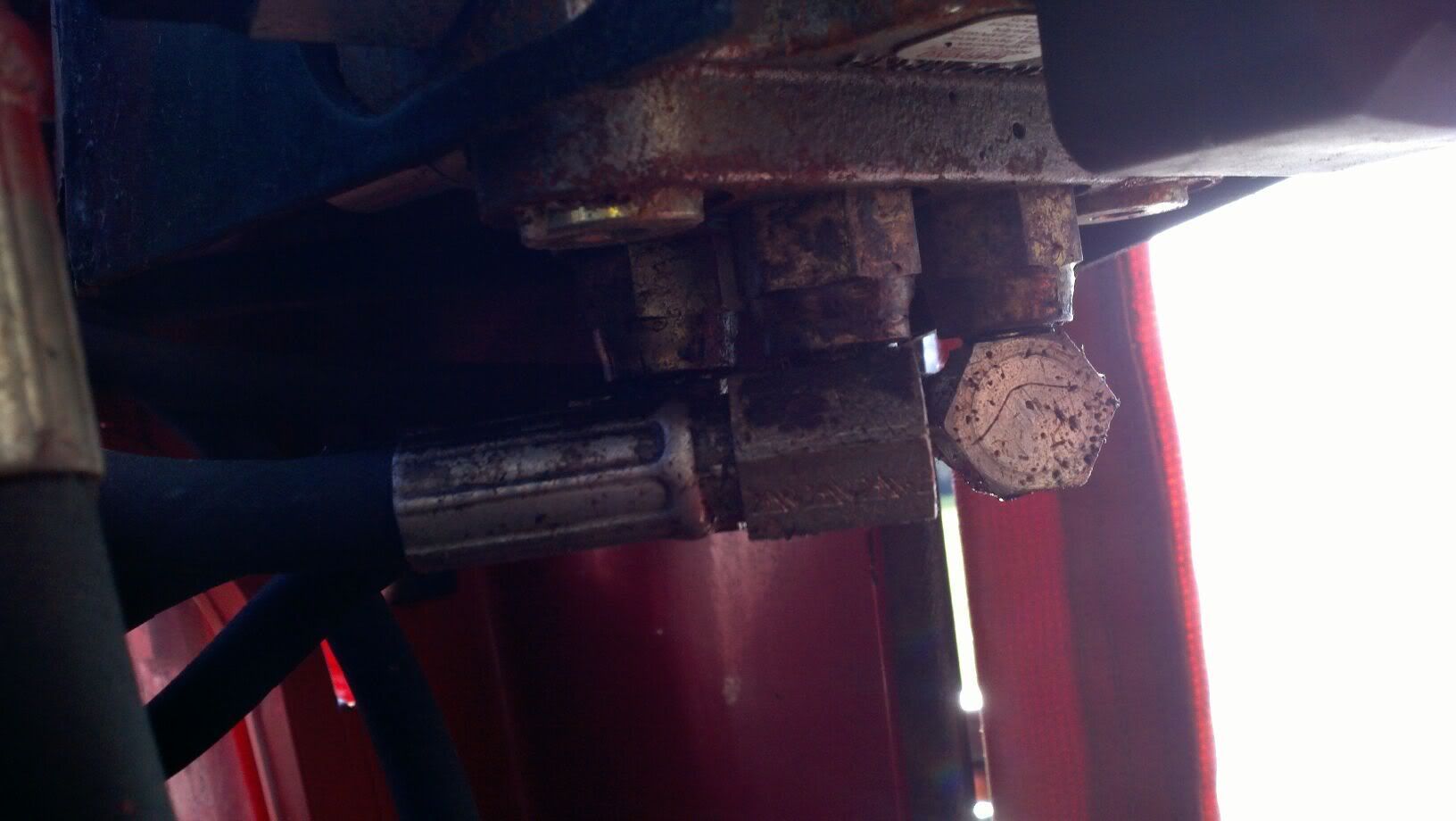

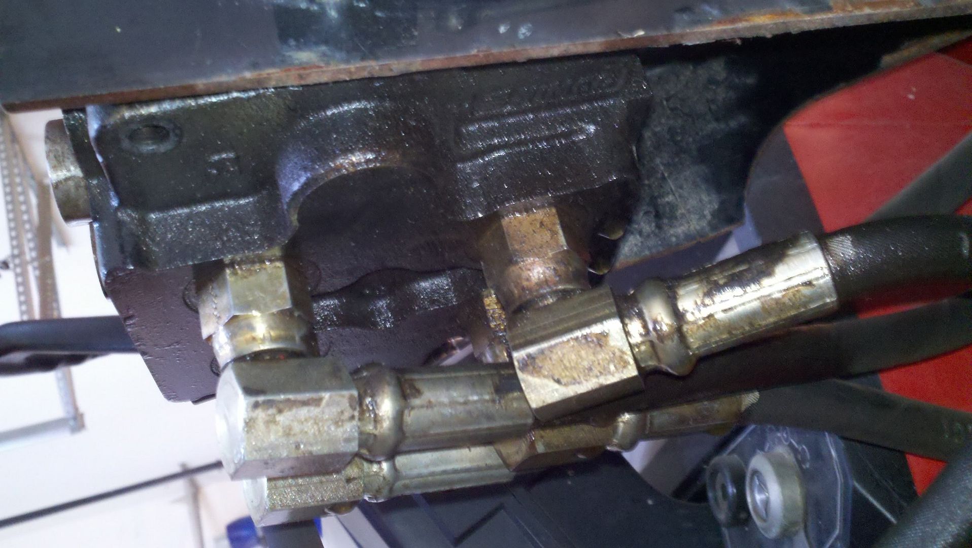

As promised here is a video and some pictures:
Original Leaky Nimco Valve (old picture I have previously taken):
new surplus valve:
new surplus valve 2:
new surplus valve 3:
working ports 1:
working ports 2:

Maybe this will help as to the position of the levers and operation of the valve.
Just for reference. Third page .
http://www.surpluscenter.com/Instruct/I9-7401.pdf
Which ever way you have to mount the valve to get it to work like the illustration on page three.

Yeahh. Thats what i was able to do today. Works good now. Awesome cost saver in the end.

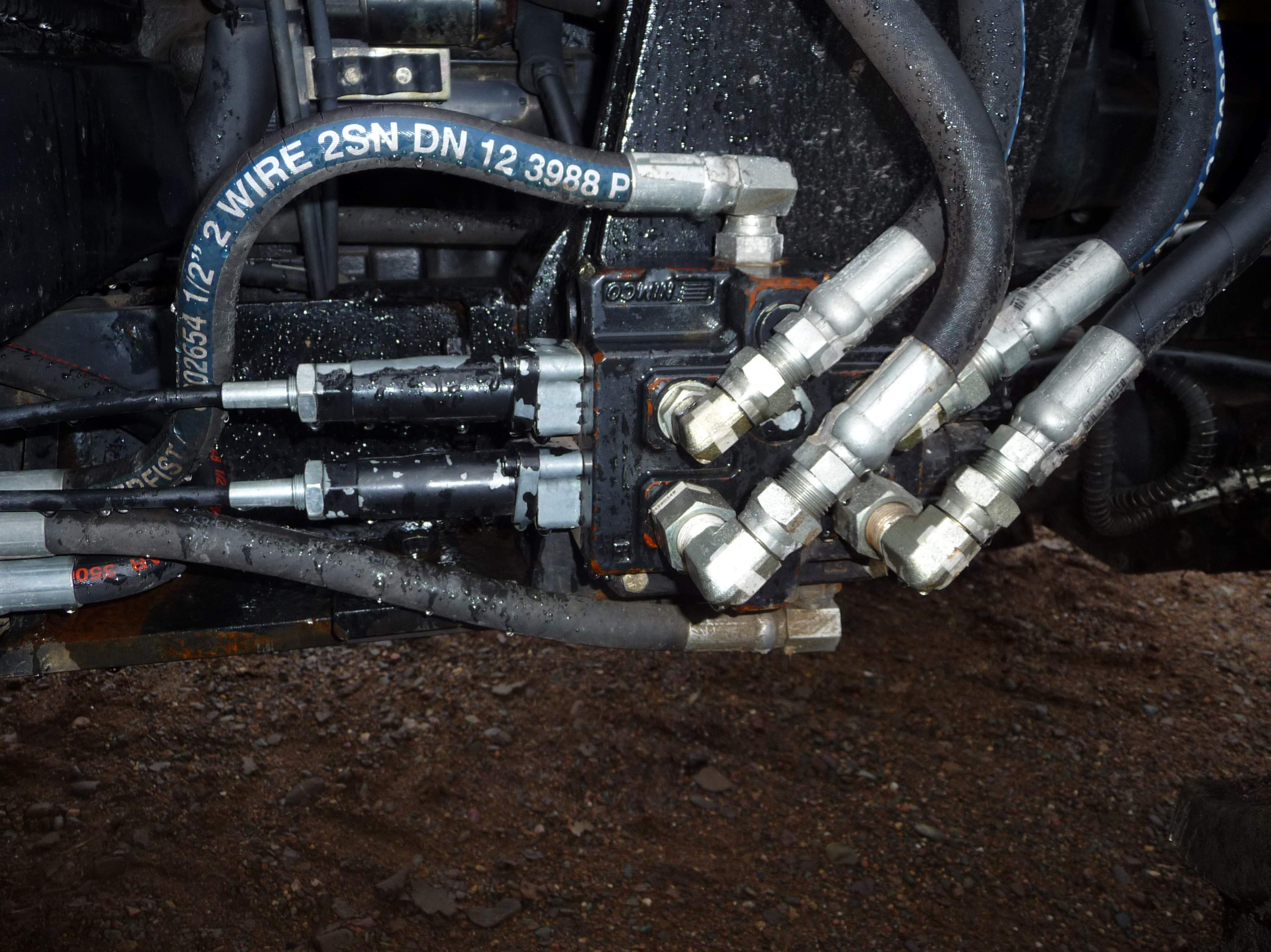

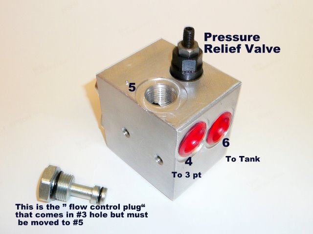

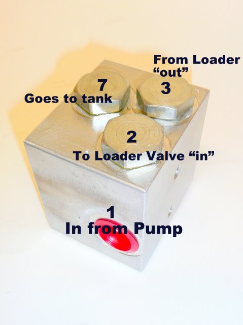

Hi Folks
Currently my loader is operating slower than it should, the CV432 control is first after the pump and before the remotes and 3pt hitch hydraulics, however there is a flow divider block in the pressure line just before the CV432 valve.
Is the Nimco CV432 an open circuit valve ?
Does it have an internal PRV, when I look at the valve on my tractor and compare to the same valve on the Nimco website the valve on the site has an external PRV showing just above the cable connection points, mine appears to be just a threaded in plug ?
I would like to remove my flow divider but I want to be sure that the CV432 control valve I have is going to bypass the pressure when my loader reaches the end of cylinder travel.
Thanks
Troy

The valve is open center.
I believe there is a relief valve in the bottom left of the picture by the spool control.
That is a 26 GPM valve.
What is the pump size in GPM on this machine.
If your relief on your valve is a threaded plug, then they are using the relief on the hyd block for the protection to the circuit.
Why so you want to remove the flow control from the circuit?
Can you show another picture of the whole loader valve, and all sides of the hyd block with relief valve in it?
