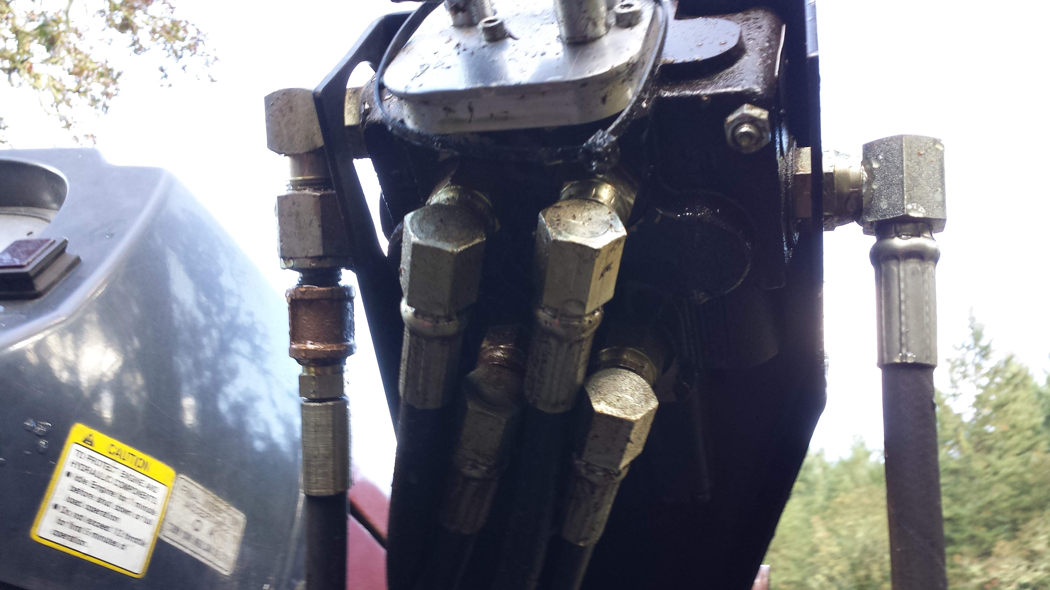

I posted this as a reply to TJ200, but it appears at the bottom of the thread- I was hoping he might reply.
I appreciate that this is an old thread, but I had a question. First of all, thanks for a great post on replacing a Nimco 2S-40272- I appreciate the pictures.
It appears that you have mounted your new Surplus Center 9-7401 control valve (BRAND Model LV22RFSTKAB) valve from the top. I spoke to a rep at Surplus Center who flatly said it could only be mounted from the side. I'm confused because your application looks just like mine (TL200 loader on a TYM HST330). My old Nimco keeps blowing O-rings and it's cheaper to replace it than to have a professional repair it.
Here's a photo of my application viewed from the bottom where you can see that it is mounted underneath the mounting bracket. Am I correctly interpreting that this is how yours is mounted? Now that three years have passed, are you happy with the control?
Anyone else care to comment?
Thanks!

Hi guys, I am just getting back active again. The surplus mount is just like the nimco however the hydraulic pattern is almost impossible to get used to. It is meant to be mounted on its side.

For anyone wanting to replace the Nimco valve 2S-4027-2, a Prince LVT 1GB5AB7 can be mounted in any position. It's a joystick valve. Can be bought on Amazon for $288. Need 6 fitting adaptors to make the hose on a Massey 1246 loader fit. Fitting were about $18 total.
Nimco is a company who does not want to deal with the little guy. You need to have a massive order to get any help from them. The repair kit for the above mentioned valve is available from them, but the parts did not last me a year. The white O ring was mush when I removed it.
