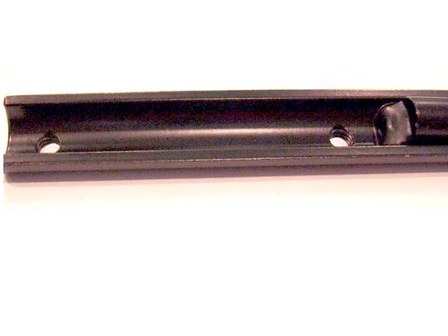

That's the same as the one I received.
Thanks for posting the photos. I haven't had a chance to get the camera and set everything up.

Thanks for the photos, Mark. Very nice! /forums/images/graemlins/grin.gif

RaT, the problem has been solved (or at least I think so). Markie posted pictures of the new joystick support shaft and it looks good (attached - thanks, Mark). I don't have one yet, but I'm sure I will before long. I'm hoping this thread stays alive so when others have the problem, they will have a resource to get find out the background and that there is a solution at their New Holland dealer. There are probably many dealers who don't know about this, so it will be up to the tractor owner to tell them about the new joystick.

Just took my TC35D over to the dealer last night for a service call this week. Just talked with service man Allan, and he said that they have a TSB for this joystick problem. They take some round stock and weld it and redrill the holes. He said he'd show me when I come to pick it up. I'll take my camera.

About 10 hours of loader use with the new style and no complaints. The old one used to actually "creak" up until it snapped. New style is very solid.
