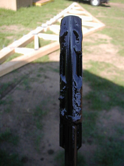

Hi Jim.
Here is the dealer modified joystick that I installed on our 40D. After looking it over closely, I'm satisfied with how they beefed it up and don't see how this one could fail as easily. Hopefully some of the other TBN members will be getting modified joysticks from dealers instead of the lame OEM one. Time will tell. Thanks, Matt.

Thanks for the photo, Matt. That is definitely not going to break, but I can't see the screw holes for the plastic cover with the turtle/rabbit buttons. It's very hard to take a high contrast picture of something black, especially in the shade. Did they drill through the flat plate stock and the round stock too? I think you have the best solution I've seen so far. /forums/images/graemlins/cool.gif

Matt,
I am going to have a friend of mine rework my broken No-Joy-Joystick in a similar manner. I do not have the metal working resources for such a task but this guy is a craftsman. I will post pictures when finished and report on any problems.
BTW, did the electrical line still fit in the handle after adding all that steel?
