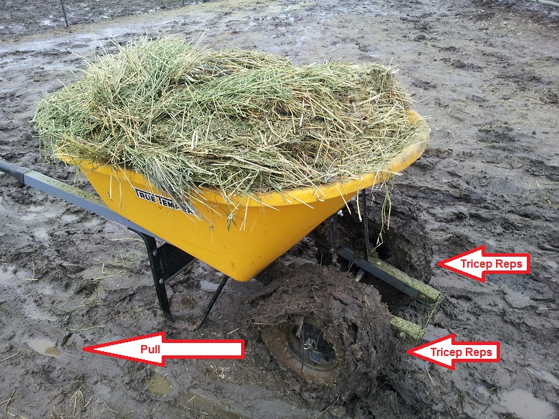

Not sure how it will help, but it takes a lot more time for me to take care of my stock, so now that I feel like I did SOMEthing, maybe I won't be so angry about the whole thing while I'm feeding/freezing. I'm slogging, now through 3 to 4 inches of snow ON TOP OF frozen black clay with wheelbarrows, now. Not able (STILL) to carry bales to my cattle, and not able to water my stock in big pails like I used to (pipes frozen). Stalls are all flooded with the melting snow now, so can't fix the drainage issues or take the poop to the pile and clean my barn properly.
I just figured they ought to know that since I can't get my outside work done, I'll have time to write some reviews, like to Consumer Affairs. (Boy, those people really had Kubota problems! Mine will just be another needle in a bowl of needles.)
Next week, it will be a month? I can't believe it. Well, I've stayed in as long as I could... Time to go feed the zoo...
