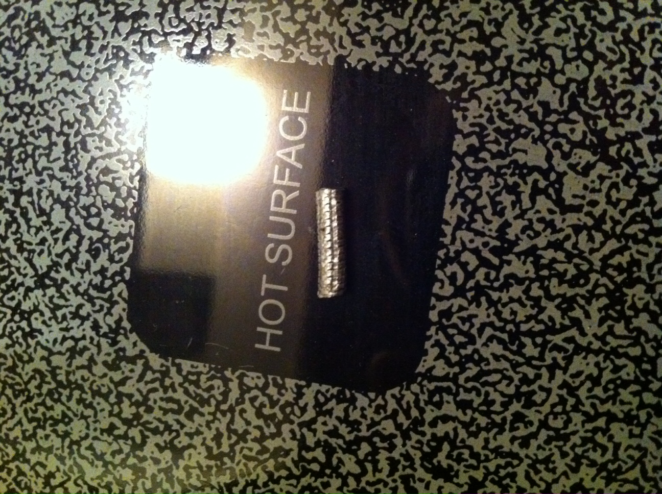

I believe I may be onto something here...my neighbor came over and we bounced ideas off of each other, long story short we pulled out the distributor. Low and behold, who ever owned the tractor previously though it would be a good idea to hold the timing gear (I think that's what it's called) on the distributor shaft with a...screw. I now believe that when I throttled it up and down I snapped the head off the screw and the gear slipped, by about 1/8" resulting in my non firing. I ran out of garage time tonight since I work at 7:30am so I still haven't cranked it over but I'm crossing my fingers and hoping that tomorrow will be the day. I'm going to bring up cylinder 1 to top center and align the distributor so hopefully that will do it! I attached a pic of the culprit below...I'm not a serious mechanic by any stretch, but I sure as **** wouldn't use a screw in place of a roll pin...it has since been replaced with the correct roll pin.
Look at this beauty...
Hopefully this will do the trick.
