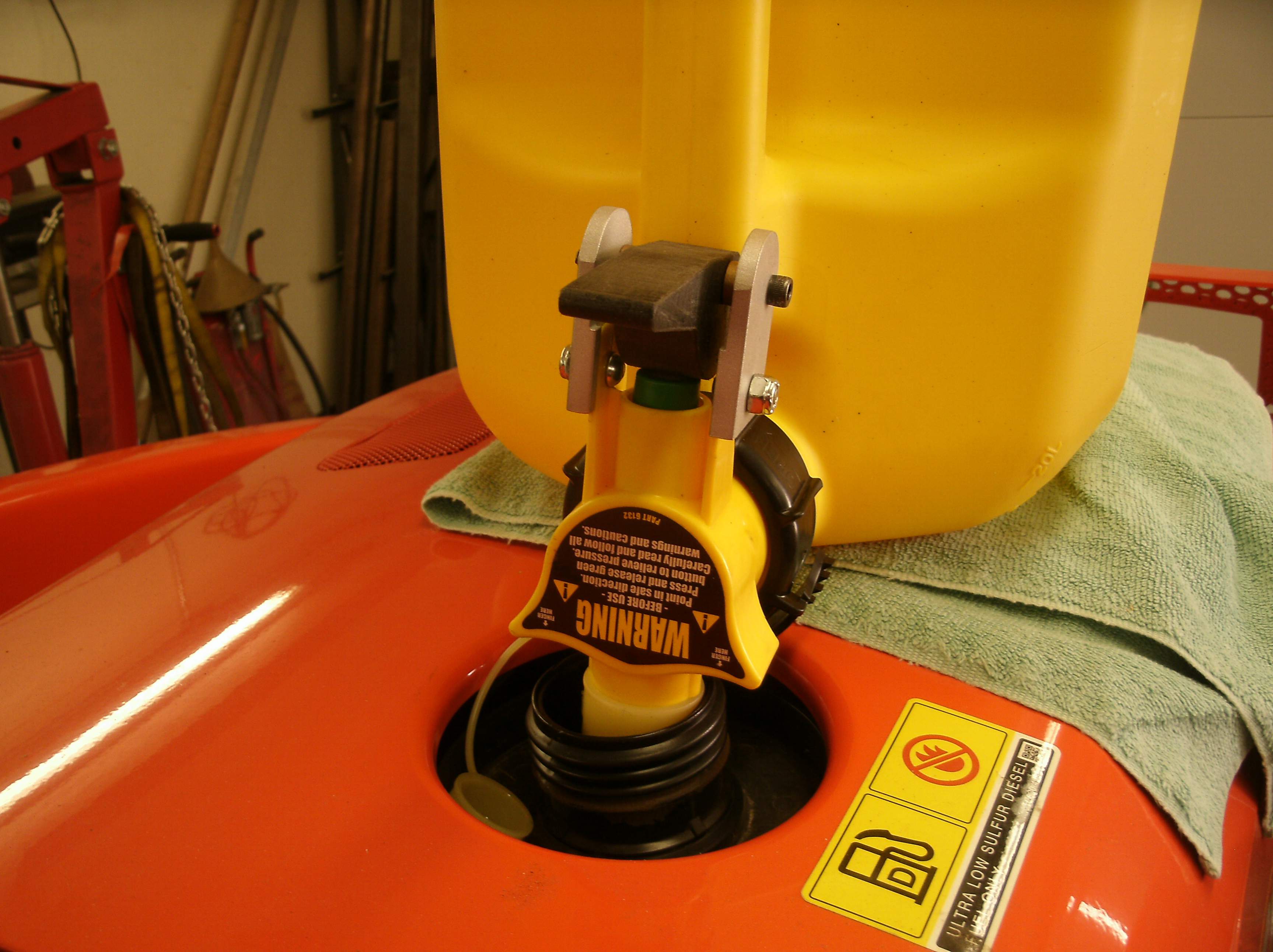

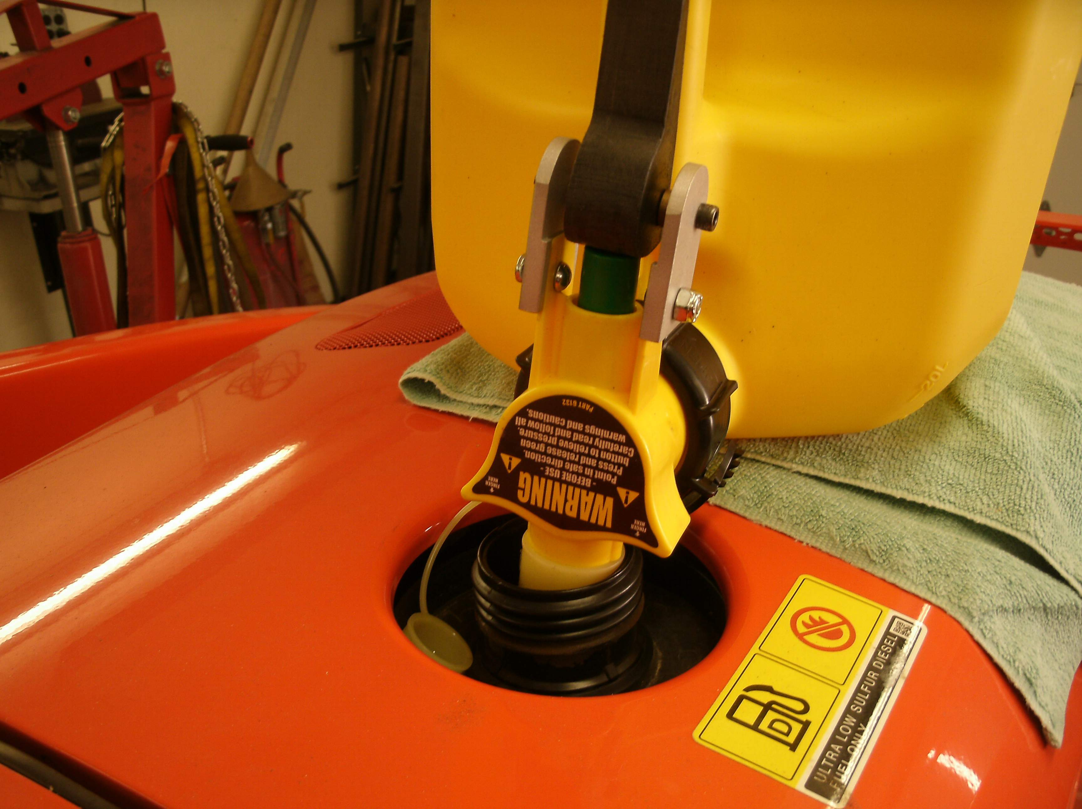

Same thing here. The No-Spill brand are the only ones that work decently at all. They do tend to airlock at the start, but a shake or a couple pokes at the valve fix that as you note. The other thing I did was drill a 3/16" hole through the yellow plastic guard around the thumb button so that I can push the button in, slide a drill bit through, and it holds the valve open. Kills your thumb to hold that for a full 5 gal. Mind you, I only use that when i know it will take the full can as i set it on the hood and let it rip... I have 2 diesel cans and notice that one of them definitely empties faster than the other. Not sure what the difference is, but since I just let them run on their own it isn't a big headache. (Yes i stay nearby just in case...but I can do some other things while it is dumping diesel.)
I agree that the button kills your thumb. I made a cam lever for mine. (Sorry for the large pictures, I was new at posting pictures when I did this)
Good point on having to lift it up on the hood. If I'm lucky to live long enough, there may come a day that I can't do it.
