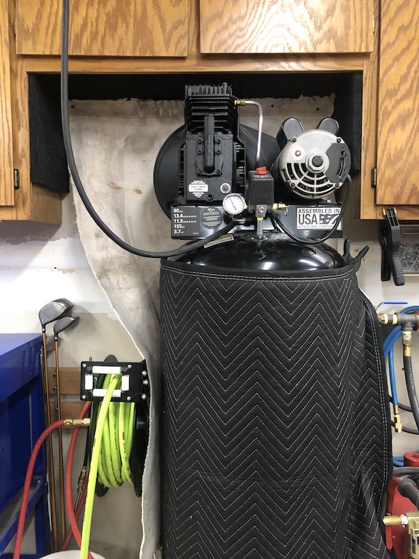

Well my little redneck experiment didn't yield much but I dropped the sound a bit by adding some sound proofing material on the adjacent cabinet sides and 'roof' and a wool throw rug hung on the back (drywall) wall. Also wrapped a HF moving blanket around the tank.
And the results...
Noise (pretty much against wall w/o any insulation)
88dB @3ft
85dB @6ft
Noise (pretty much against wall w/ some back and side insulation along with wrapping the tank with HF moving blanket)
87dB @3ft
84dB @6ft
Does seem just a little muted and not as high pitched (a little easier on the ears). Didn't cost me much. Not as quiet as pulling away from the wall but a duller sound. It's better.

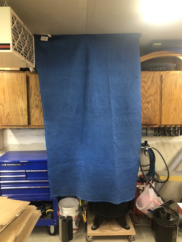

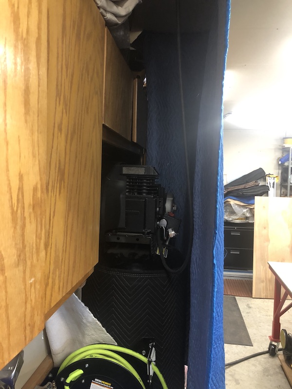

Tacked up a cheap HF moving blanket to serve as a curtain so now enclosed on all but one side left open for air/ventilation. A face on view and a view 'behind the curtain'.
Noise from front (w/ some back and side insulation along with wrapping the tank with HF moving blanket)
87dB @3ft
84dB @6ft
Noise from front (w/ added hanging blanket partially enclosed)
84dB @3ft
82dB @6ft
Some definite muffling going on. The frequency seems a less piercing as well. Still louder than desired but this is encouraging. Now I am on a pursuit for a heavier/thicker blanket that could be a short term solution. It isn't ideal from an ergonomics standpoint though. I can't easily see my on/off and pressure gauges and it is kinda in the way of things.
