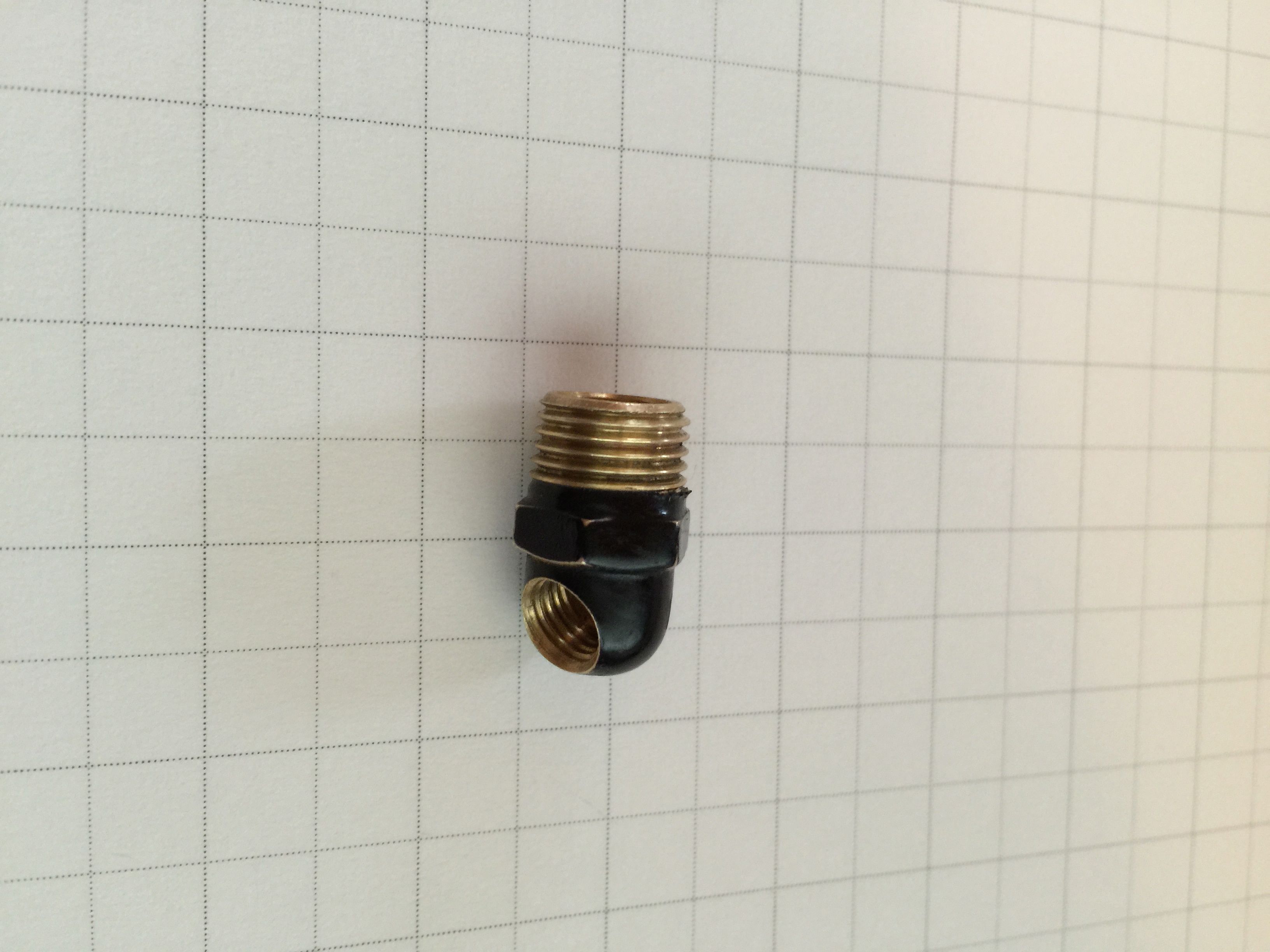

Has anyone done enough research to find out what size and thread pitch Mahindra uses for their grease fittings? I have a 4530 and the nipple portion is gone on the front zerk on the front axle pivot. It measures .375" outside thread diameter and 28 tpi on a thread pitch gage. Threading is straight, not tapered. 3/8"-28 is apparently used in some places, but I can find no US source. I have called my dealer, Mahindra parts in Houston, and several other local Mahindra dealers and no one knows what thread they are, and no dealers stock them. All can special order for a $2 part. If I never expected to need another zerk for this tractor I would not bother, but there are a lot of grease fittings on these tractors and they are not all the same. Here is a picture of the damaged fitting.

After spending most of Friday afternoon on the phone with Mahindra in Houston, I am a little farther along. I sent them a picture of my fitting and it's measurements, part#, etc. They pulled one from their inventory and sent a pic back to me. It is the same, and I my dealer has ordered the part for me. Mahindra did not know what thread pattern it is, but has promised to find out. I found at least 7 different part numbers for grease fittings in the parts breakdown, most of them are metric, a couple have no thread ID in descriptions. I have asked Mahindra to provide accurate thread sizes for all the grease fittings for my model tractor. Or at least a kit with all the correct ones with part numbers. The one I need now is over $4 from Mahindra, which is approaching the Deere pricing model. If I am successful, I will share here.

Are you sure it isnt 27tpi? a common 1/8NPT is pretty close to 3/8" diameter and sometimes hard to see the taper.
Other than that, perhaps the upper portion is common? Usually when I break one like that I'll just grab a 90 or 45 degree fitting and swap the upper portion.
Nothing metric is even close to .375. 9mm is too small and 10mm is too big.

I have an KIOTI NX4510 and while greasing the front end loader fittings, one came out and low and behold, the threads where rounded off. Dealer has no info on thread size, I have a thread guage, 27 tpi taper. I believe it is a standard 1/8-27 taper pipe thread. Having difficulty finding the right tap. Will do some more hunting tomorrow. Wish the good hardware stores still existed!

28 tpi can be 1/8" BSPT or 1/8"BSPP. Kioti is fond of 1/8"BSPT and I also have them under a Hyundai (industrial) part number.

Just to conclude my above contribution, the zirk fitting thread is a standard 1/8 pipe thread- taper -27 threads per inch. While I was at it, I checked the rest of the zirk fittings and glad I did as most all needed snugging up. Hope this helps others who may have inquiring minds.
