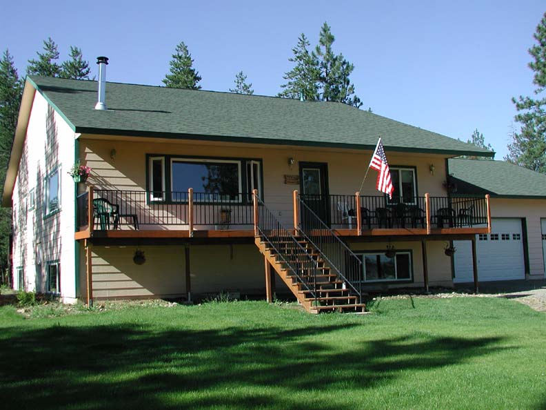

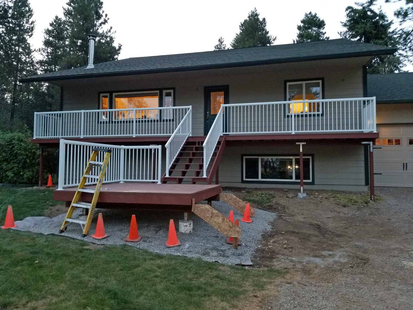

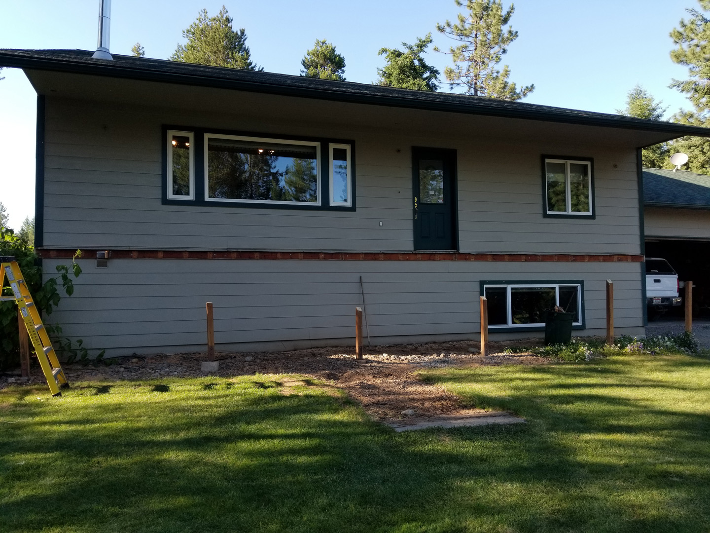

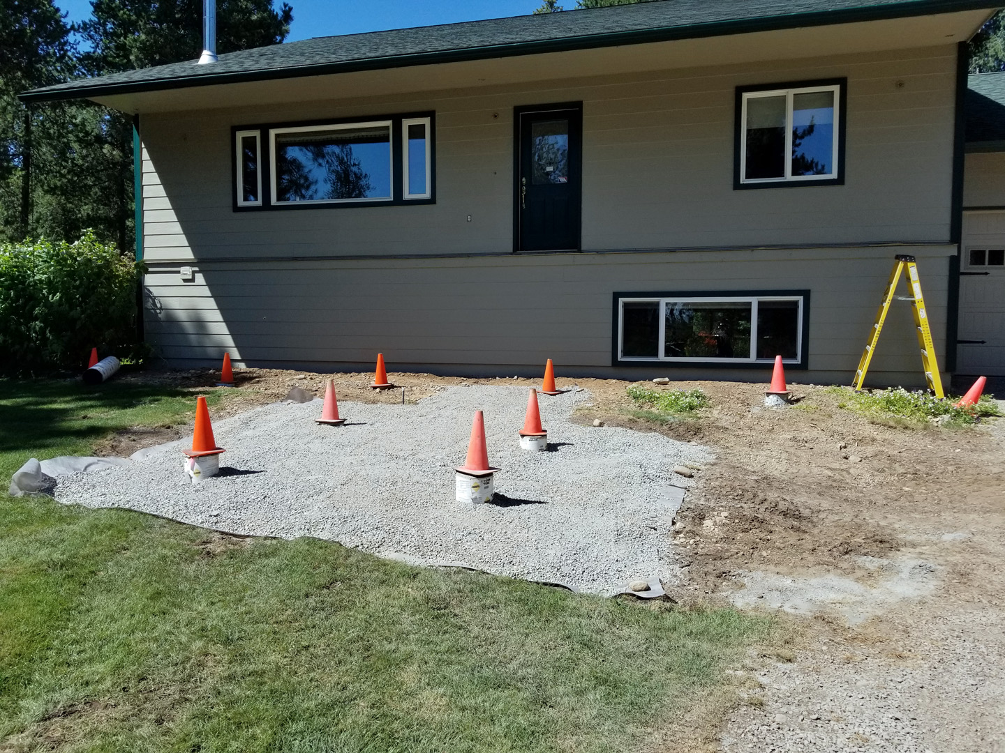

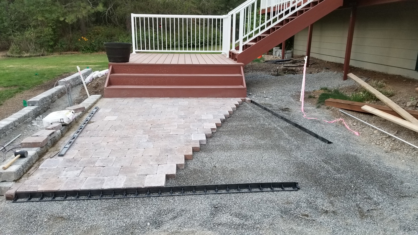

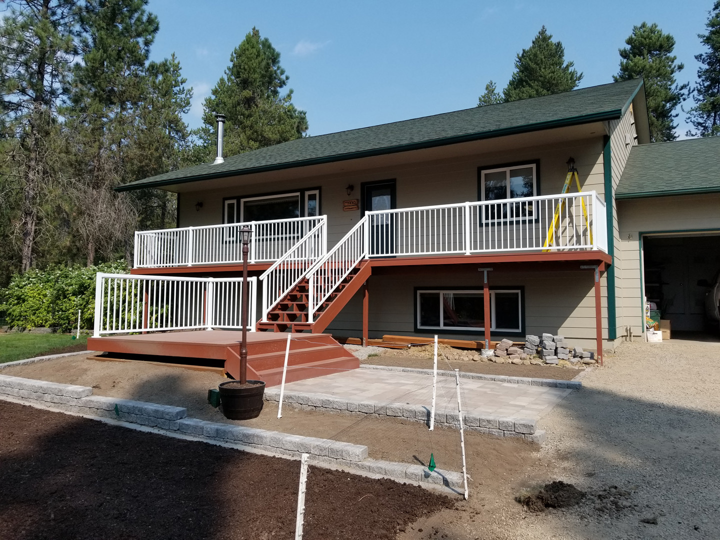

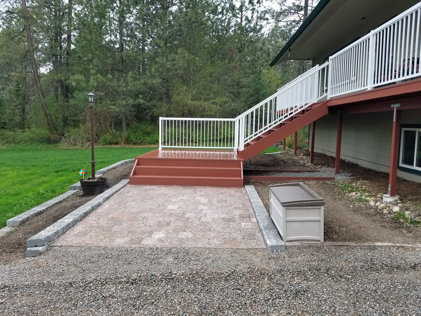

Last fall we replaced our old front cedar deck with aluminum decking supplied thru a company called Nexan (next deck). after 19 years of constant upkeep i decided to take a chain saw to the old deck. house&flag.jpg

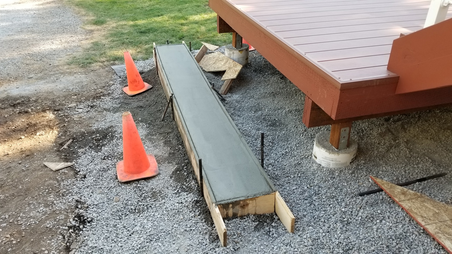

most of the old caissons were still good, but i did replace 2 and added a front landing fd 1.jpg fd 2.jpg fd3.jpg fd4.jpg fd6.jpg fd7.jpg fd8.jpg fp9.jpg fd10.jpg. we will be landscaping it this spring.
We even replaced the old rusting handrail system with aluminum no upkeep handrail system

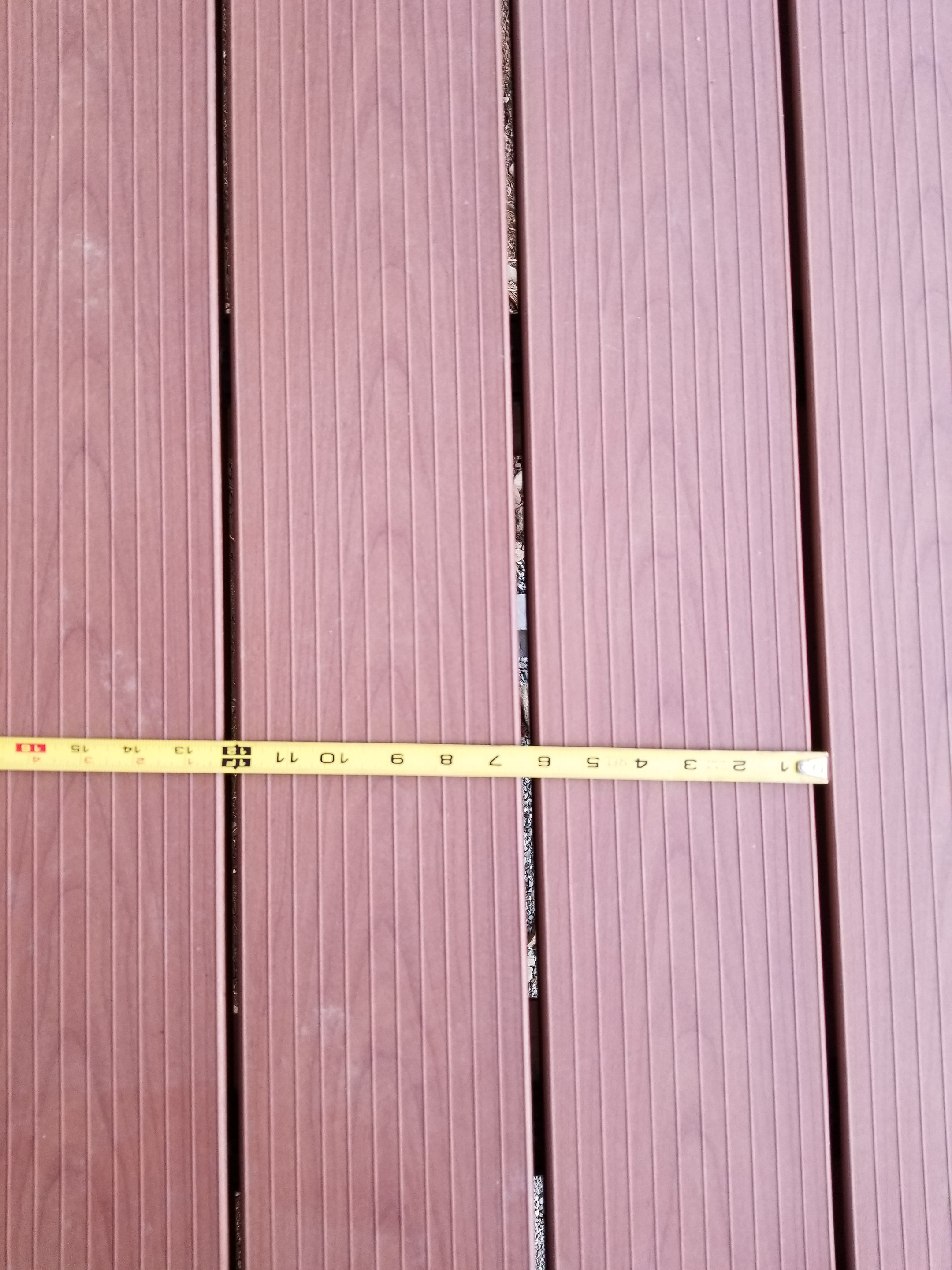

Also noticed two types of deck material is available... one with a "Gap" and one that is water tight that interlocks.
At first I went to the gap style but then I got to thinking it might collect the duff in the gap from the Fir Forest as the deck is deep in the forest.
The "Gap" deck material looks super easy to change out if damaged.
The water tight interlocking material might require taking out up to all the the material to replace one length as each interlocks with the next.

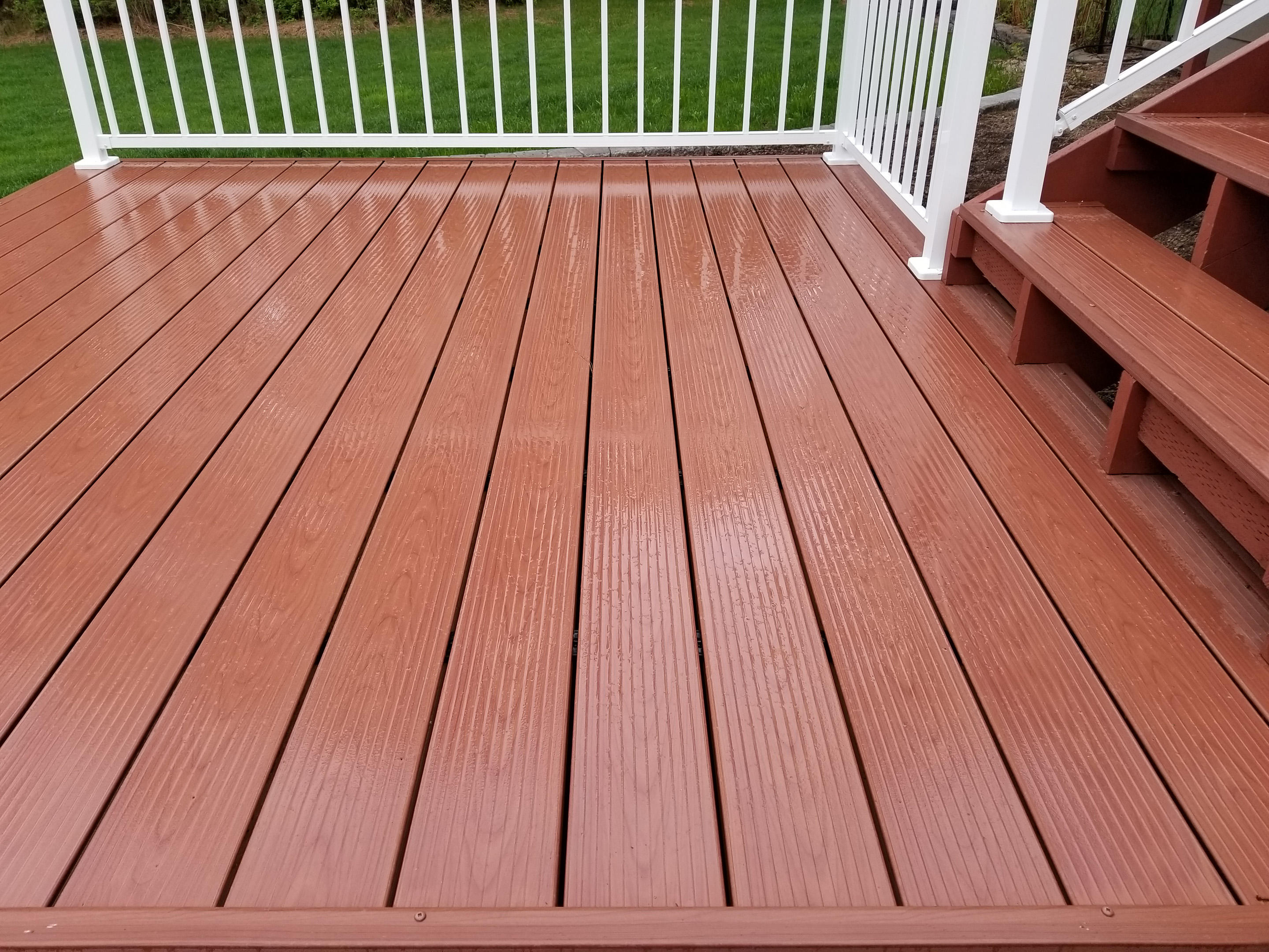

i bought the gap type, as the other is mostly used for dock installations. We have snow, but i dont have any shedding roof snow as my roof is asphalt.
the deck is extremely strong, and stays cool to the touch throughout summer. the composite decks can fry eggs in the summer.
there will be no delaminating here.
one thing i see alot of here is delaminating composite decks if a person allows pine needles to sit under a load of snow all winter.
i replaced all the framing but didnt want to use aluminum or steel framing members because i was warned that this would allow for a noisy deck when people walk on it. This deck is fairly quite .... compares to the noise from the previous deck.
We dont see the rain that you guys do, so im not sure of best solution for framing. i used pressure treated wood and posts for most part. All the handrails are from Regal, and there all powder coated aluminum.

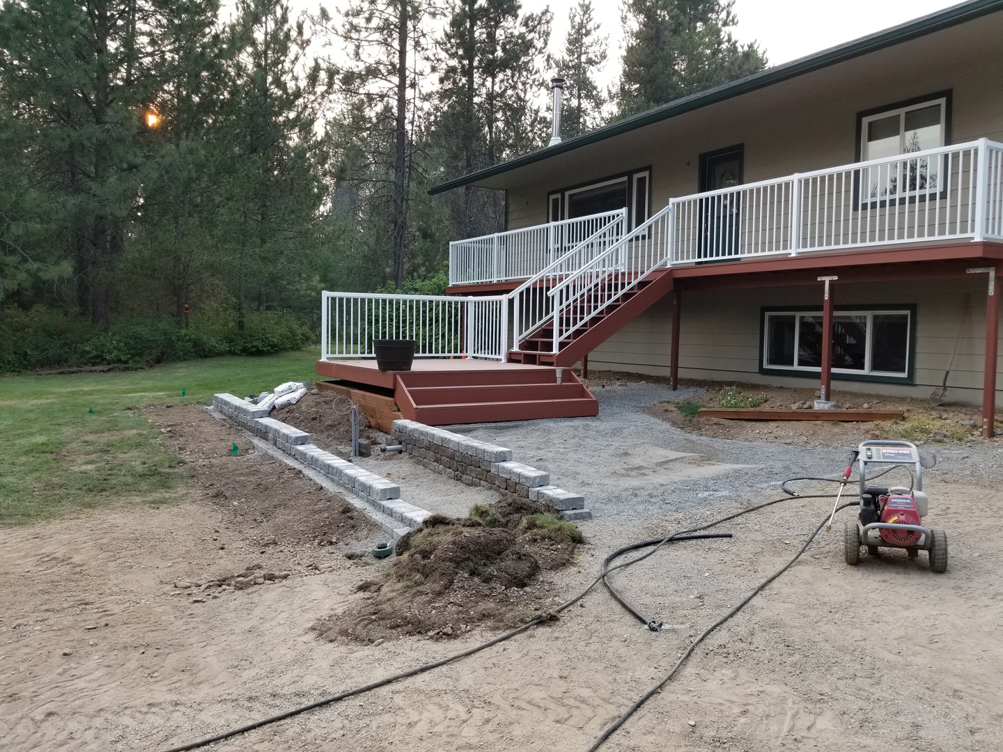

how large is your deck? $80K seems like someone is trying to retire on you. i purchased enuf for a 6x45 front deck and a 6x45 rear deck plus all steps and the lower deck which is aprox 10x12 foot and chose the wood grain color and i only paid about $9,000 for materials. i cant recall what i paid for the deck framing materials, but it was probably around $4,000 total including concrete. The alum handrail system ran aprox $3,000 as i recall. the wife and I installed the handrails in aprox 4 hours. Regal makes a sweet system. Also just to note, the deck is rigged to prevent slipping, and the surface is rough. this deck can be used on Docks, so its not slippery. i walked on it all winter and never slipped. The only downfall was you cant use a shovel to move snow, as it could scratch the finish. And dont use salt either.
As it turned out, i just used a plastic snow shovel to eliminate all but 1-2 " of snow, then used a push broom to get the rest. worked sweet.

Is the gap large enough to allow for cleaning of small fir tree needles?... Only ask because I don't want to set myself up for lots of maintenance on a low maintenance deck... every visit I would spend a day just cleaning out he slots of the between the existing wood planks... it does get windy and with tall trees the needles travel.

heres a few close up pics showing gaps. i dont have any trees near mine so i cant tell you about needle cleanup.fd12.jpg20180505_173719.jpg
i can assure you that this deck went together in the same amount of time as a wood deck would. there are no face screws in deck, only in the trim. it comes with spacers that screw into joists. Nextdeck will send you a free sample package showing all parts and colors
