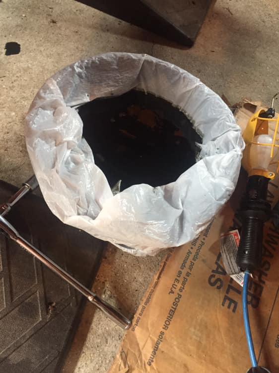

Okay, I'm all set.
I just drained the oil. " Photo "

Here's a photo of the Oil Drain... I only have 47 hours on the Tractor. Man, this looks like Mud. It looked pretty clean on the stick though.
Is this normal for the first Oil Change?
I'm going to run it for just a few hours and swap out the oil and filter again..

Used diesel oil is going to look real bad compared to oil from a gas motor;it's o.k. just replace on normal schedule.
****, it is Jet Black.
On the Stick it was only slightly colored tan.
BTW, I only have 47 hours on the Tractor, but, she's coming up on three years since I took delivery.
I'm guessing age of the oil might be playing a factor here as well.

This is why I laugh when I see all the people using shop vacs so they don't have to drain the trans/hydro fluid. At 50 hours mine looked clear on the stick, but was black like old motor oil when I drained it. Doesn't get nearly as bad looking now when I change at close to 200 hours.

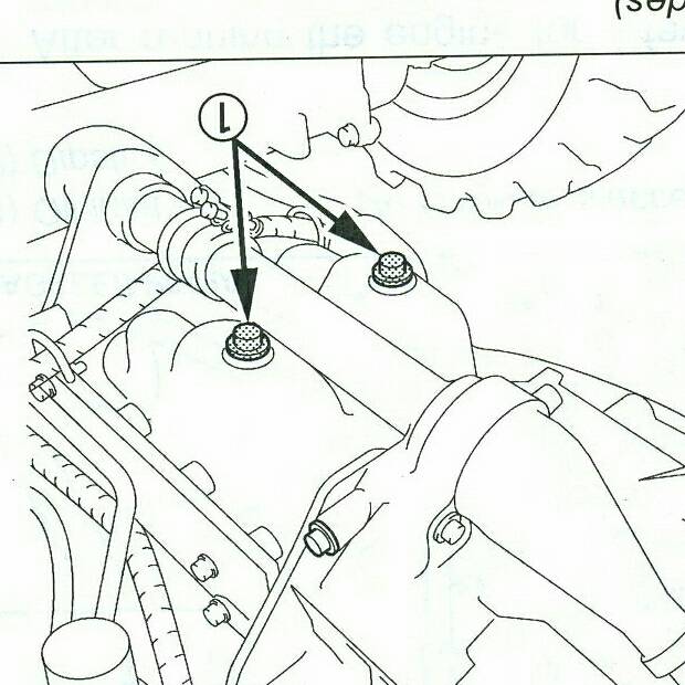

What guy designed this and what was he thinking?View attachment 601287
You know what's funny.....even though that is what is in my manual for this tractor, this model tractor does not have this, LOL. It has a normal single sump engine oil pan.
But many other tractor makes have an oil pan like this. Some are even worse with just a pipe running between them.

The oil gets black in no time..

Like nybirdman stated, that diesel will blacken oil in just a few hours... Jet black in no time. Just change it on the correct schedule.
