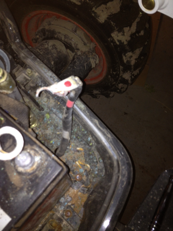

Thanks for the info gents. I will grease the wires and clean the terminals. The new clamps should be here today. Hopefully, I'll be able to remove the old one (pos) and get the new one in place without soldering.
I'll keep an eye out for the battery leaking also. I've got plenty of hills, and mowing around the pond always puts the tractor on an incline.
/ Not the battery
#23
Running great. Got the new clamp on, and cleaned out some debris from under the hydro drive pedal. I'm pretty sure it was just the pos battery clamp. I will say, there is no extra pos wire. Whew. The new one is very tight.

Thanks. FYI, I can see evidence around the the battery of corrosion. It must be leaking. Not sure how long I'm going to stay with it.
If a new battery is 1/4" taller I'll never get that positive terminal hooked up. I need to find a smaller battery. Ha

The top of that battery terminal shows a black, almost epoxy-like corrosion that forms on leaking posts; if you didn't scrape it off to shiny lead where the clamp goes around you'll soon have the same problem. If you do change batteries, I'd think about going to a side post rather than the top post models,if you have clearance on the side. I haven't seen near the leakage/corrosion issues on side posts; I'd be interested in hearing other peoples experiences with them.

Did mine today too... <img src="http://www.tractorbynet.com/forums/files/bobcat-tractors/444405-not-battery-img_20151018_184020-593x800-jpg"/>
Yep, mine was maybe a little worse, but not much. That's the cheapest battery connector I've ever seen.
