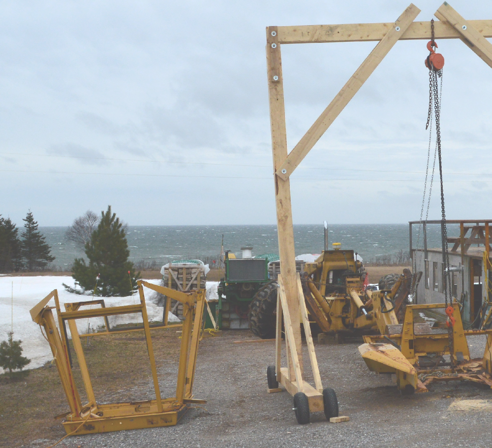

Looking at a CIH-5130 next week, heard some horror stories about shuttle-switches and speed-shift modules. I don't need ANY fancy stuff, can I operate manually without these? I know prices are going through the roof, just redid my Cat-426 cabin April to Sept
then almost roled it in a ravine during shakedown trials:
