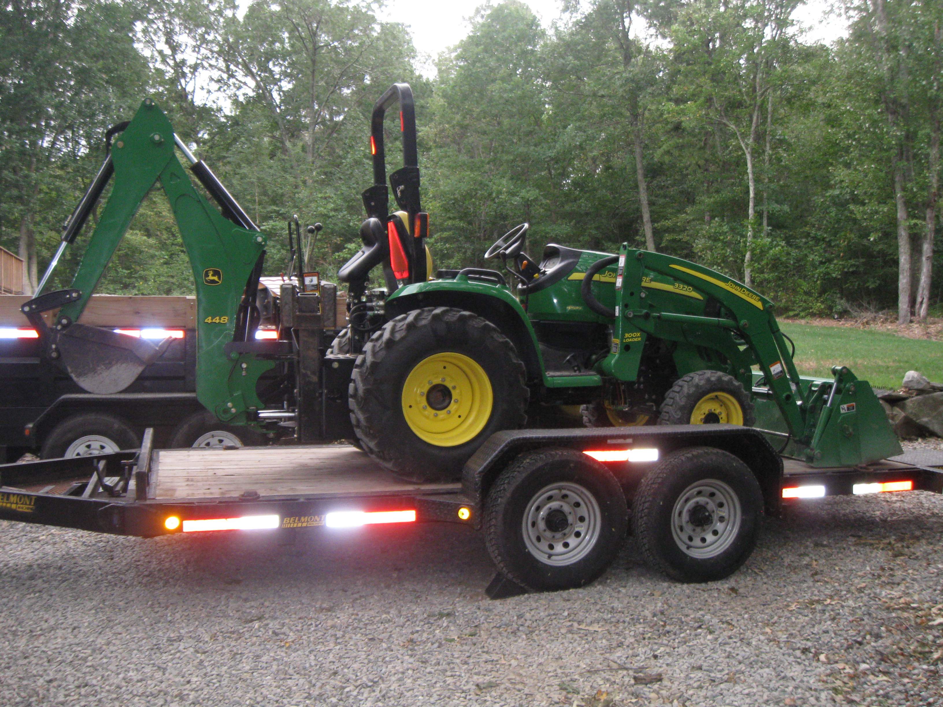

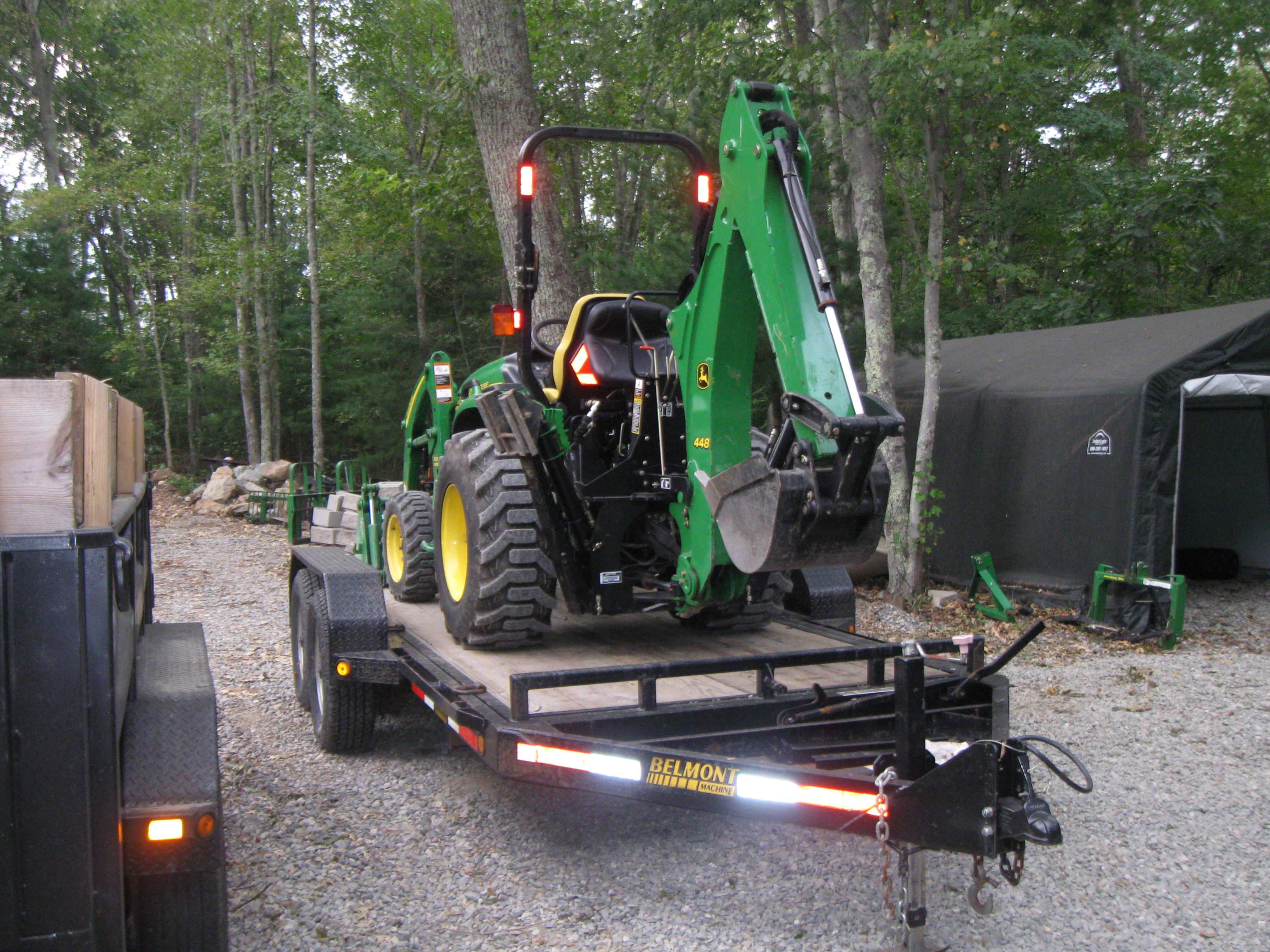

And my final question is will my trailer get the job done? 12k 18' tilt.

Your trailer has the load capacity, certainly. I'd be concerned about overall length. The 110 with hoe is close to 20'. Granted, the hoe is hanging in the air... but, 18'; doesn't leave you with any possibility of hauling additional implements or the possibility that you might be over-limit on tongue weight with no room to back up or re-configure the load.

Your trailer will haul it as well. Might not be able to fit any attachments, but you'll have plenty of capacity
