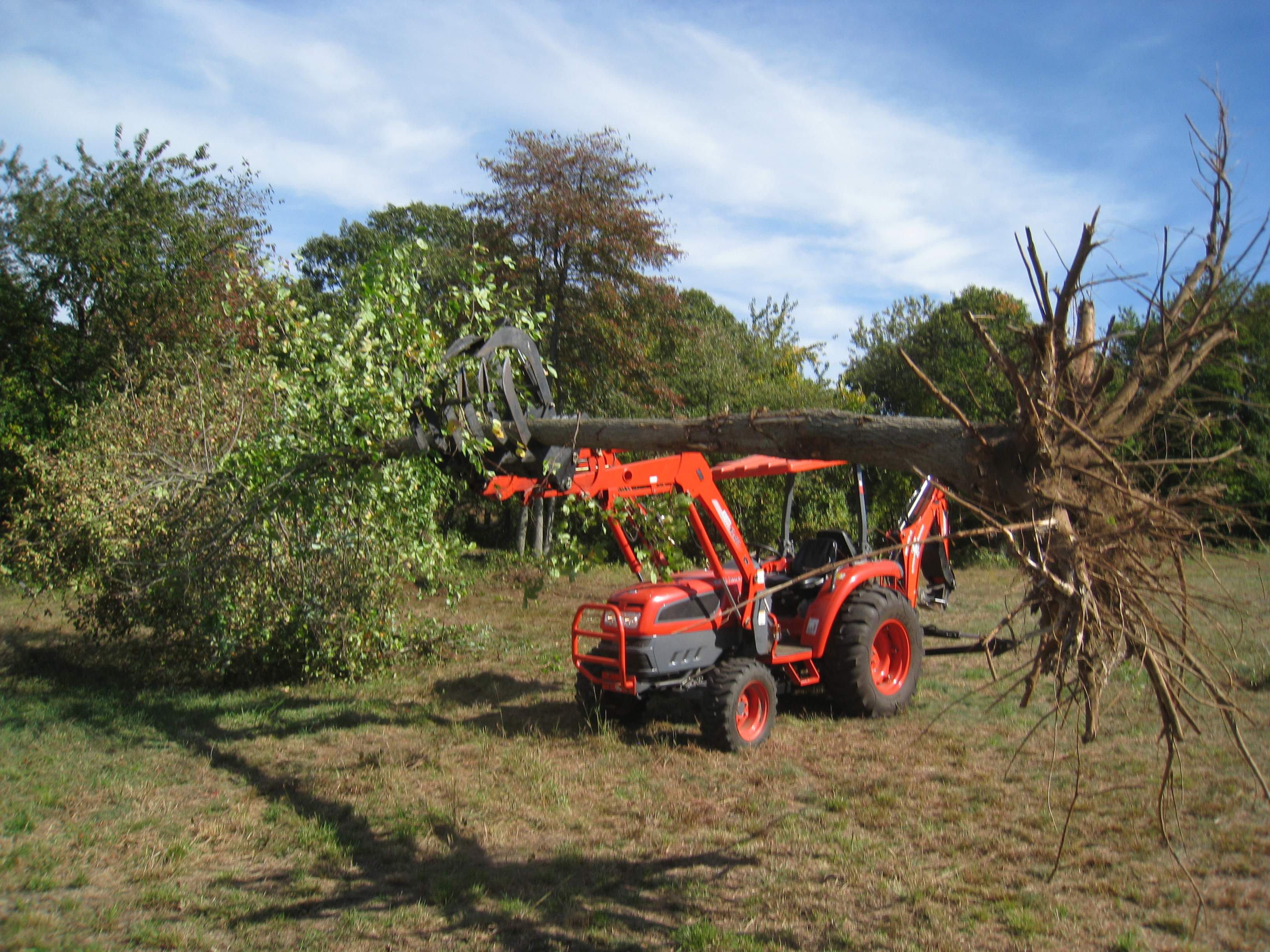

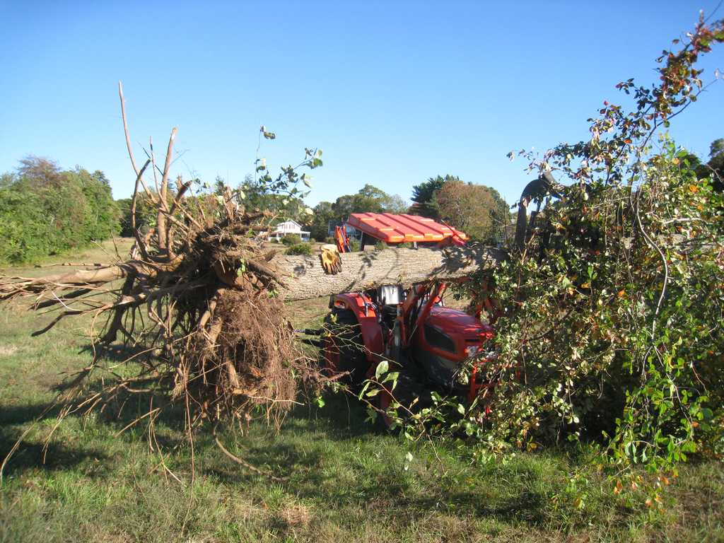

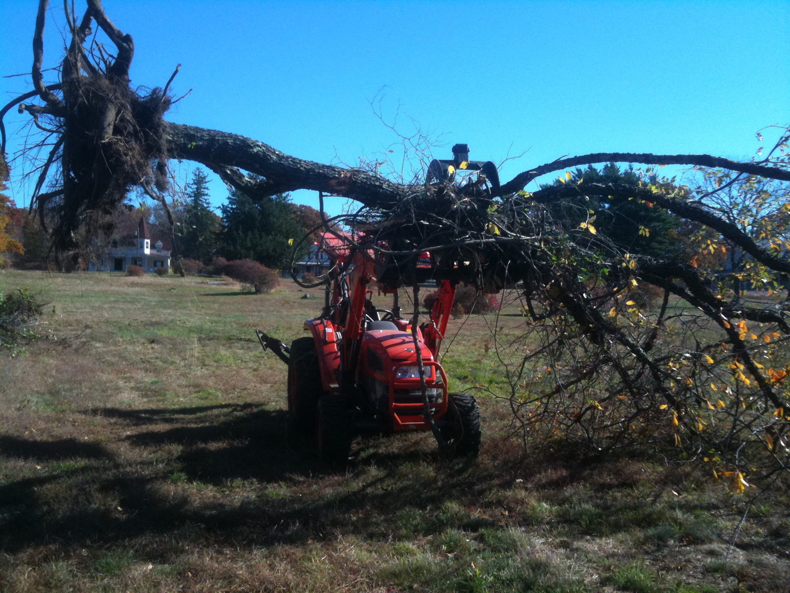

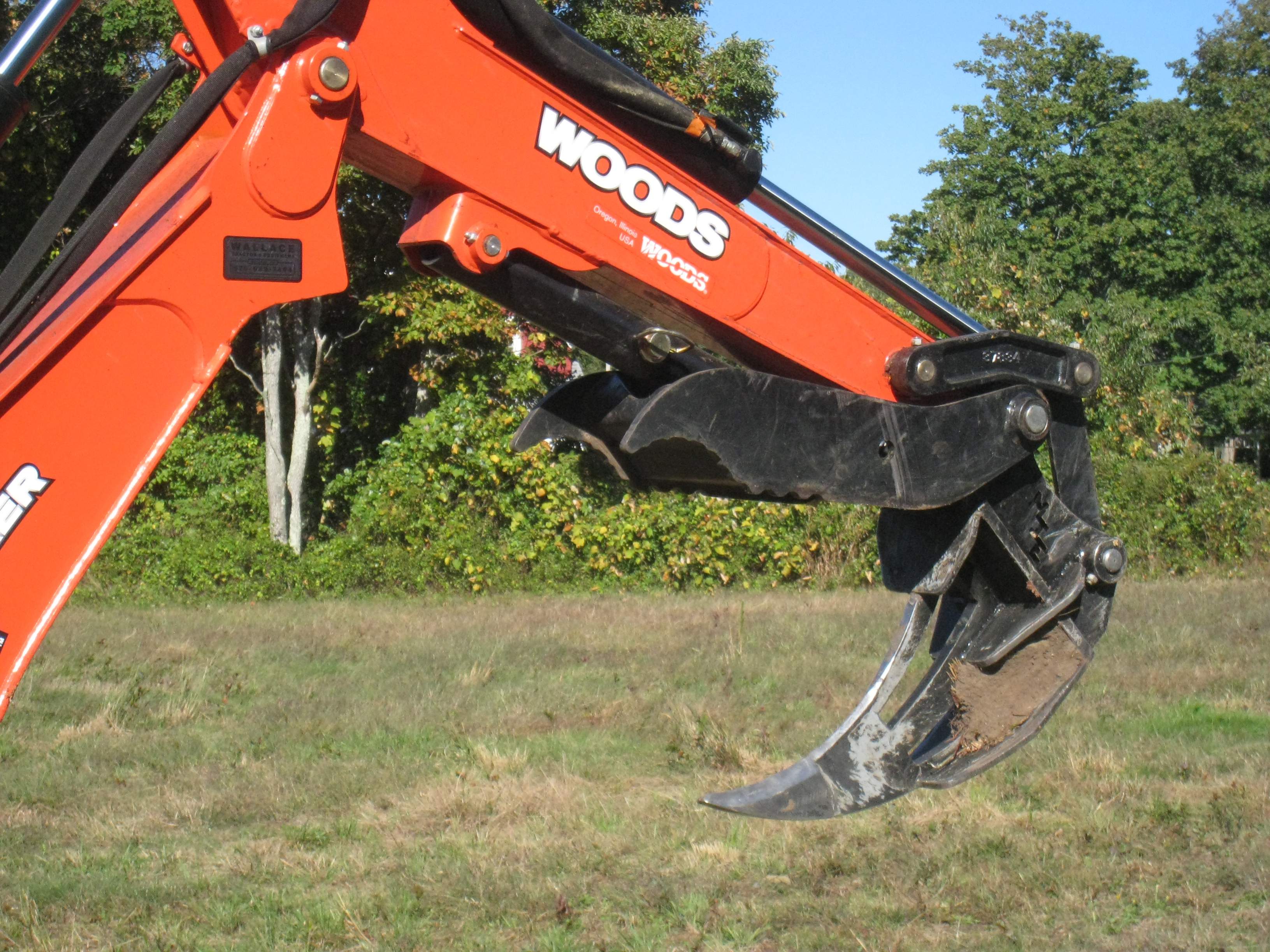

Pushing over trees instead of cutting them down can be very efficient. If you use a chainsaw, you are left with the stump and root ball to deal with and little or no leverage to get them out without a lot of digging.
My favored technique is to mount the BH with ripper and grapple. Use the ripper to tear up roots on both sides and the use the grapple up about 8 feet off the ground to push. Typically the tractor starts to "climb" the tree and that's fine for a foot or so. It usually tilts the tree over a bit. Then back off, reposition and give another little shove. Sometimes move 30 degrees or so and push a different direction. At some point the root ball will start to show it's outline. Then use the grapple to dig into it and curl a bit. Then back to the trunk. Sounds a lot more complicated than it really is. With experience the "tipping point" is easy to recognize and at that point just make sure the root ball isn't going to come up under the tractor while you finish. The whole tree can then be lifted in the grapple if the area is clear or otherwise just grab the root ball from the base and drag it to a clearing where it can be either cut up or carried away. Pretty efficient way of dealing with trees up to about a foot or so in diameter at the base. WAY less work and mess than cutting down the tree and then digging out the stump. Much cleaner too. The hole is about a third the size of what you end up with if you dig the stump out.
(Of course if you spent all your budget on horsepower, you won't have enough to get a BH and ripper.;) )
