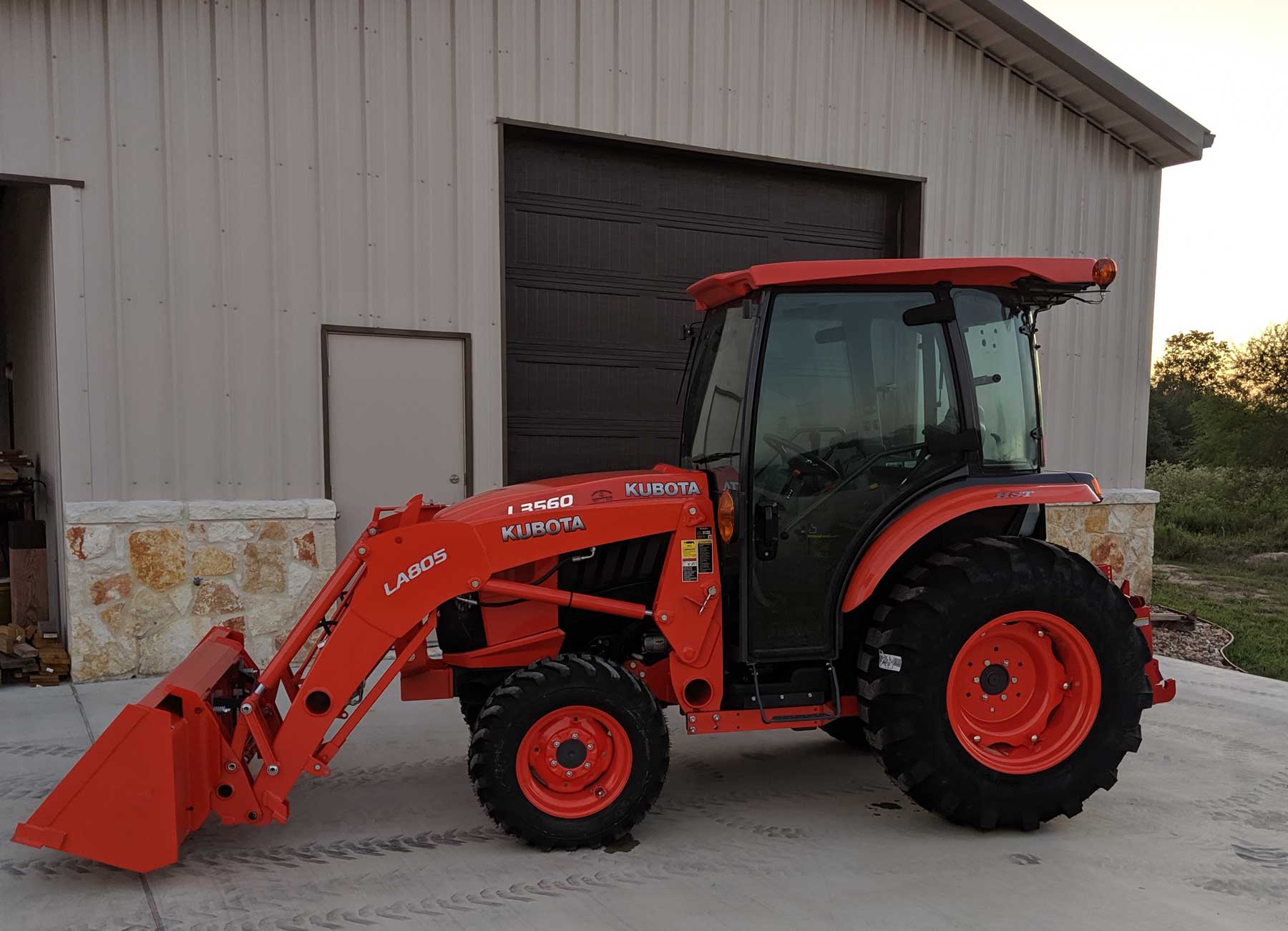

I know this is the Kioti section but since I started the thread with questions about the NX thought should update it. AS mentioned above I thing the NX looks like a great deal but decided to go with the Kubota due to my personal circumstances.
Kioti Dave, you comment about 35 hp is I believe quite accurate in most cases. In my case I do not see it as much of a problem. I am at 120 feet above sea level so basically zero hp loss do to location. Also there is not what I would call a hill in sight. Highest point on my property is 120 feet above sea level and the lowest is 115 feet above sea level. I have been using a John Deere 950 and the new tractor, while only showing 6 hp more, feels much, much stronger and more capable.
With that said here is the new ride.
