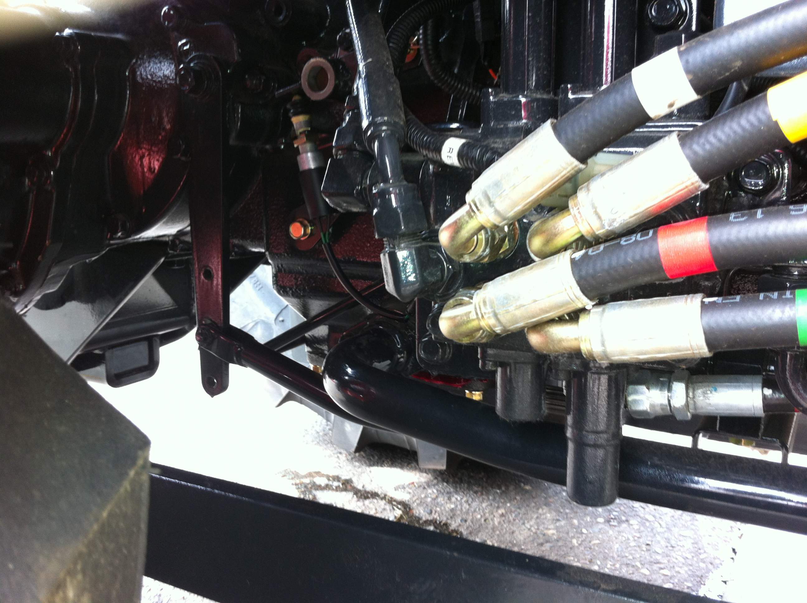

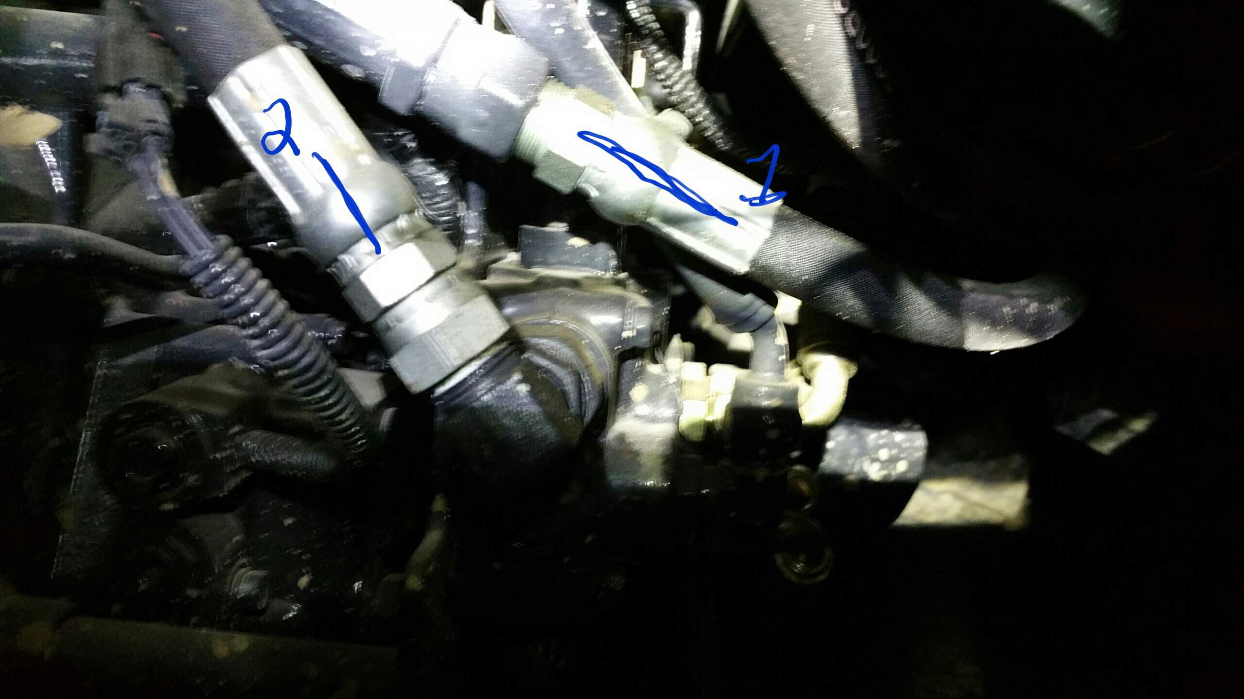

It should be in the #2 position but if you snap a photo of the hose leading to your rear hydraulic remotes (easy to shutterbug), we'll know if they tapped the right line as well because a new line will likely not have the giant banjo fitting or factory paint all over it.
Making an assumption of what I cannot see in your photo, it looks like they tapped into the right line.
For reference, from the factory, it looks like this.

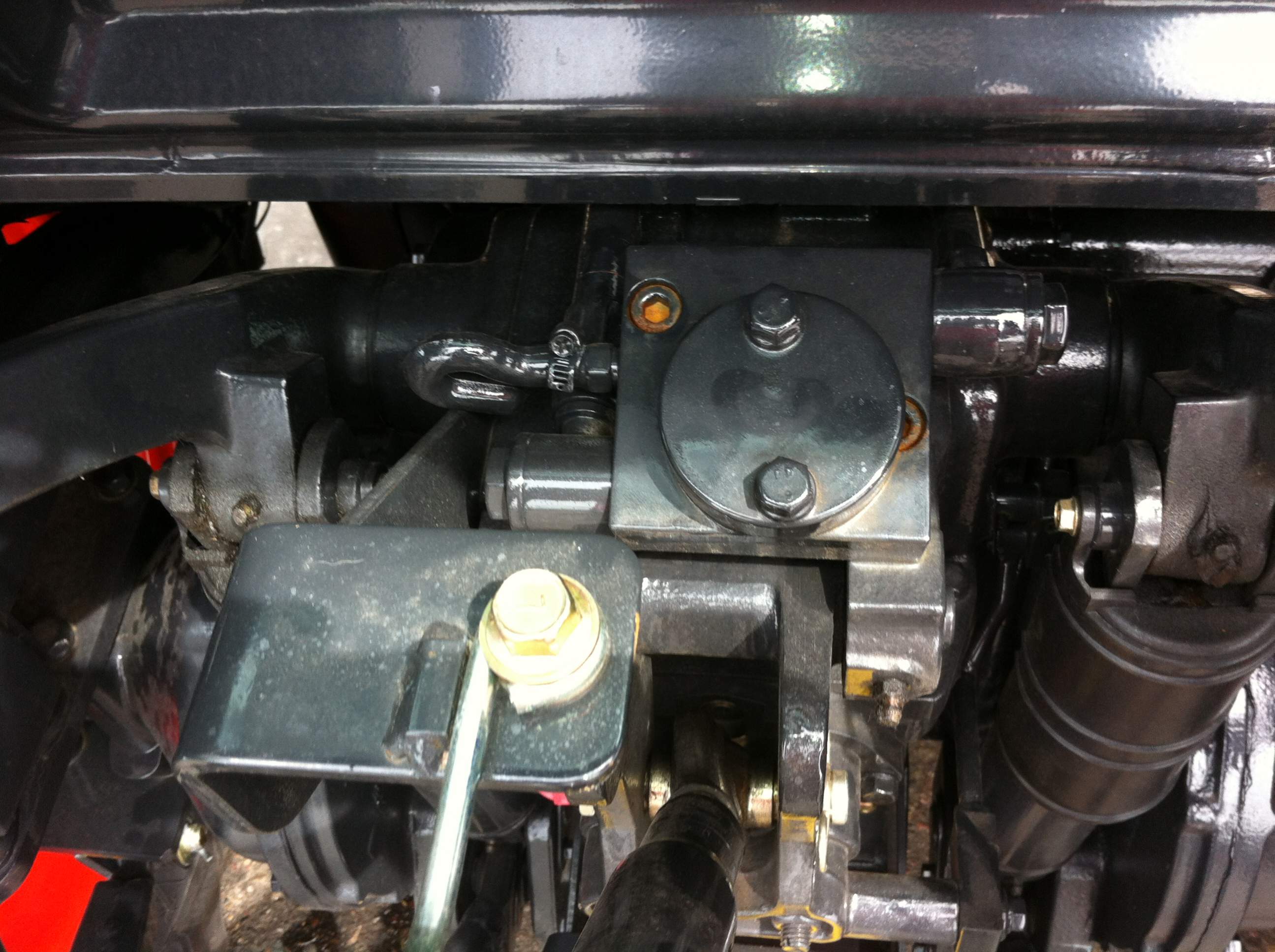

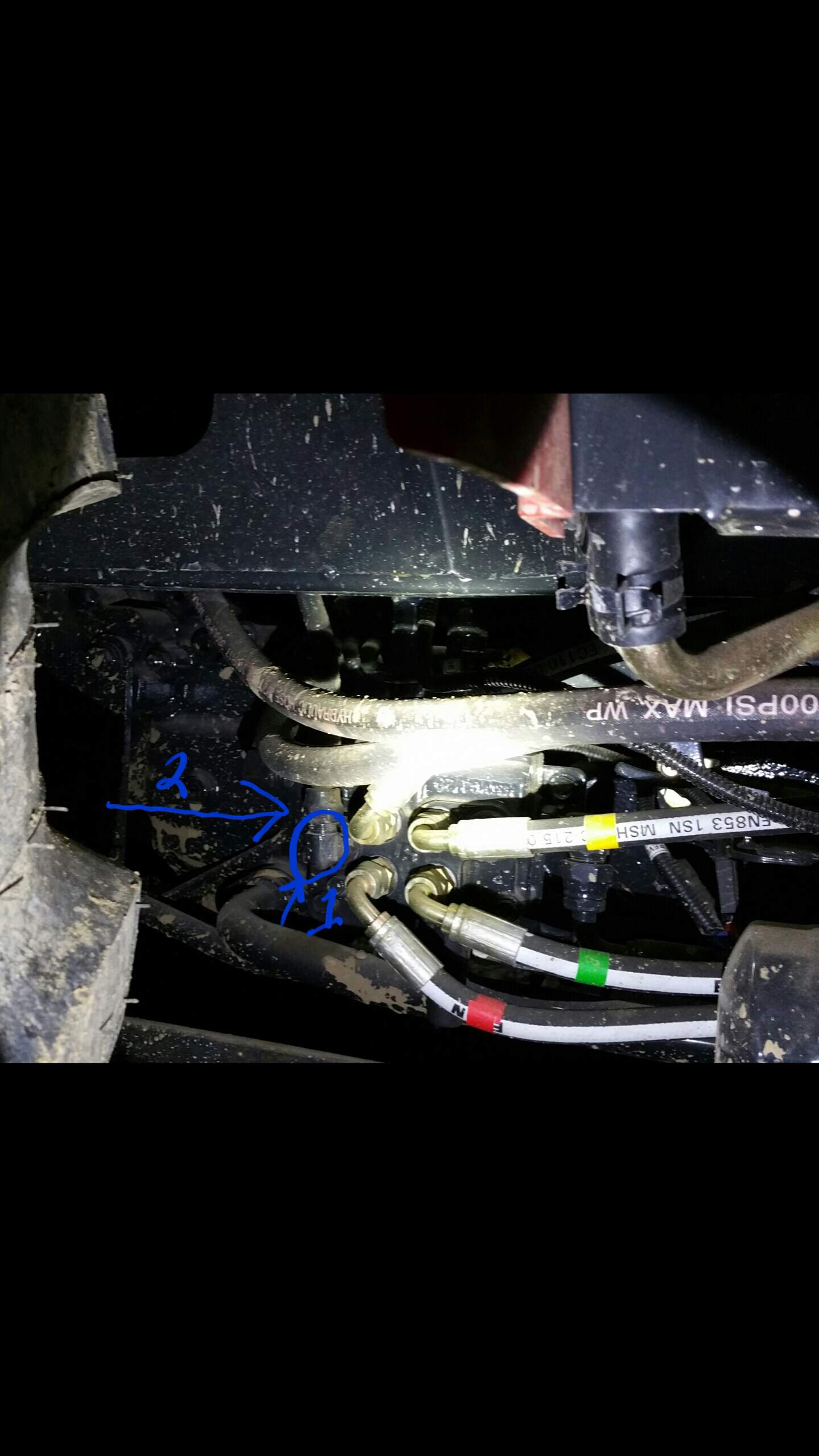

hydraulic plum4.jpg OK, MY BAD!! DIDN'T LOOK CLOSE ENOUGH. OK, THIS IS A PIC OF THE REAR OF THAT BOX, FACING THE REAR OF THE TRACTOR. ONE OF THE LINES GOES INTO THE REAR OF THE BOX, AND THE OTHER LINE I FOLLOWED TO THE REAR HYDRAULIC BOX FOR THE 2 REAR SCVS.... Does this make any more sense?

View attachment 418107 OK, MY BAD!! DIDN'T LOOK CLOSE ENOUGH. OK, THIS IS A PIC OF THE REAR OF THAT BOX, FACING THE REAR OF THE TRACTOR. ONE OF THE LINES GOES INTO THE REAR OF THE BOX, AND THE OTHER LINE I FOLLOWED TO THE REAR HYDRAULIC BOX FOR THE 2 REAR SCVS.... Does this make any more sense?
What you're calling the #2 line must go to the P port on the silver subplate. The T port on the silver subplate must go back to your three point and rear remotes.
Anyway, they tapped into the right hose (which would have been a real blunder but could happen if they tapped into hose #1). Maybe it is just like the tech says: a restriction in the HST filter.

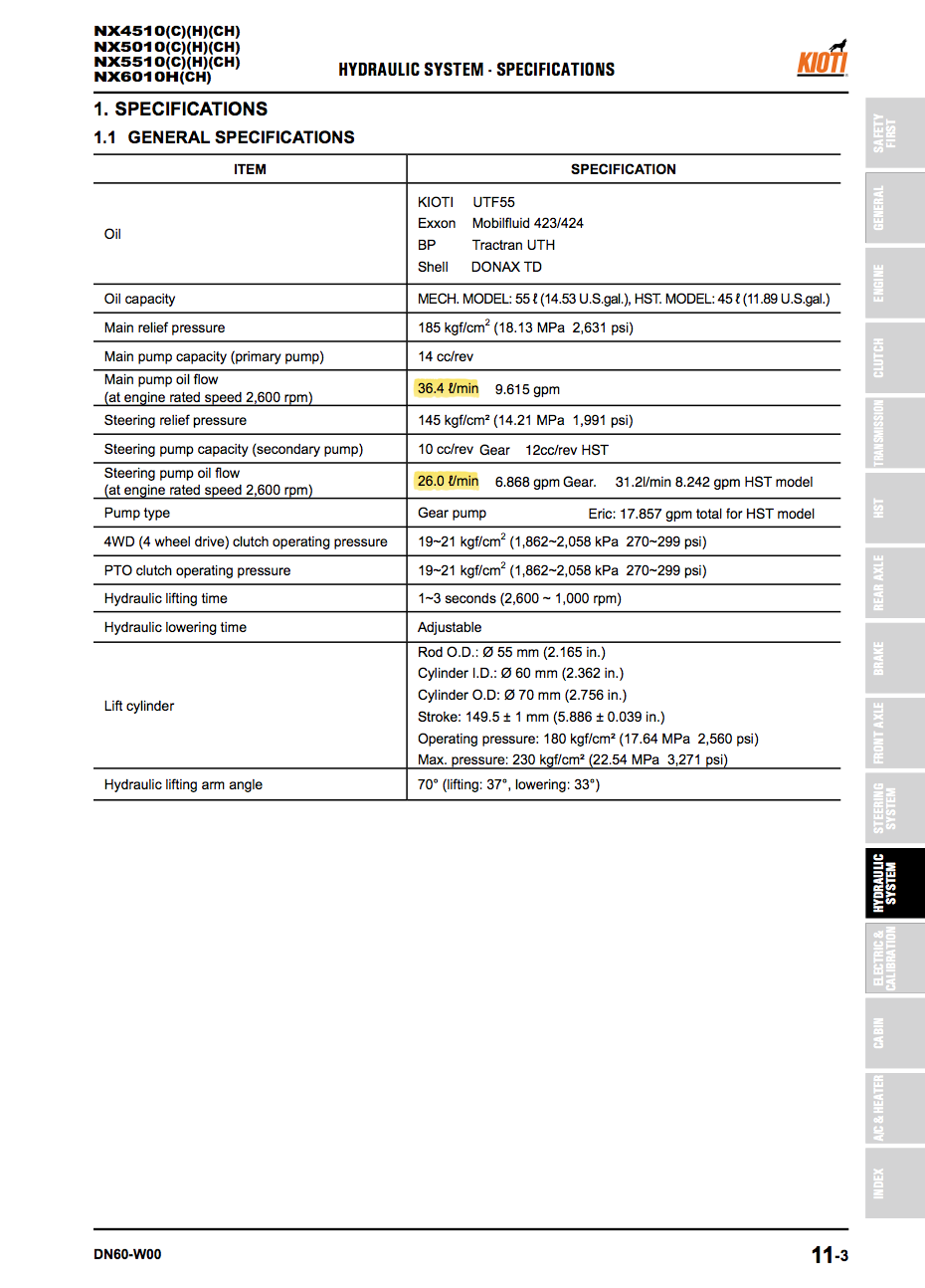

While we are talking capacities, I took the liberty to look up in the manual, do the conversion, and record my notes so that we have a definitive capacity.
The 9.9 gpm number I used before is a little too high. The HST models secondary pump flows slightly more than the gear 12cc/rev rather than 10cc/rev presumably to power the HST. Not a whole lot of parasitic loss whatsoever on the pump side.
Anyway, here is a screenshot of my manual.
