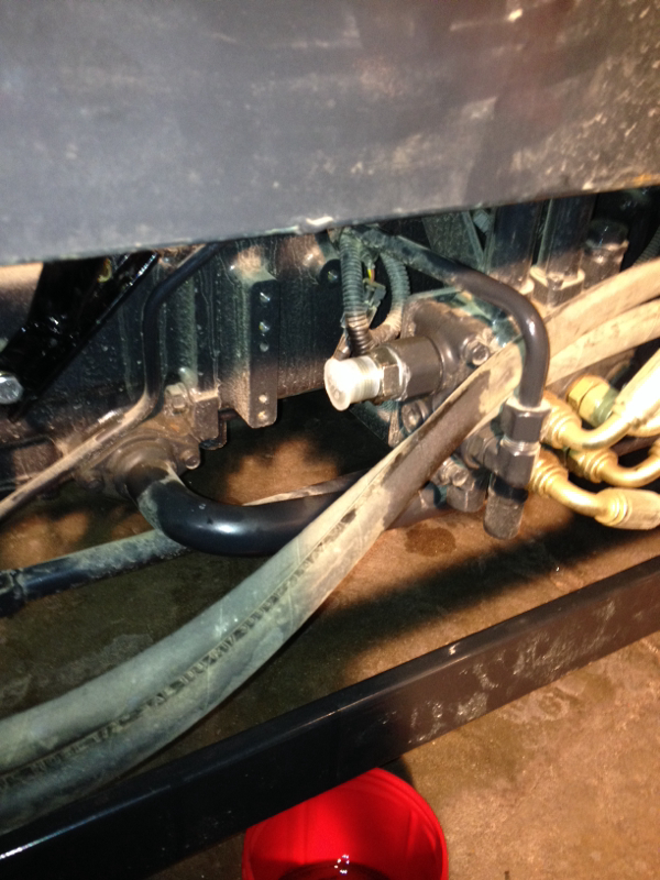

Not a very good pic , but this is the port on the joystick valve that the third function should be plumbed from.
417943d1427167148-nx6010-hydro-transmission-issues-image-3545451995-jpg
Joe, Country has a good photo here of our Joystick's power beyond port. It is the rear-facing port that has the plastic dust cap on it in Country's photo. Stock, there is a hose that is attached to this port that runs straight back to the base of the rear remote valves. The stock hose is painted factory Kioti charcoal. Your third function should have been plumbed in-between the power beyond port shone in Country's photo and the three point in back. As such, you should see a not-Kioti-painted hose plumbed into the power beyond port on the joystick's control valve Country's photo.

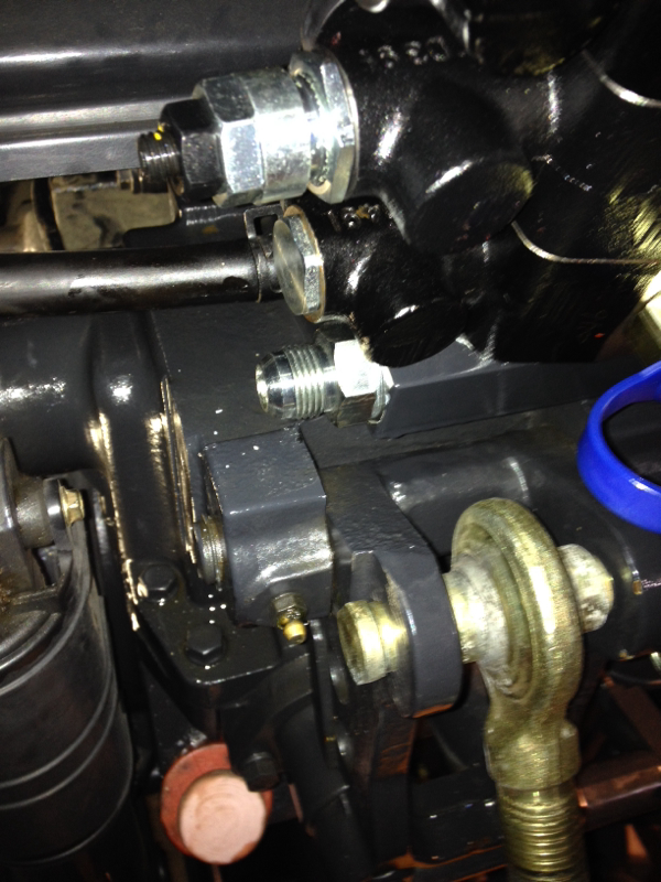

You know, all the NX tractors I looked at all had a hard line with banjo fittings on each end instead of a hose like yours had, I wonder why the difference. I looked a a couple of hydro 6010 units also with a hard line.
Here is the rear connection port, originally a line or hose would go from the port in my first pic to this port.
If I recall (it's been a while since I read it) the hardline was an early change in the manufacturing which is noted in the different parts in the parts book. My tractor had a soft line with a NPTP fitting on the power beyond end and that goofy, giant banjo on the other end. Thankfully, BSPP adaptor threaded right in on the 3PT valve body, but it was one of the problems I had to work out.
Country's action photo of the curiously expensive Parker zink-coated adapter. Anyway, Joe, if your dealer tapped the right line for your 3rd function, on the base of your rear mounted SCVs, you will not see the factory, painted hose. Instead of the factory hose you should see a 90 degree elbow screwed into an adaptor just like what Country posted.

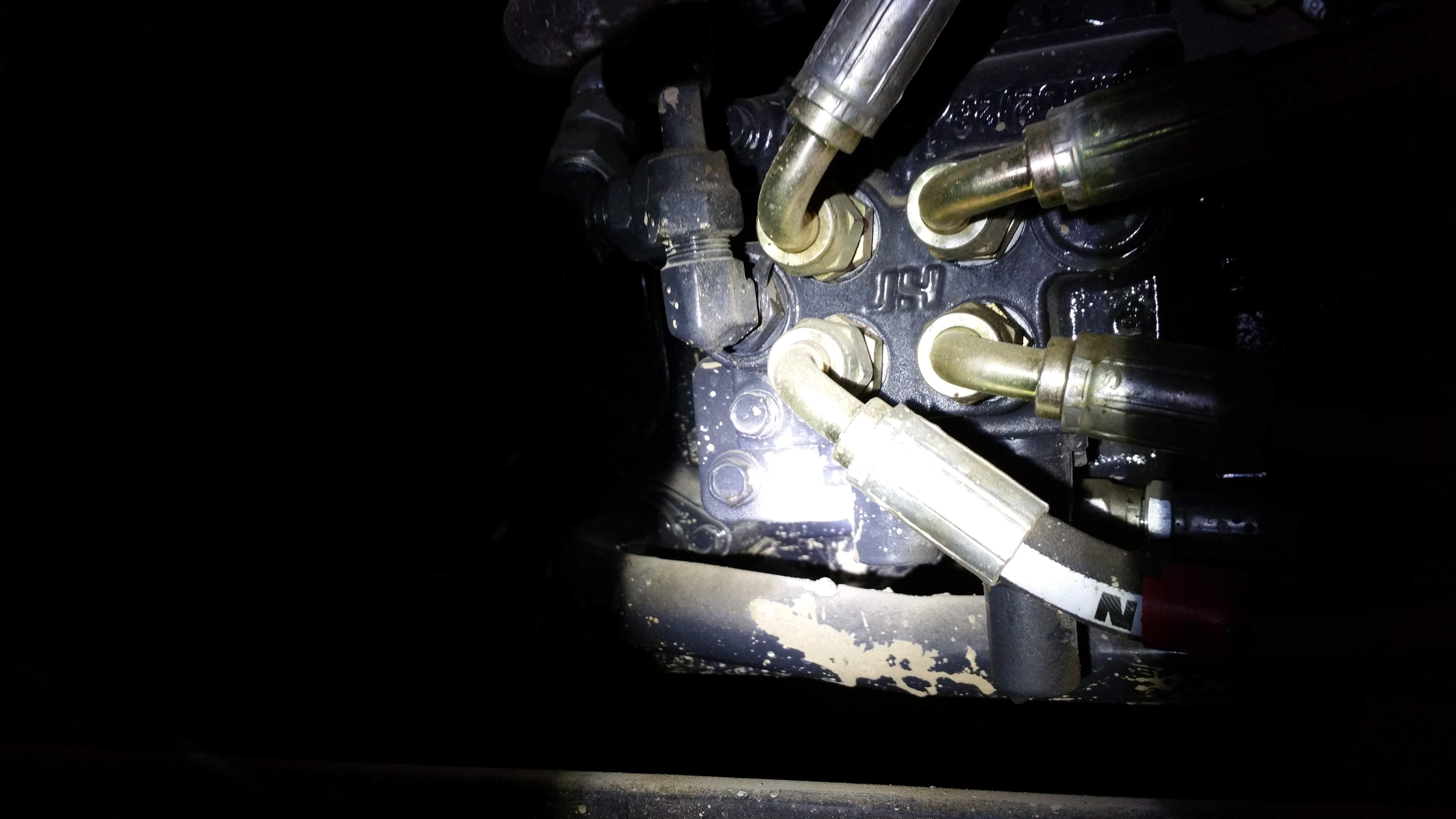

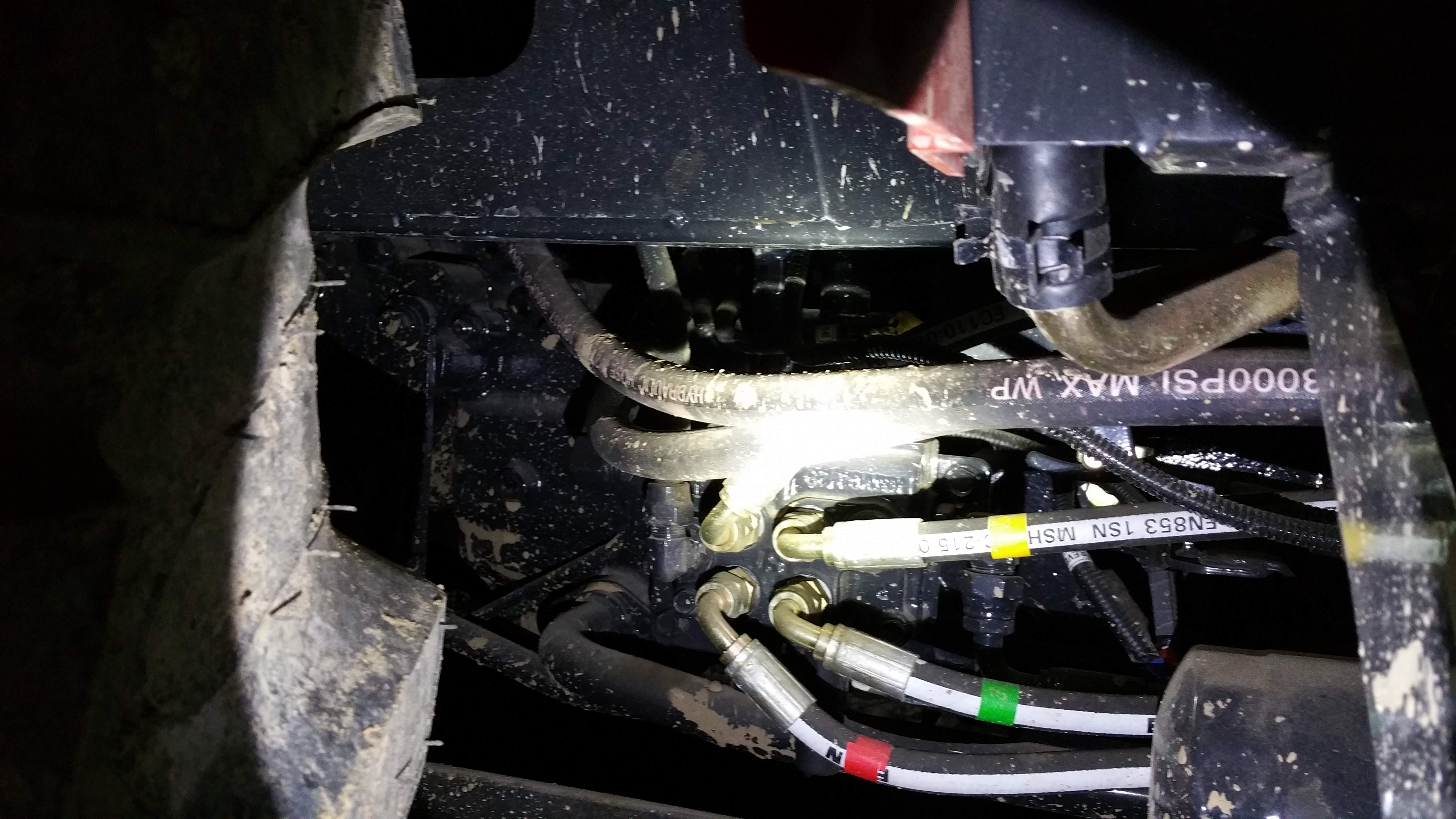

Yeah, I know it was a weak example, but if it were much more sloppy and uphill it could have been :) I was not running the pto or course, so I was at normal rpm, somewhere between 1500 - 2000. Going to try and take a video now of the valve they installed.

OK, from the 3rd function valve; the front hoses go directly to the 3rd function itself at the end of the loader.
The left/rear lines go into this box by the transmission. One line is in the pic as the lower left line, which is black. The other line goes into the back of that box.
