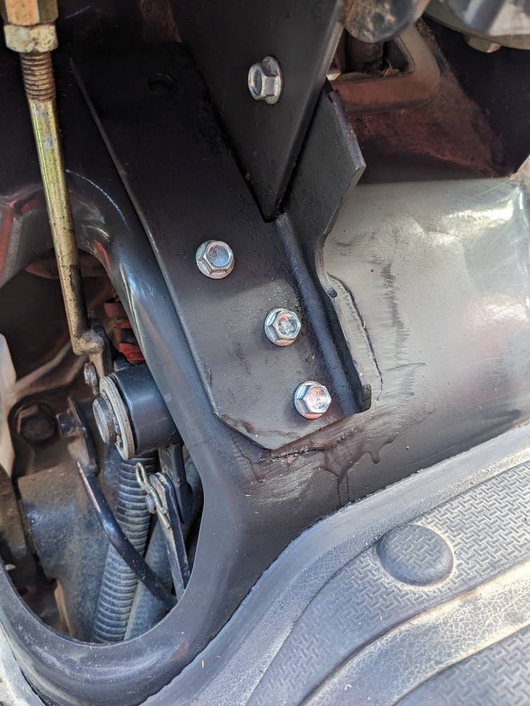

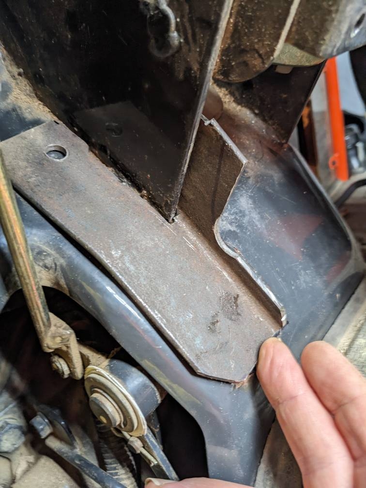

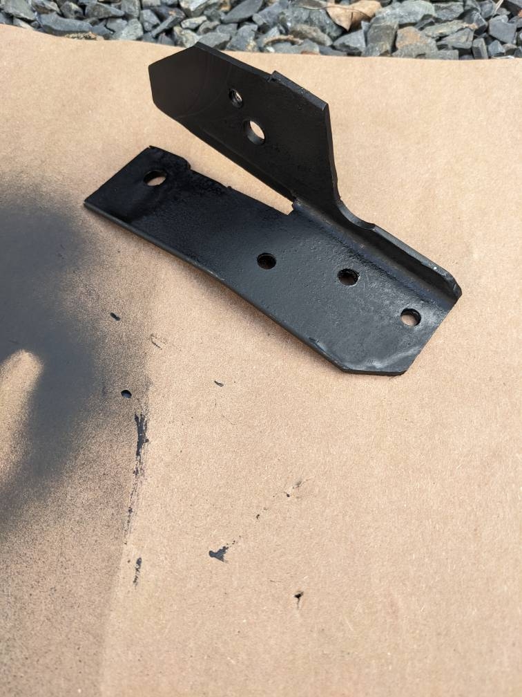

I have a DK5010 that had the same problem. I have no idea why Kioti welded the pivot to thin floor material when there is thick steel next to it. I fixed it with a piece of angle iron and some cutting and drilling.
I posted a bunch of photos. I'll find that and send you the pointer.
   / Shuttle shift issue #12
I am not a welder so I drilled and used self tapping bolts - 2 in the pivot bracket, and two in the heavier steel.
See photos
It has held up well for 2 years/200 hrs.
See photos
It has held up well for 2 years/200 hrs.View attachment 4133430View attachment 4133431View attachment 4133432
Fantastic!!!! thanks a bunch for the insight!!!! how long has the fix held up? I might throw a quick weld on there then do a bracket like you did. You did a nice job. Do you think the 1/8 bracket was thick enough? I love my tractor. But its things like this that really irritate me.
   / Shuttle shift issue #14
1/8" angle iron is plenty strong enough even though cutting it the way I did weakens it somewhat. The vertical part is bolted to 3/16" plate steel and there are two screws through the pivot bracket so it will not move.
I installed it in Sept 2023 and shifting is still very smooth.
