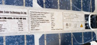

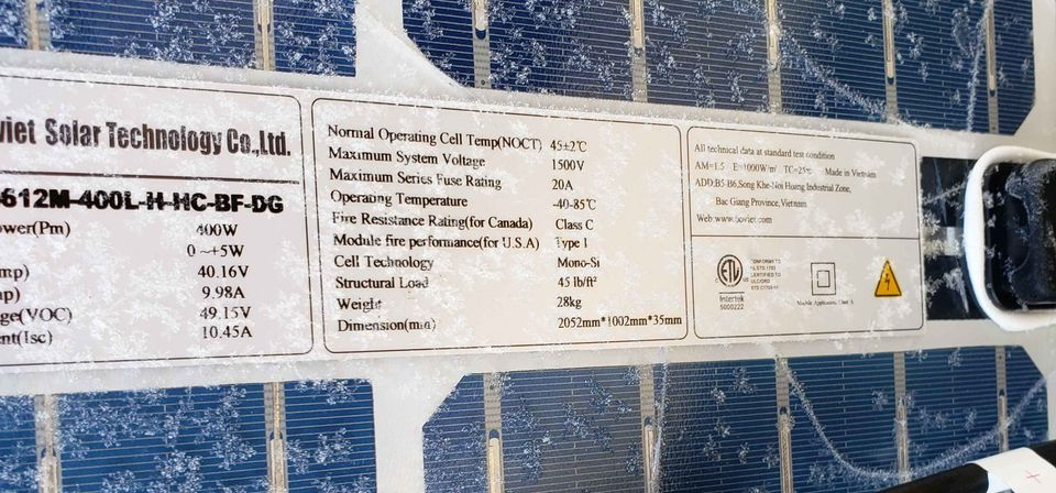

/ Off grid solar system design help? #10
We have a off grid cabin and I'd like to use a solar panel to power some low voltage lights. My thinking is to buy some 400 watt, 40 volt solar panels and use them to charge some semi truck batteries. I can get these batteries super cheap used. Because the batteries would not be matched, I was thinking there's be one solar panel and controller per battery. I'm guessing two setups would be enough to power the led lights. I only want to power lighting, any other power demands would be on the generator. Does anybody have experience with a system like this? I want to confirm my approach before buying any parts. These are the panels I was considering: Solar panels
These panels look like they've been through an intense hail storm or were damaged by some other means.
*If* they work at all, they're going to be missing a lot of cells and certainly will never come anywhere near 400W.
#11
I noticed that shading you pointed out. I was hoping it was just dirt, but if it's damage then I'll pass. There are other options out there.
How can I test the panels for function?

For the moment I'm ok with the design. I would like some advice on how to evaluate the panels for condition and proper function.

/ Off grid solar system design help? #20
mkay. Usually we look for 3 things:
+ Open Circuit Voltage -- point at Sun and measure Volts across the leads.
+ Short Circuit Current -- (we do this, but only a maybe for you) -- make sure the Amp Rating and connections on your meter can handle the current -- many have a fuse and Max of 10 Amps. You can do this in a dark area, for less Amps.
+ MPP -- Max Power Point. This usually takes an inverter, or micro-inverter that acts as a load, and optimizes the combination of Volts and Amps (Volts X Amps = Watts) to get max combination from each panel. This tells you what it will really produce in the optimized system.
