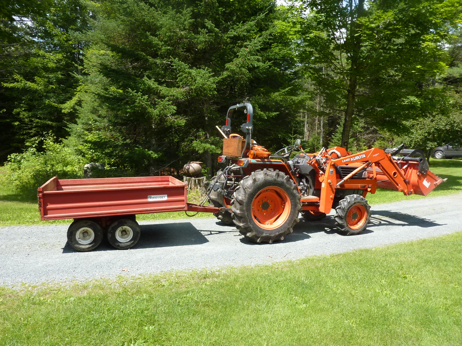

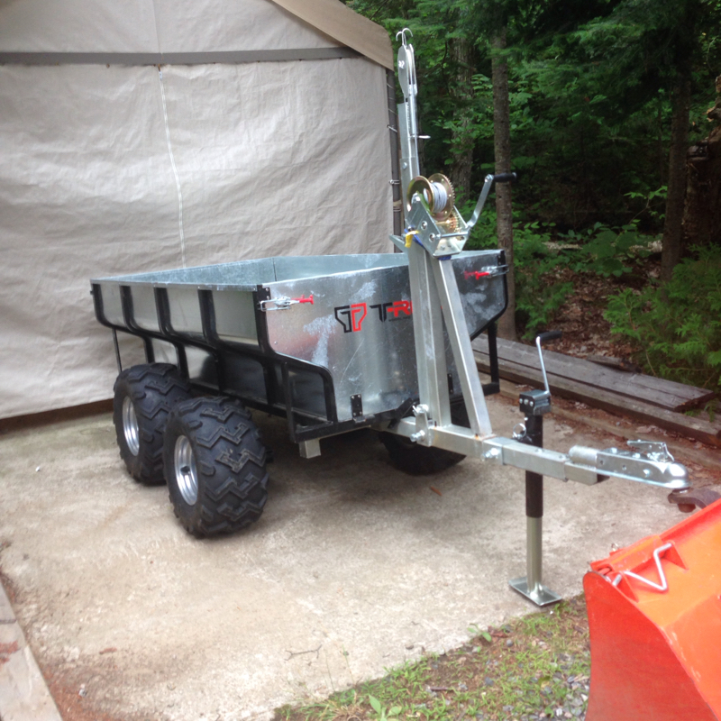

Here's how far I got with T-Rex yesterday:
More to come!

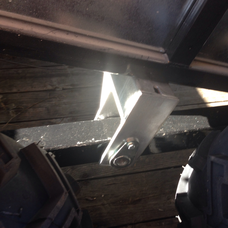

The fact that the stub passes through the frame is good. I've seen some where they were just butt-welded onto the frame. The frame looks stout enough to avoid getting twisted by the load (especially when you consider that it's just one of 4 wheels supporting a trailer with up to 2000# of payload. How does it look where the walking arm attaches to the main trailer frame?
Here is a shot of the pivot itself. That square tubing that you see is part of a big cross that forms the basis of the whole centre of the trailer frame. Very heavy duty.

Here is a shot of the pivot itself. That square tubing that you see is part of a big cross that forms the basis of the whole centre of the trailer frame. Very heavy duty. <img src="http://www.tractorbynet.com/forums/files/attachments/477201-off-road-dump-trailer-options-image-765463311-jpg"/>

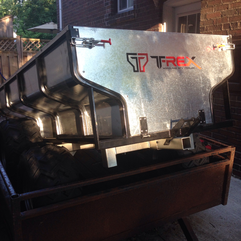

Here's another picture that I took before I put the box on. You can clearly see the big t (cross) that forms the centre of the frame assembly.

Wow! Great fun! Looks like it's going to be MUTS vs T-Rex (the name of the Woodland Mills trailer that I bought.). This will be very informative and entertaining. Here's how far I got with T-Rex yesterday: <img src="http://www.tractorbynet.com/forums/attachment.php?attachmentid=477198"/> More to come!

T-Rex lives! Very nice trailer, very solid, with thick galvanized steel square tubing for the undercarriage. The dump winch works as advertised, and smoothly. The tires reek of VOC's, but I'm hoping that will dissipate with time. One thing it did not come with was safety chains, so I had to spend an extra 50 bucks on those and the connectors. Also, I may decide to extend the front bar, and that is another nice feature that you can adjust the length of the trailer. (Comes in very handy when you remove the box and haul logs.)
More to come after I load and dump some dirt next weekend. Also, I can adjust where exactly the dump box sits, so that I have approximately the right amount of tongue weight when the trailer is loaded. Will have to experiment with that. And I have to add some grease to that swivel mechanism on the front tongue. Kind of a unique feature, that swivel tongue - keeps your ATV from being rolled over if by some chance you roll the trailer!

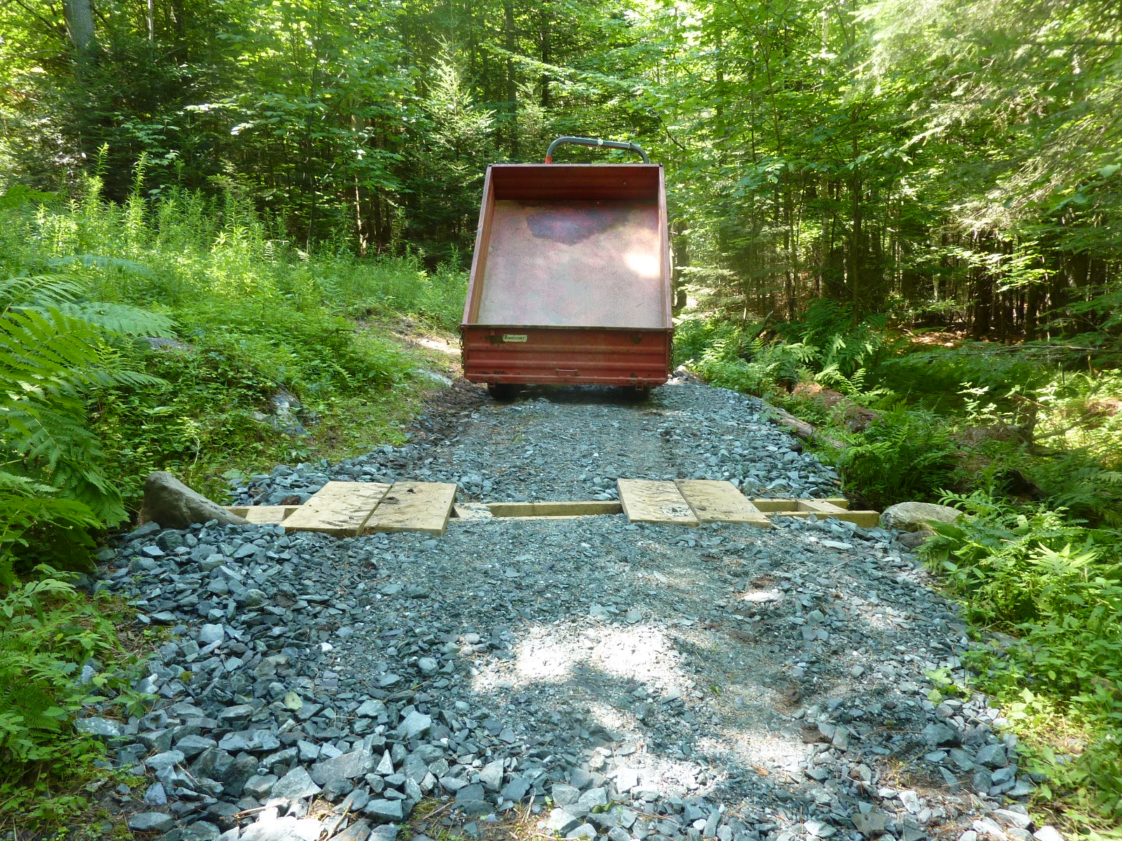

T-Rex works!
Dump mechanism works great. But, these logs were slightly shorter than the trailer box, so when they shifted back a wee bit, the tongue weight became negative.
Have to move the box just a bit farther forward. (More pics about that later.) 👍
