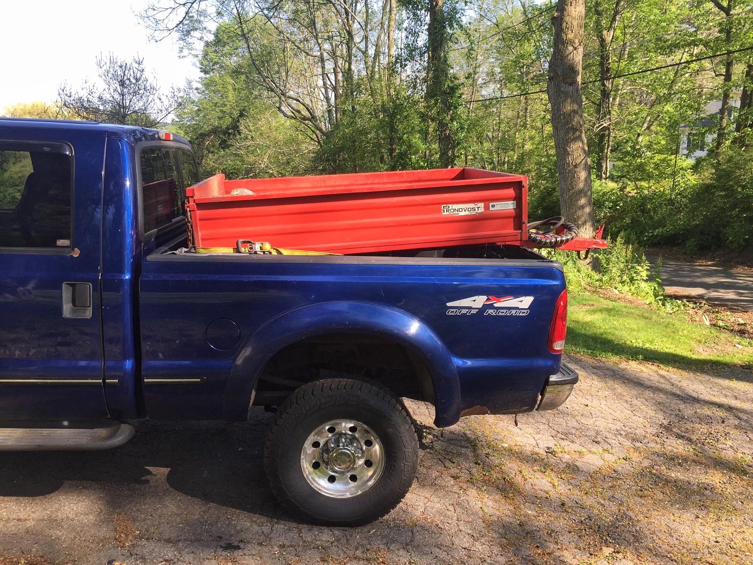

OK, picked it up yesterday, for about US$1300 before tax.

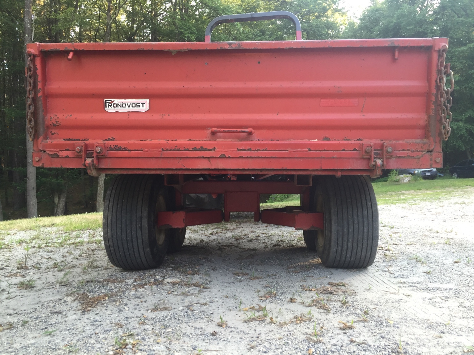

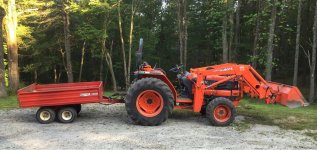

Gordon -
Nice work on the hitch modifications. It reminds me that I really need to work on my welding skills.
I find I seldom use the drawbar on my tractor for just that reason. I end up using a draw bar that goes between the lower 3 Pt hitch arms.
I do hope you and Piston will keep us up to date on how your Provnost trailers are working out.

As soon as I get some use on mine I will update with my thoughts. I've been away since I bought the trailer, so it's just sitting there mad at me for not using it.

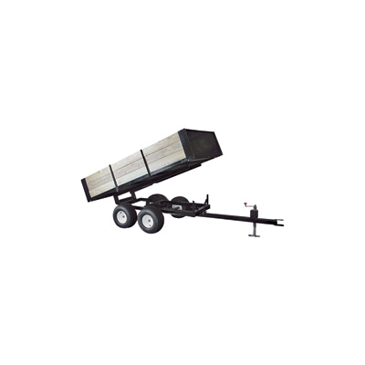

Has anyone looked at or used one of these? They come in wagon or trailer form. You can add a hydraulic piston.
http://www.northerntool.com/shop/tools/product_200311039_200311039

Northern tool has those brought in from Canada from a company called Millside. They are weak at the hinge point and bend pretty easily. They copied a design made by Country Manufacturing who used to sell to Northern, but they cheapened the design quite a bit. Compact Tractor Wagons and Tandem Axle Utility Trailers 2 ton Capacity by Country MFG.

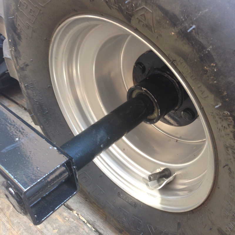

Partially assembled wheel sections. Note that each side will be on it's own stub axle - no long axle between them, since the bottom of the trailer bed is so low. (Edit: No, it is so that the two sides can pivot independently.)

Mounting on this stub axles is one of the advantages of the walking arm suspension. It leaves you more ground clearance than a through-axle would.
I'm curious what you think of the stub axle attach points and the frame strength in that area. I've never seen one of these trailers in person, but a possible downside of the stub-axle mounting is that they can bend if the mounting point is not robust enough.

Here is a close-up. What do you think?

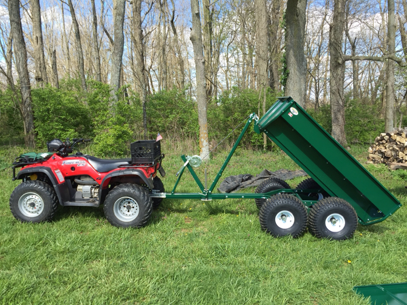

OK, it is tomorrow now. Finished most of the frame. Now I just have to get that 200 pound steel dump box down off the pick up truck and onto the trailer frame.

The fact that the stub passes through the frame is good. I've seen some where they were just butt-welded onto the frame. The frame looks stout enough to avoid getting twisted by the load (especially when you consider that it's just one of 4 wheels supporting a trailer with up to 2000# of payload.
How does it look where the walking arm attaches to the main trailer frame?
