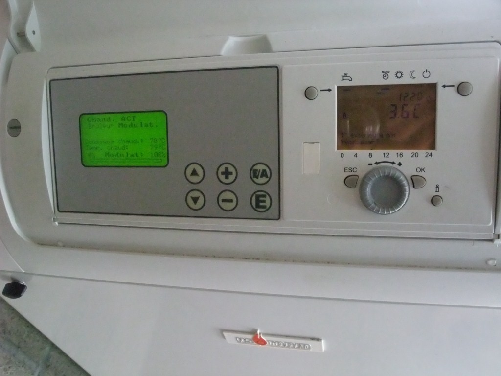

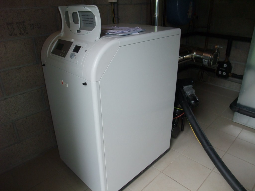

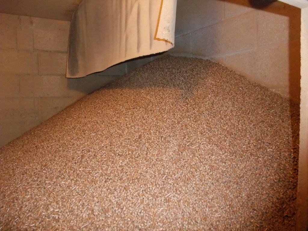

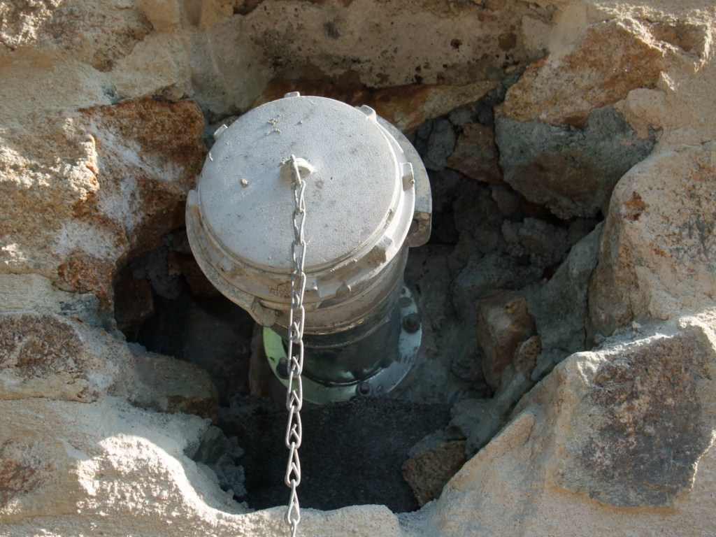

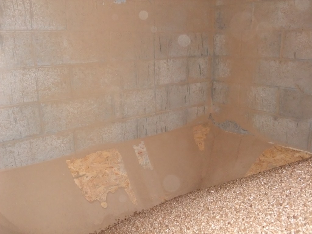

Very nice setup! Do you worry at all about moisture getting to your pellets from the concrete floor and walls?
I am a bit worried about that, but no moisture so far. The walls are thick (granit on the outside and cinderblocks on the inside), the floor is isolated from the ground and the pellets rest on wooden slopes. I keep my fingers crossed. The only incidents I've heard about concerned metal silos.
