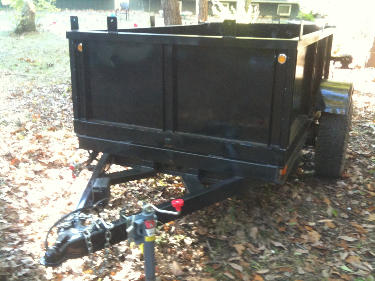

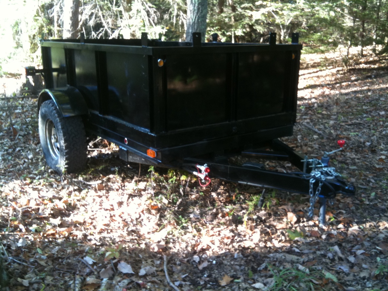

I did actually build the trailer referred to in this thread. I finished it about a year and a half ago but I figure I should provide some evidence by attaching some photos.
   / offroad trailer #20
Very nice. Is it powered off the tractors hydros?
