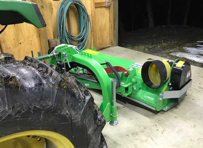

It arrived today. Not great timing, as the snow is only half melted and it didn't arrive until 5:00 pm as it was getting dark. Truck can't get to the house so had him drop it beside the road, and had to drag it off the liftgate with my tractor. Fortunately my neighbor came by with his side-by-side as I needed the help, and the lights, to cut it loose from the skid and hook it up to the tractor to cart it home.
Here's what it looks like once free of the packing:
Looks well made and nicely finished. They included extension hoses to reach my FEL outlets, with right-angle fittings and connectors, which I'll have to install.
Any tips on how to vet the air from the hydraulics?
It's going to be a while before I do much testing I'm afraid.
Somebody needs a set of pallet forks.
Hook up your cylinder to your remote QD’s and just cycle the cylinder 10-15 times. Presto ...... Air gone!
BTW ..... very nice flail mower!

Just hook up the hydraulics & cycle them back & forth a few times, sometimes up to a dozen & it get the air out. The oil will entrap the air & cycle it on out. When sitting unpressurized in the tank it will come out.

Thanks guys for the tips on how to deal with air in the hydraulics. It looks like the cylinders and factory hoses do have fluid in them and it's just the extensions the dealer put on that are dry, as I learned after draping the open hoses over my tractor overnight and finding oil on the floor this morning. It will be a few days before it's warm enough for me to play with it.

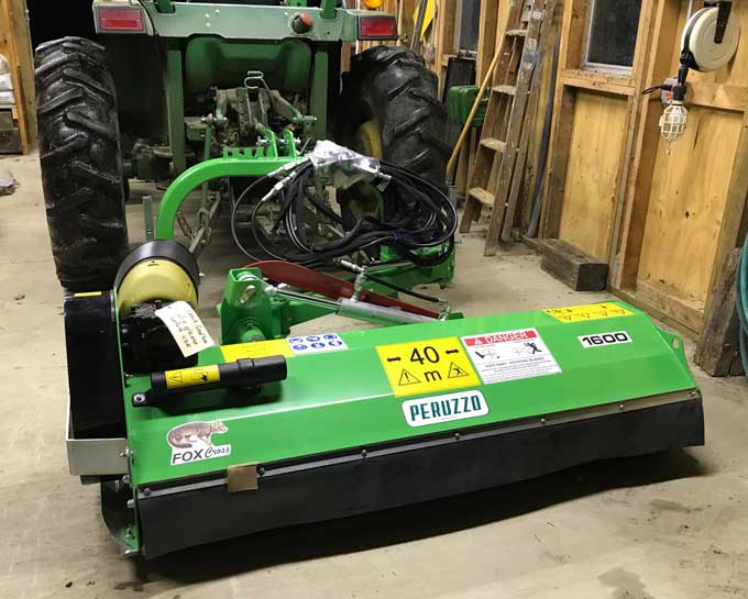

That's a really great looking machine. Do you mind sharing a ballpark price on it? My guess is 4-5 grand, but that's just a guess.

Five grand plus shipping is about right. I choose this one because it offers the widest offset in it's class, which is important to me with the wide rear wheels you see in the second photo, and because it's relatively light weight which I thought best because of the size of my tractor and my hills. The Del Marino is a bit cheaper but the offset isn't as large and it weighs more. The Chinese-made brands are a lot cheaper but I questioned the quality and couldn't find anyone who owns one who was willing to vouch for them.
