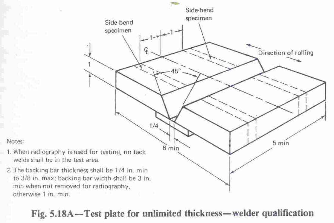

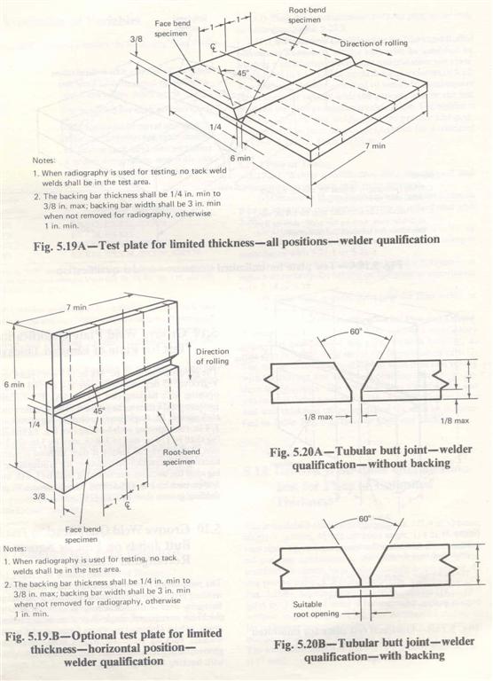

Here are a couple welder qualification test plates from an AWS book.
1/8 inch 6010 open root I like to use a 5/64th inch land, and use a 5/64th inch drill bit to set the gap.
3/32 inch 7018 open root I use 1/16 inch land and 1/16th inch drill bit to set the gap.
