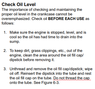

I also wonder if the dipstick should be screwed in or not, (if it is one that has threads).
I hate these, as there's no fully-consistent standard, here. Most manufacturers use the rule of setting the dipstick on the threads, without screwing it in, to get a reading. But I can remember at least one or two cases that used the opposite rule, to screw it home and then unscrew to get a reading. Because of this, I almost always have to grab the machine manual and look it up, as I have at least a half dozen machines with this stupid setup.
In the case of this particular JD LT160 with one of a couple engine options, the manual does no good at all. While JDeere says "install" the dipstick, they don't specify if it is screwed in or not. I guess being vague gives them a way out when someone decides they don't like what their mower did when it did whatever!

The JD LT160 uses a Kohler Command CV460S, and Kohler has a nice 148 page manual for that engine. On p.49 it says to rest the dipstick on the threads, but not screw it in, when checking the oil:
This'd be one of those cases I'd be leaving a nice note to myself in Sharpie, on the underside of the hood. :D I'm terrible at remembering this stuff, but I'm great at leaving myself notes.
Thanks WinterDeere! We didn't take the time to search Kohler's website for the engine, although I knew I probably should. I sent the link to my Bride for her to file.
JDeere's manual is only 28 pages and covers not much more than how to crank it!
