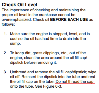

The JD LT160 uses a Kohler Command CV460S, and Kohler has a nice 148 page manual for that engine. On p.49 it says to rest the dipstick on the threads, but not screw it in, when checking the oil:
This'd be one of those cases I'd be leaving a nice note to myself in Sharpie, on the underside of the hood. :D I'm terrible at remembering this stuff, but I'm great at leaving myself notes.
