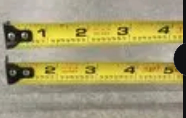

I can't believe how many people are posting about variability in oil pan capacity or dip stick variations. Do you honestly believe that the error is significant enough to cause these misreadings?
Sure buddy…
Cranks, pistons, rods, and every other component are made out of spec all the time, according to you, not the almighty dipstick system.
If you believe there’s zero chance of that component being mis-manufactured/mislabeled, in a different engine block, then simply ignore everything else and put 100% faith in it as you appear to advocate.
Me… I’d double check before making that decision, but that’s just me, and I try to pass in an ounce of wisdom and caution….
