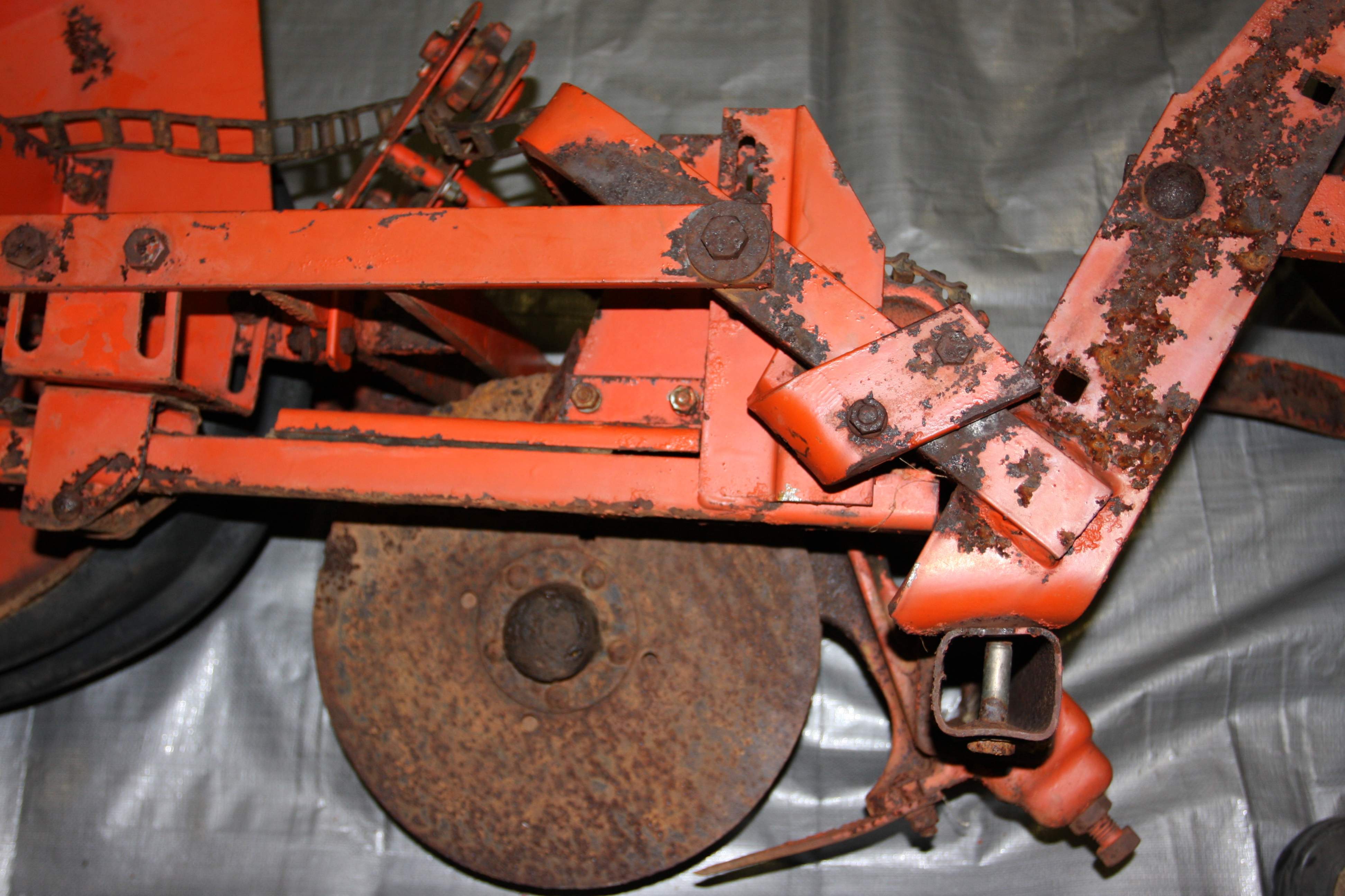

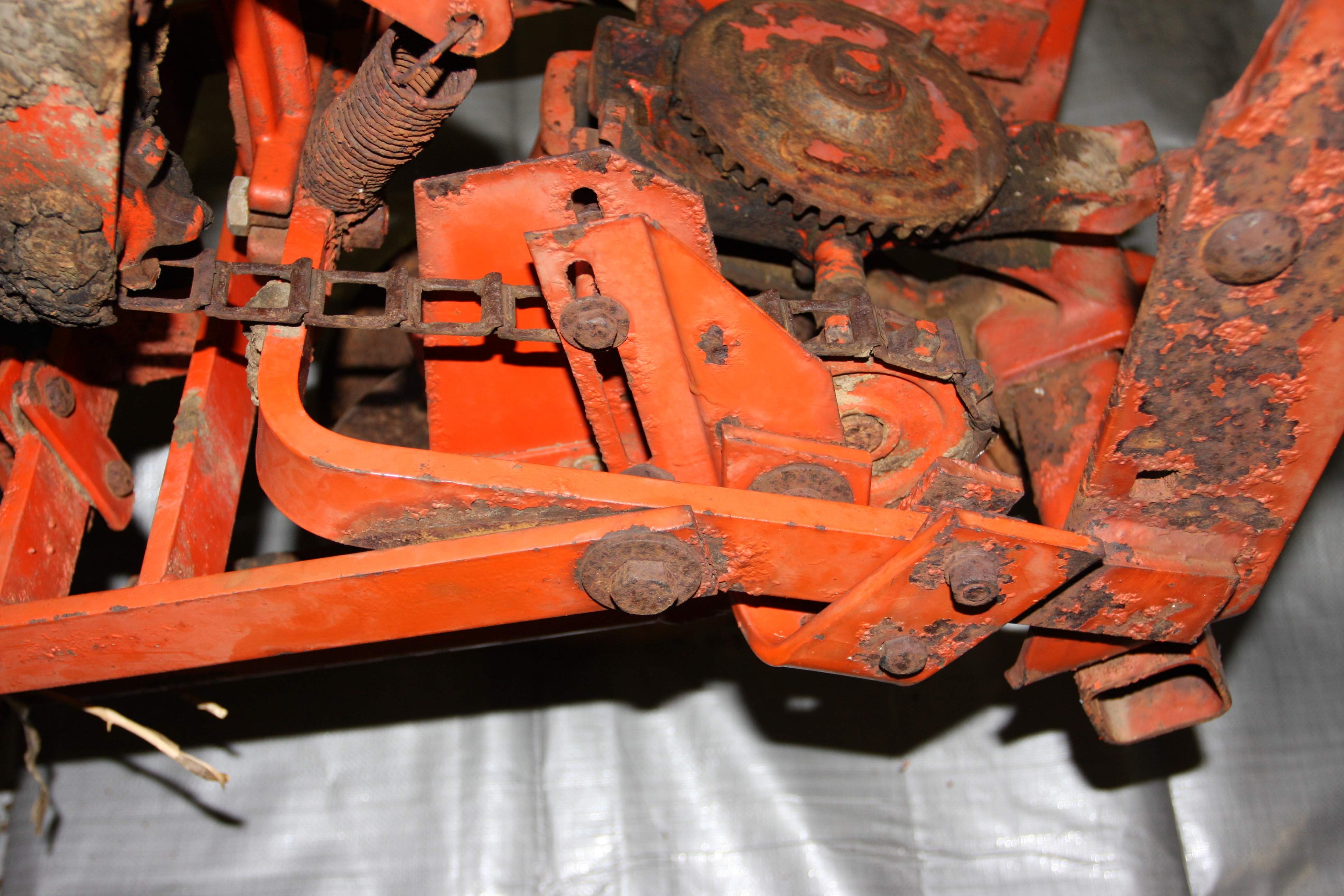

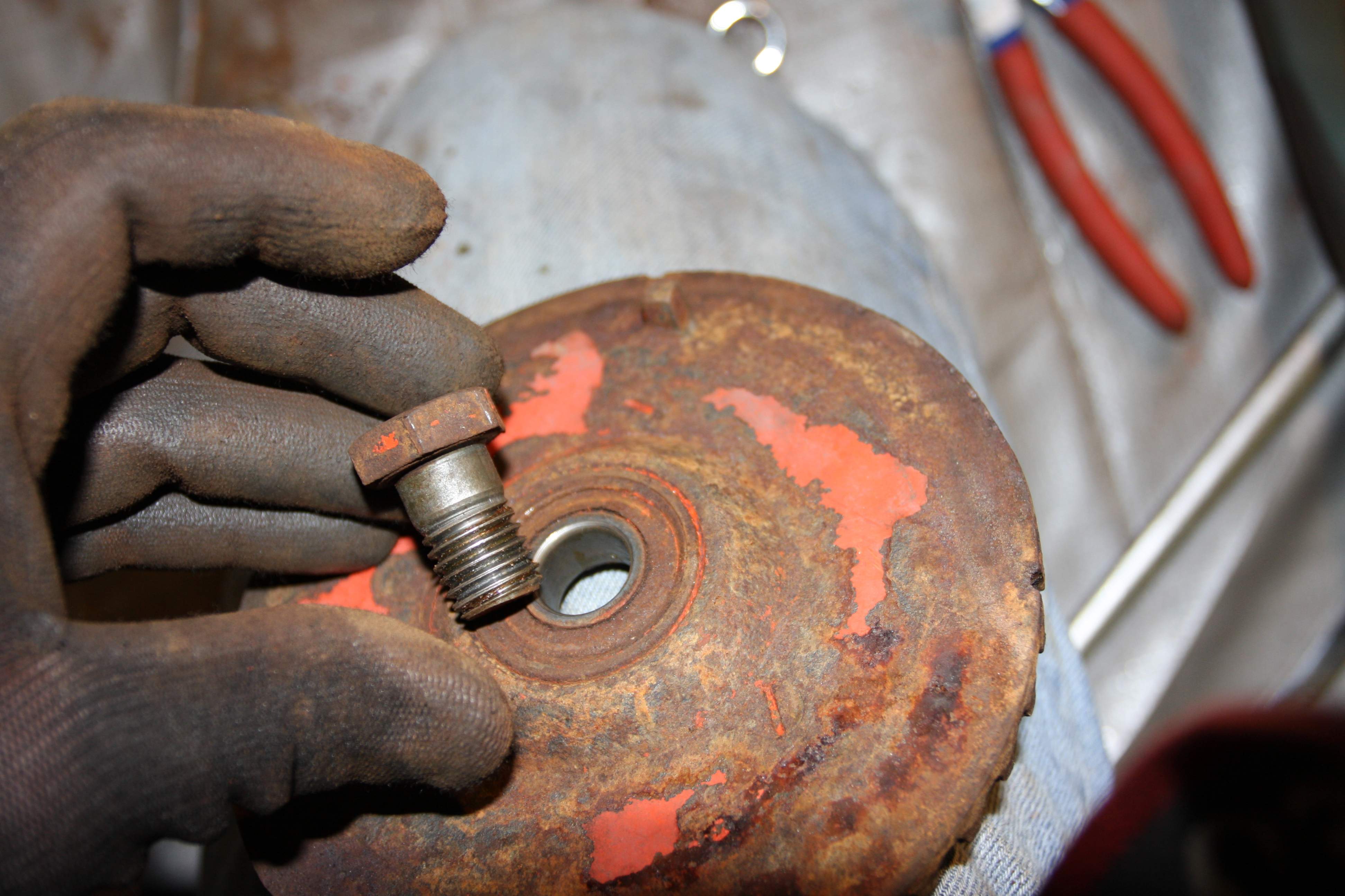

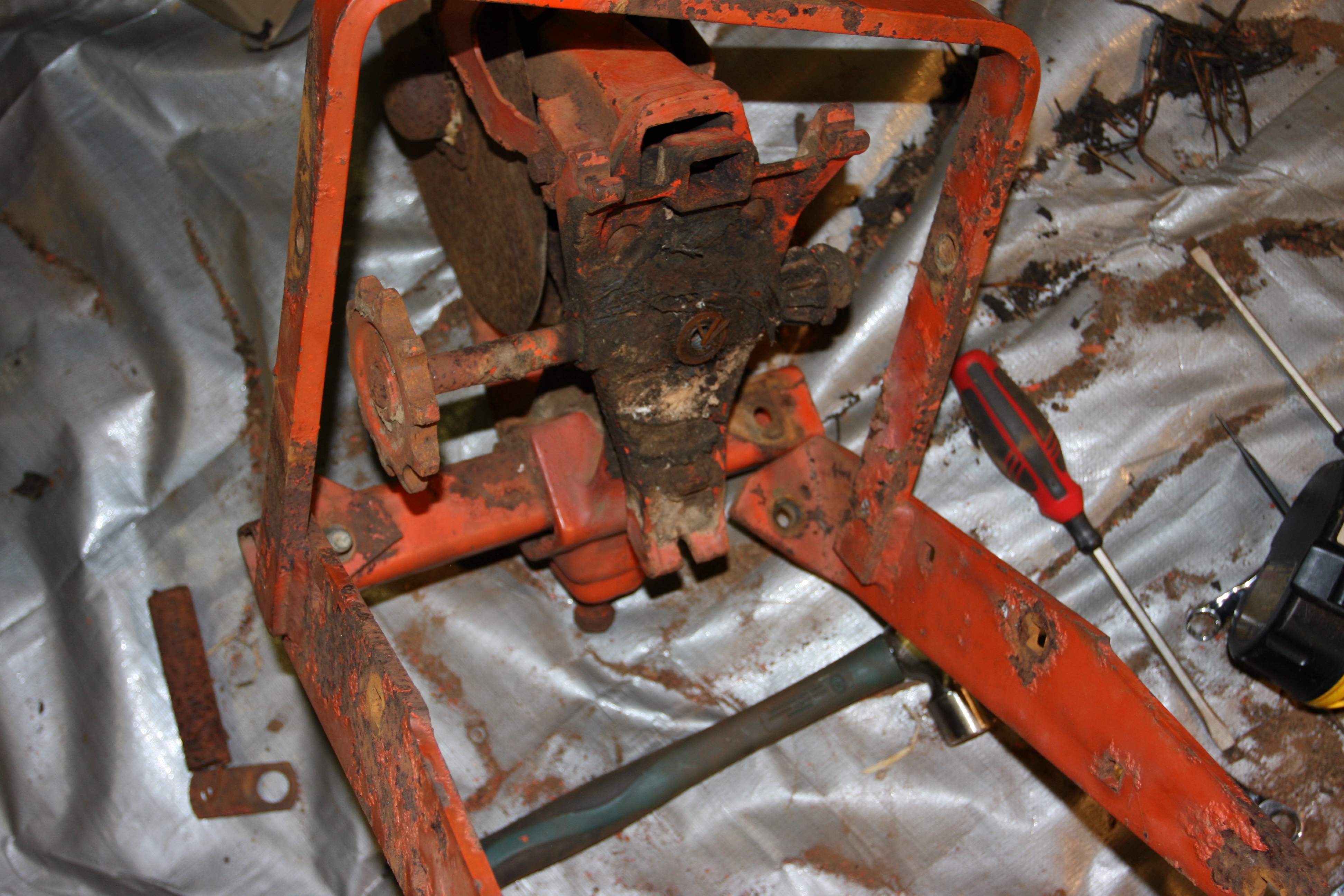

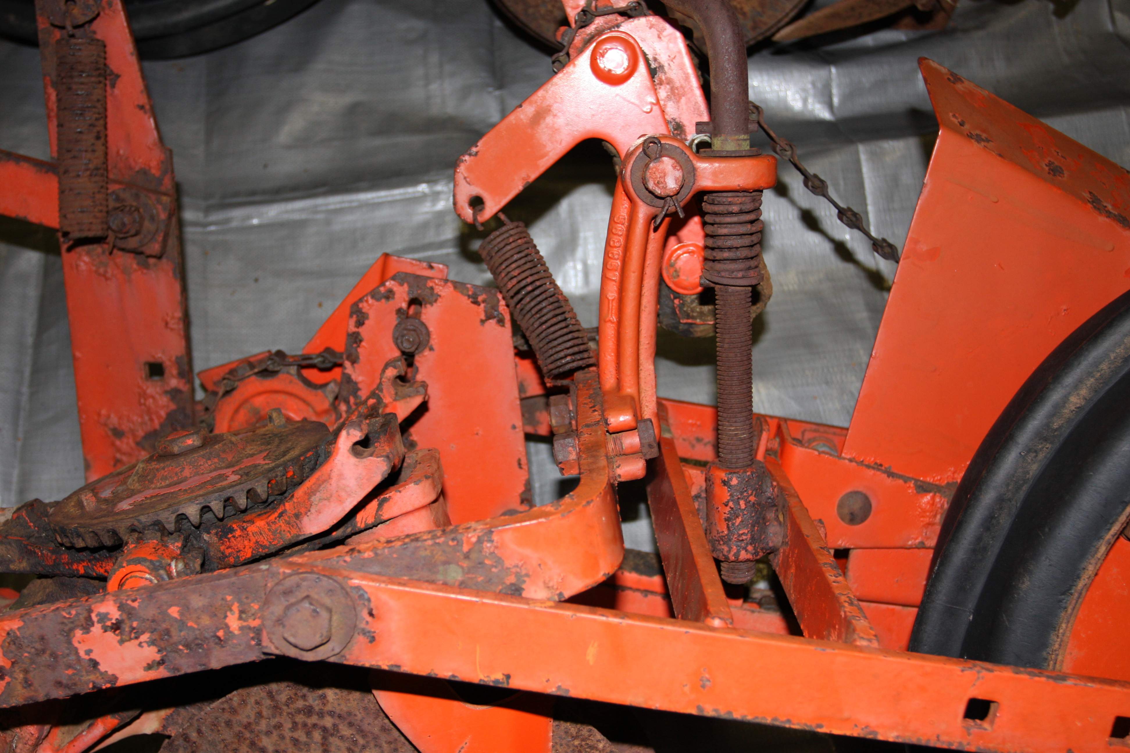

I started breaking down the planter units last night. Way harder than I expected! It took 2 hours to disassemble only one. Thought I would post some nasty pictures. I plan to do the others, clean and degrease everything, and send to the sandblaster.
Two questions. In the one picture showing the pivot bolt in my hand, do you think there is a bearing or a bushing pressed into the circular gear? You may not be able to see it but it does not spin like a bearing (unless it is seized up) so I am thinking it must be a pressed in bushing.
Secondly, know any sources for the disc openners? They have the bearing assembly attached with rivets, so I either use the worn ones, replace the whole assembly if I can find them, or drill out the rivets and replace just the discs themselves (if they are available, but those should be generic).

I am excited about your project. I am looking forward to seeing it completed. Those look like pressed in sealed bearings in the wheel. Search on Agri Supply for the coulters and disc openers. They have all types including some with bearing mounted.

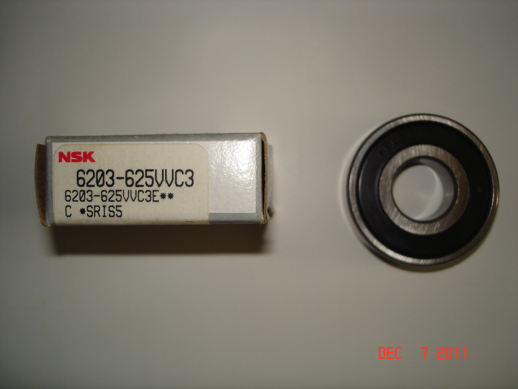

First question, I KNOW there is a bearing. Look closely at your picture and you can see it. It just so happens I have an extra, and knew where it was. If I remember correctly, it's the same one as the disc openers uses, some small difference from original. Worked fine, planted good and smooth. You're welcome to it if you'd like, email me. Be careful getting the old one out, that pinion gear is cast. PB Blaster is your friend (or Kroil etc). The picture is the bearing and box with stock number if that helps.
You can replace the bearings in the openers by drilling out the rivets. I'm not sure if these guys Allis Planter Parts will have what you need. I know you can get openers for a JD 70/71 Flexi planter from John Deere. Might be sacreligious to put those on an A/C planter. They get top dollar from JD, too. The new ones from JD are 12", I'm not sure what the size is for an A/C. Heres a link that might help. It's a pdf for A/C planter parts. http://schmidtinc.com/partsacplanter.pdf . There's an 800 to call and check. They sometimes have used parts. HTH Mark

Grind or drill the rivets, replace the bearings and then use 1/4 x 20 bolts with loc-tite to reassemble. You will have to grind the heads about half way down in height if your disc openers are close on the inside at the hub. I did this on my Flex 71 JD planter.
I believe that those should be either 11" or 13" openers and places like Agri-supply should have them. I saw them recently when I was building my no-till coulter, just don't remember which site it was at the moment. Yetter and Acra-plant have openers for most planters:
