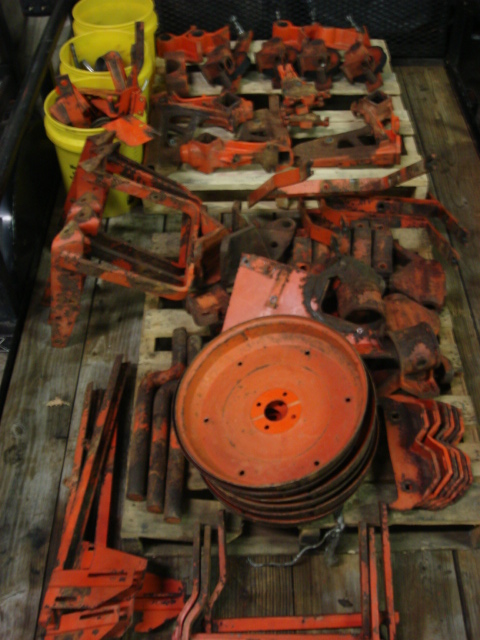

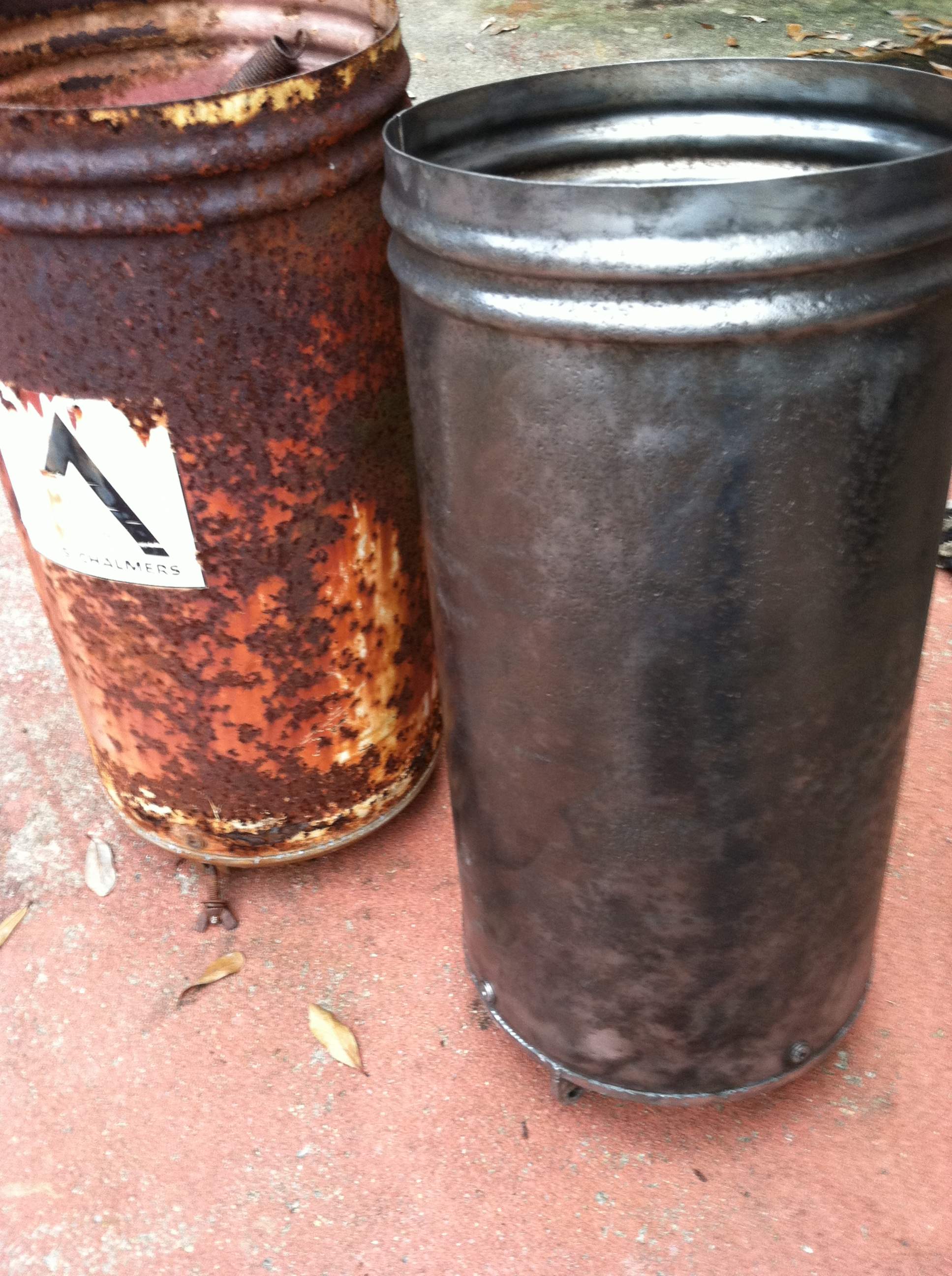

Here is a progress report. I have all disassembled and ready for sandblasting. I have all new bearings, new disc openners, new coulter blades, fasteners, etc. I will blast it soon and then prime and paint. Then the fun starts, the reassembly. Here are some pix. The seed boxes were cleaned electrolytically, and the rest was washed in a parts washer and will be blasted. I still think I will make the final tool bar 8" wide (that's the widest I can comfortably transport) and initially make it a 3 row, 3 point hitch no-till version.

The electrolytic derusting process works pretty good doesn't it? I was impressed the first time I gave it a try. Looking good so far.

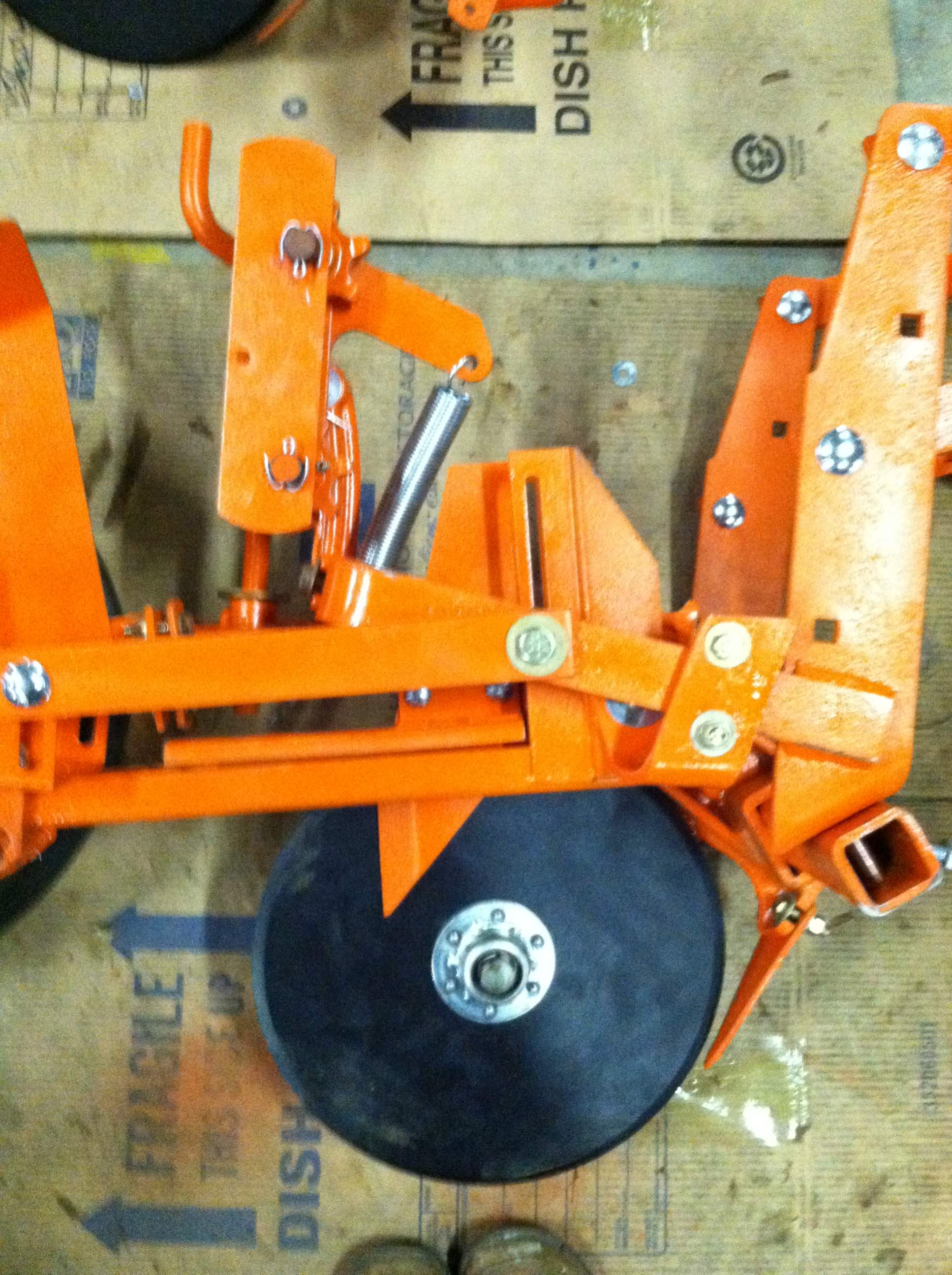

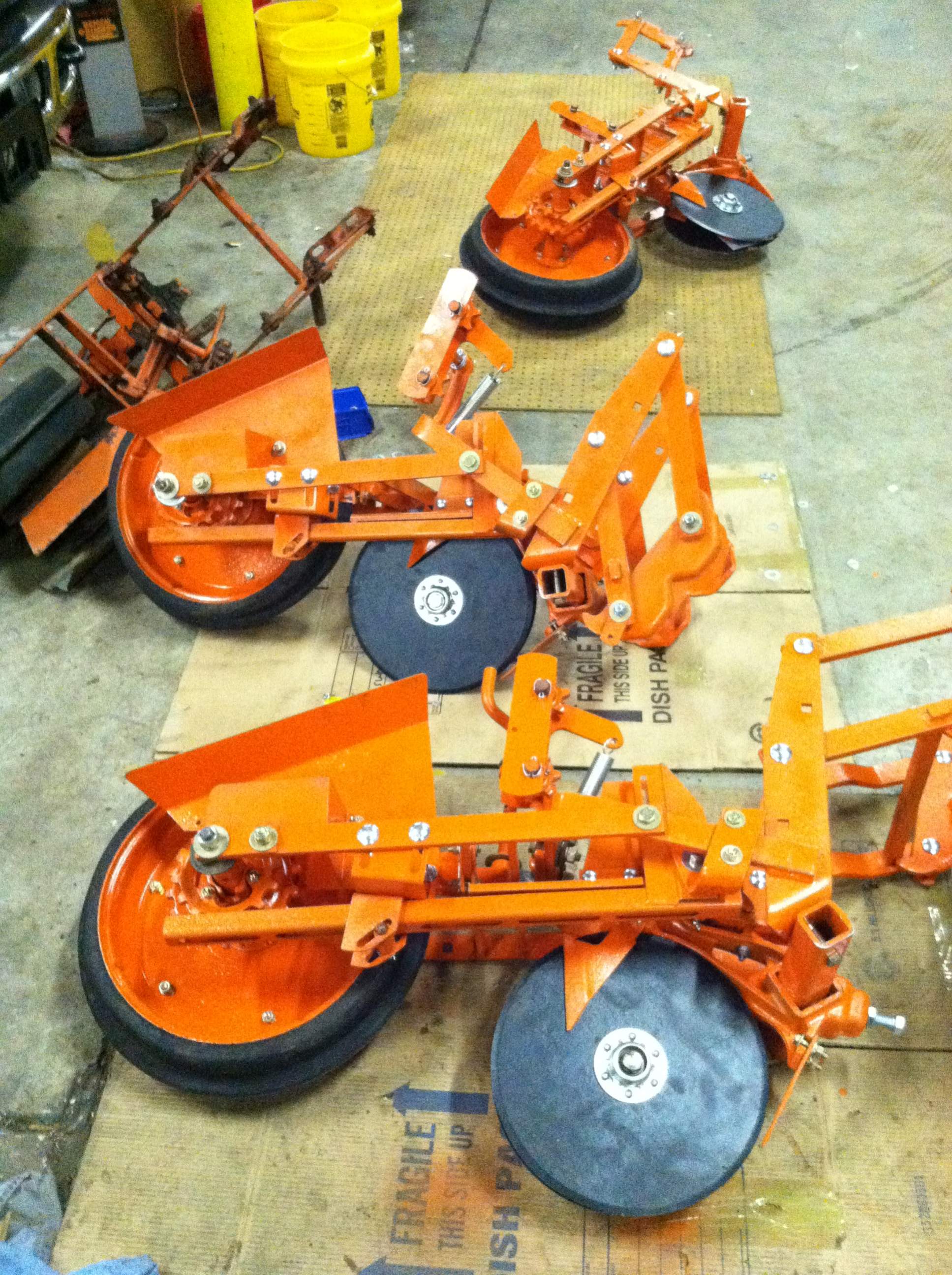

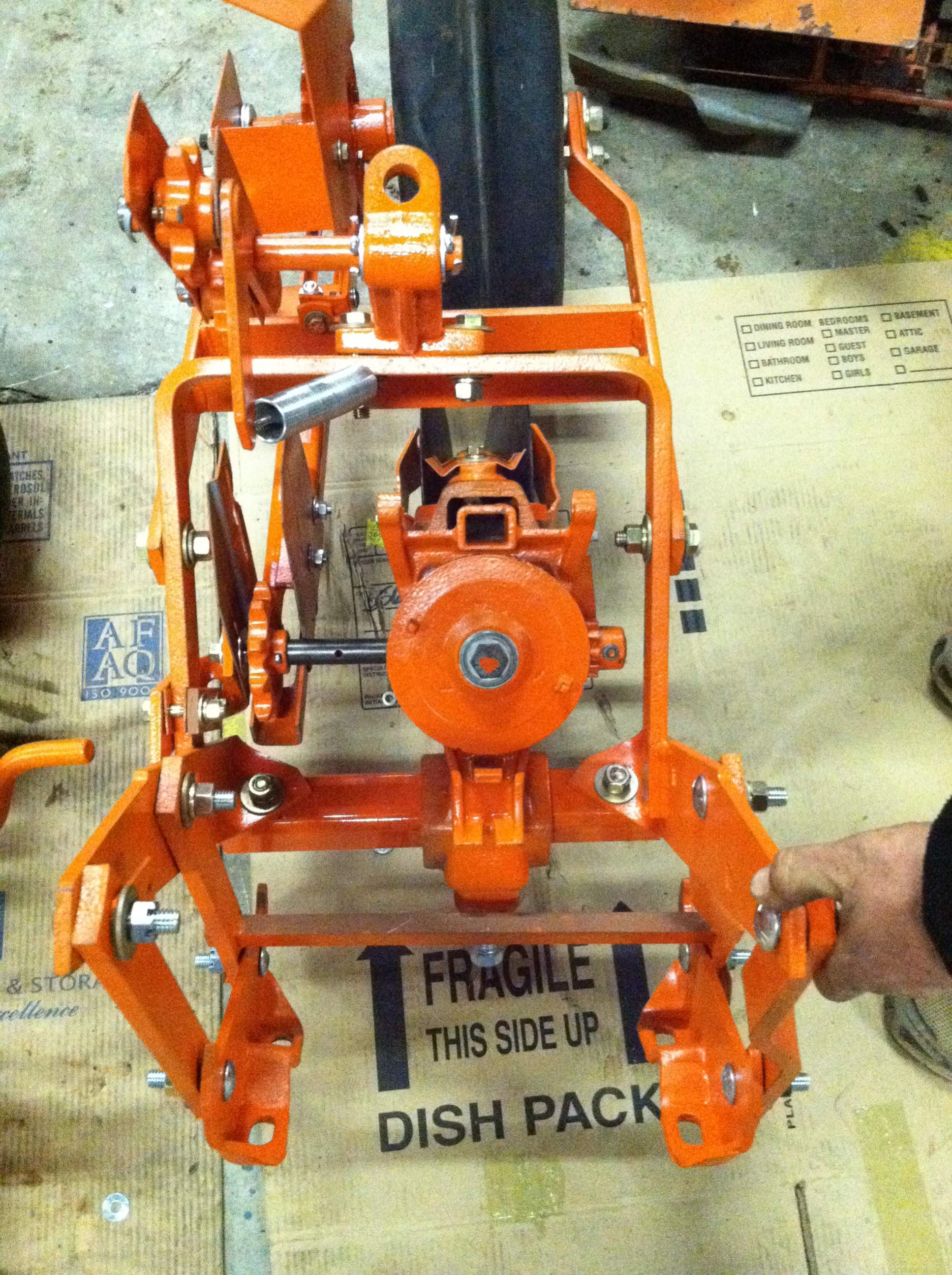

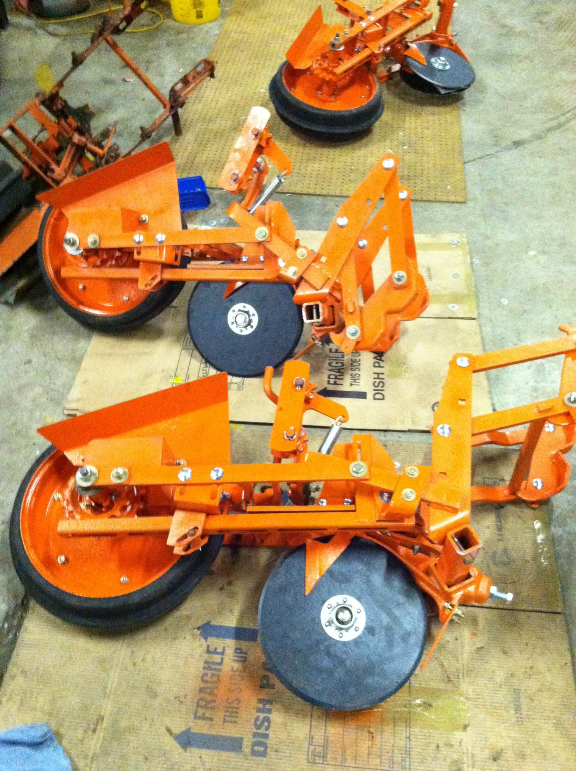

Been working on my two restorations. Since I have almost finished the disc, now I am reassembling the planter. I think my wife is going to divorce me. Its not another woman, but she thinks my implements and I are spending too much time together! Here is the latest. Got the three units almost finished, and all is going well. I'm sure glad I left one intact and can refer to it as a pattern. Pictures alone would have been hard! All is falling into place well. I bought a zillion bolts at TSC and seem to have all the parts I need. THe new parts (bearings, races, coulters, openners, pinion gears) all are perfect so no glitches so far.
Looks great:thumbsup:

Looks like you almost have it whipped. Better get your seed ordered!! ;)
