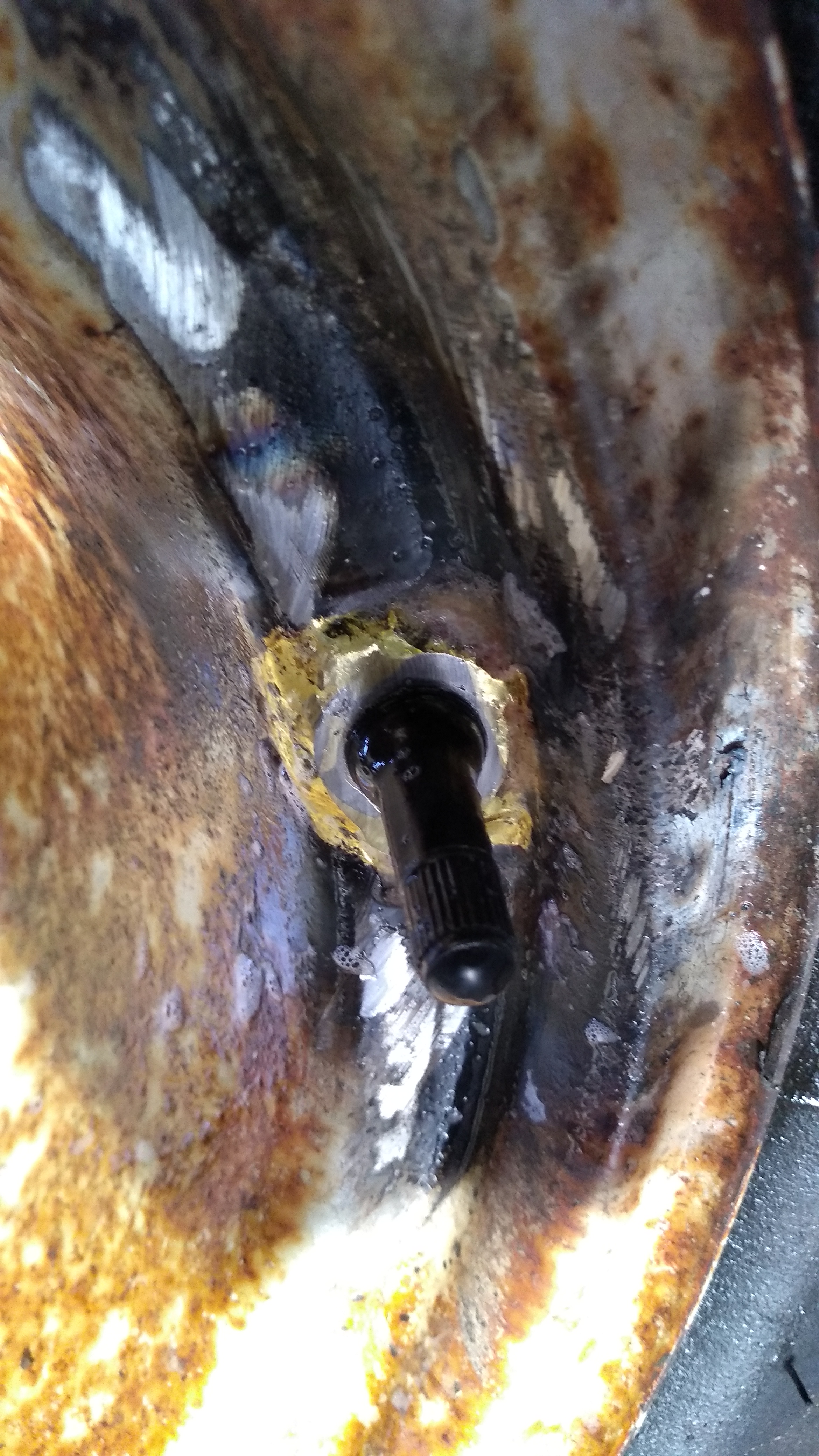

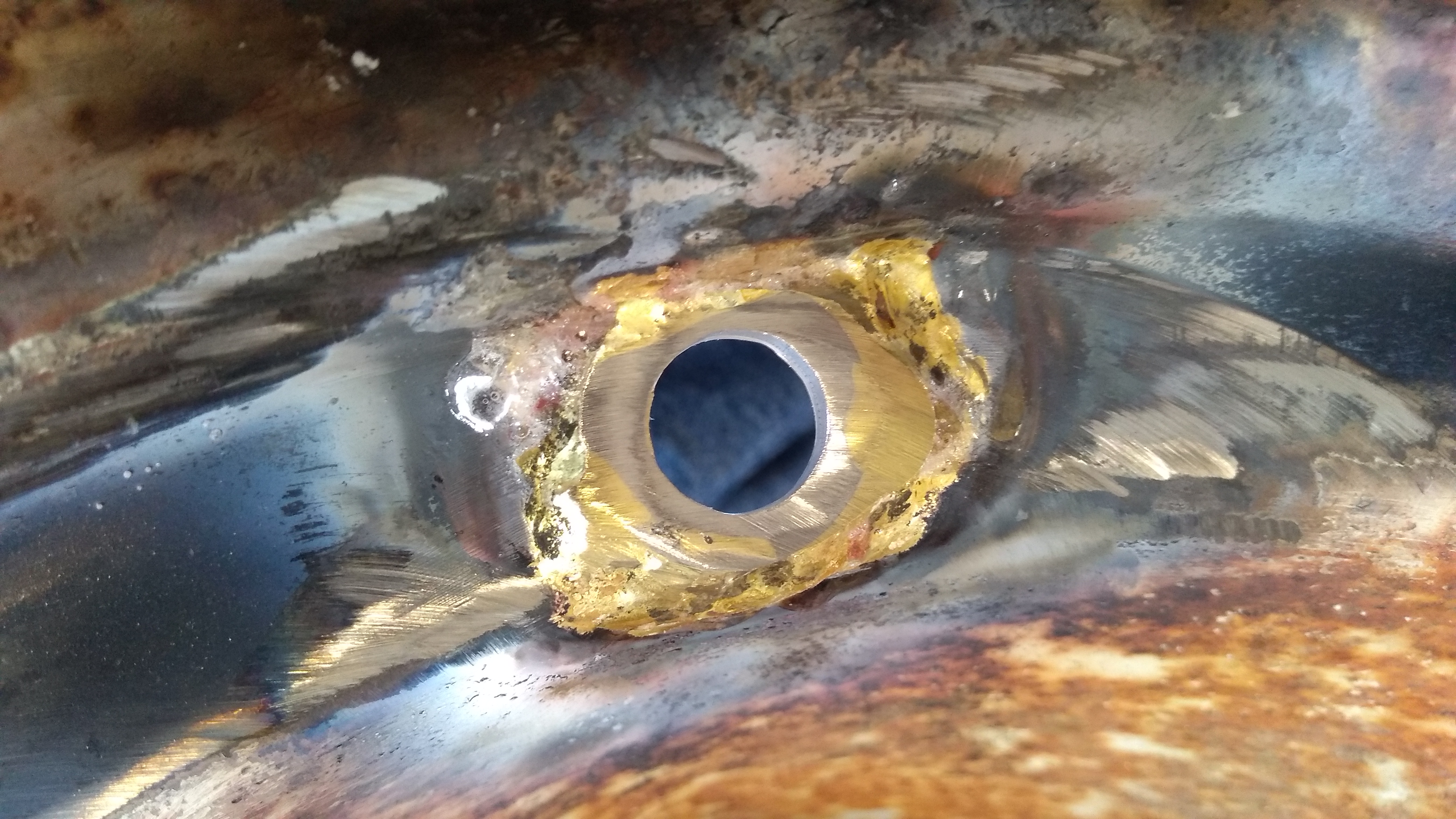

So I had 1 of the big tires going flat after about 2 days....
I thought it was going to be a cinch to fix when I found out the valve stem was leaking... I dismounted the tire, using the edge of my FEL on my tractor. This works great if you're careful and smooth handed. The hole the valve stem fits through was actually rusted out, and had a gouge in the 9/16" diameter. I ended up buying a metric flat washer, and brazing it in place. Then I had a tapered reamer to size it up to the 9/16" finish diameter. Deburred and ground the faces flat, inside and out. It seems to be holding air, spraying some kids bubble solution on it (I buy a gallon at walmart). I had to come in and take some ibuprofen. I am beat down. I had almost every tool I own out today, just to do a few things. The rim repair had out my torch set, of course I had to go buy some brazing flux and the washer.

Pictures of the rim repair. Brazed a washer over the valve stem hole.
