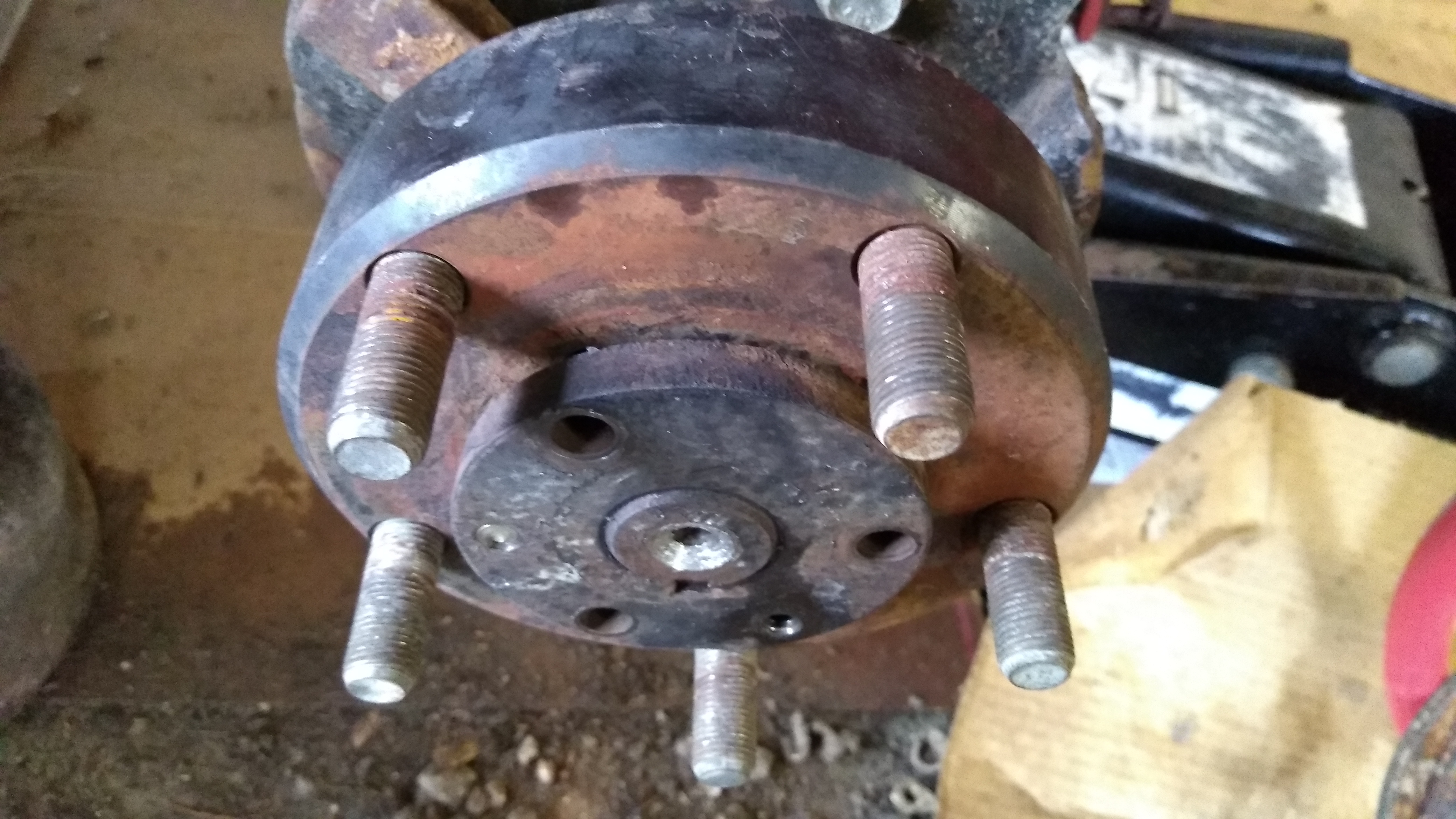

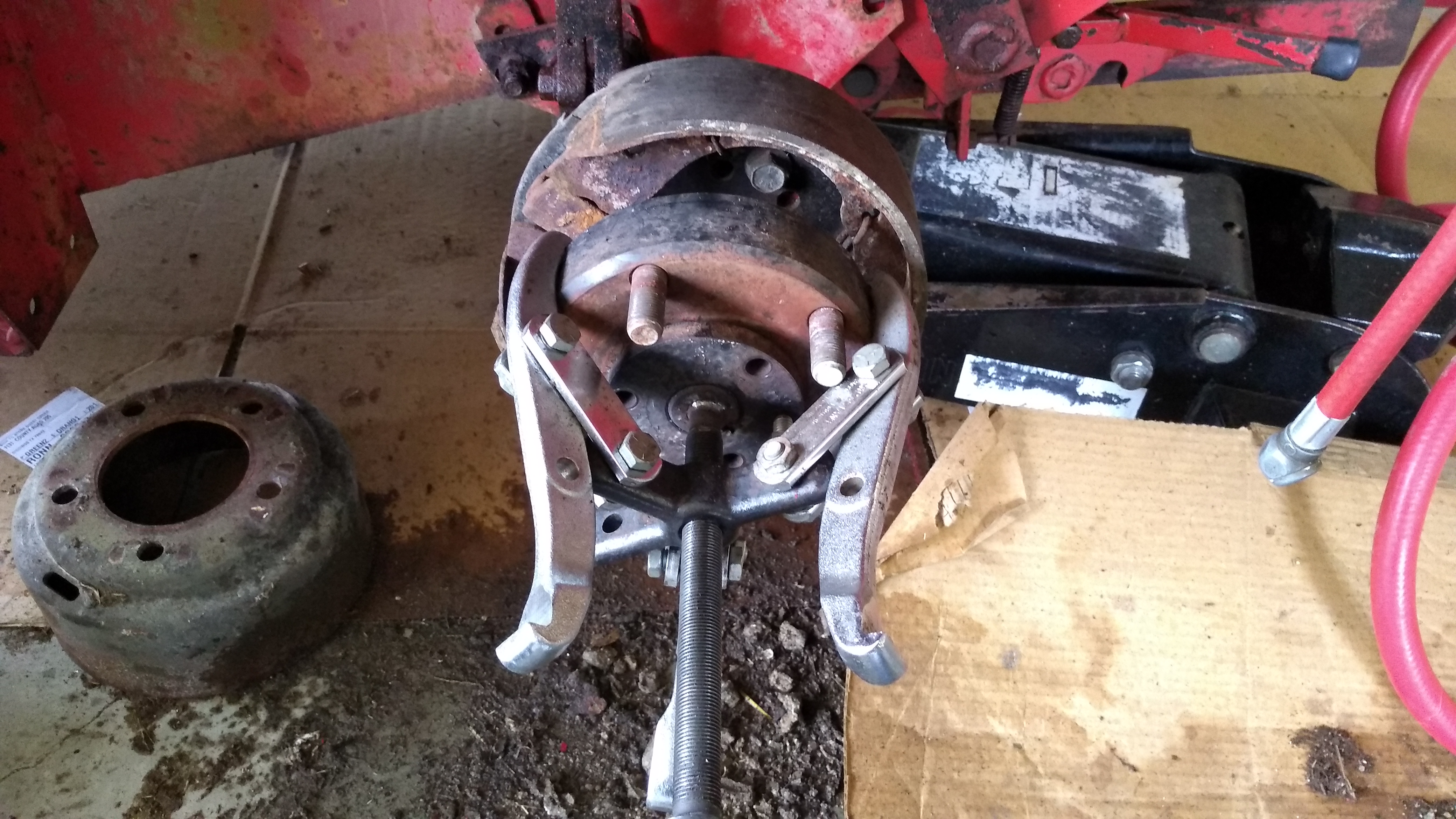

The wheel's hub has a bit of longitudinal slop. Trying to get wheel hub off. Anyone know the trick?

No, sorry. But I will certainly pay attention in case I have to do that some day. Did you say, why it has to come off?
Compared to a real torch, I don't have much use for sprays, but it can't hurt. Even if you can't get the thing hot enough, which would be a challenge, sometimes I think the heat may cause the oil to seep in better. Maybe a wack or two and then try brute force with a puller again.

It's a taper fit I think.. you will see a threaded bolt hole screw a bolt in there and it should back off the tapered lock...... jim

Interesting. That would make perfect sense as there doesn't appear any other way of securing the hub.
Slop doesn't sound like good news for the bearings. My usual recipe for stuff like that is to heat it up to spit sizzle hot, douse it in a good penetrating oil like Kroil or a 50/50 mix of acetone and ATF, let it cool, then try the puller again. Keep repeating until you lose your patience and go after it with a BFH (Big F'n Hammer). Good luck, and don't hit yer finger!
