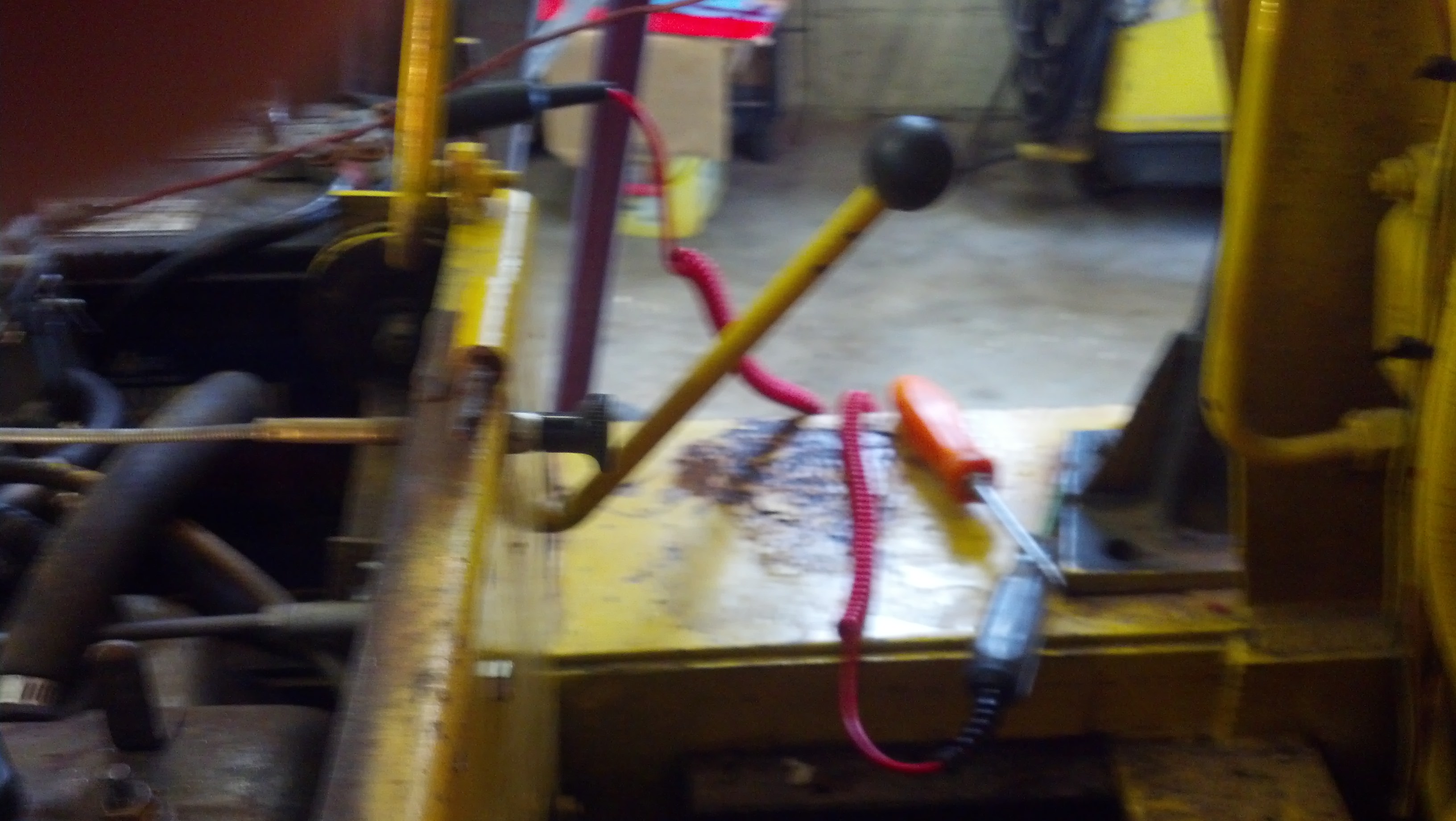

Solidoak, dynamic industries 110: I have an older Swinger 100 also. Love the machine, currently rebuilding the Renault Continental engine. Looking for an operation manual for the machine, I have a parts manual. Could either of you describe what is the purpose of the "Neutral Start lever" There is an ignition interlock switch on it, but what is it's mechanical function.

Not sure what you are talking about when you say "neutral start lever". Can you take a pic? Send me pm if you need operating manual for Renault engine... I don't have anything for the swinger except the parts manual and if any one needs it I will give it to you at a reasonable deal. You can pm me.

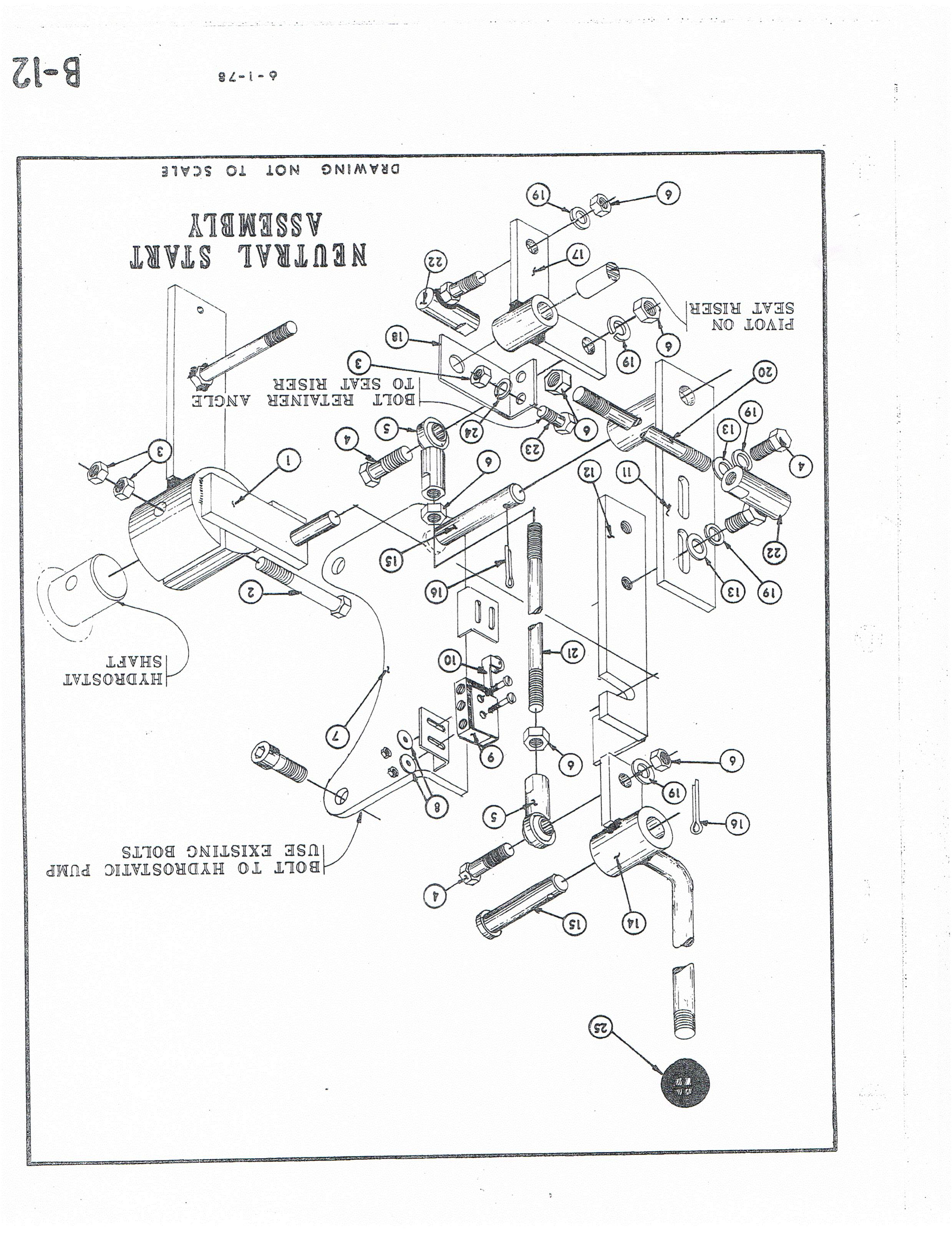

I've attached a pic of the control lever and the page from the parts manual. I'm not sure what are the mechanical functions of the control. Electrically, it interlocks with the ignition, but why? Is there supposed to be a seat switch also? The electrical functions have long since been bypassed, I'm rebuilding the Renault engine and trying to restore machine to normal operations

I don't know what that is. It appears as if it serves the same function as the fwd and rv brake pedal and put the pump into neutral... It might have a safety feature that doesn't allow the ignition to turn unless the lever is in the neutral position.

The lever serves two functions. It pushes a microswitch to allow the circuit to the starter sylenoid to connect and it holds the foot pedal in the neutral position. I the lever has adjustments on it to get everything to engage correctly. The wiring diagram in the parts book shows the switch and wiring. The wires are probably just fastened together with a little bolt and taped up. Their was no seat switch.
