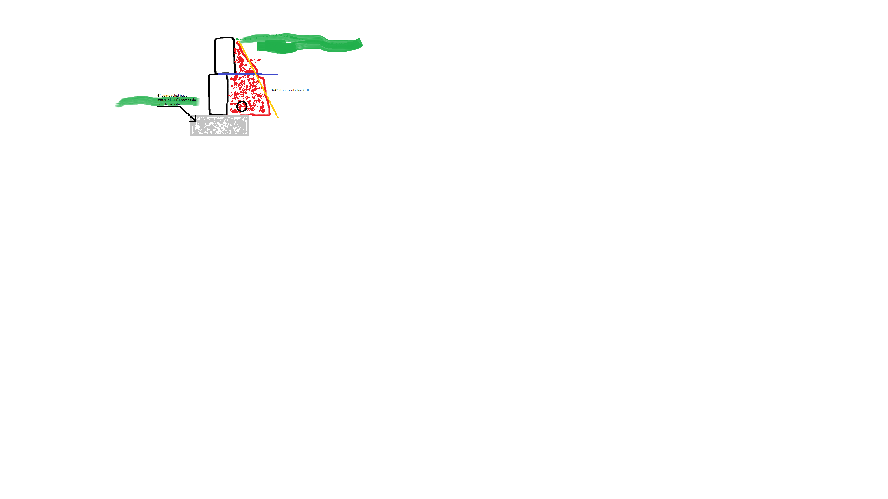

This is what i would do. Sorry for the poor picture but i think you'll get my point.
1) Remove all organic material under wall
2) Provide for 6" of 3/4" process compacted base , Do not use stone only. The reason you do not use stone only is because stone is meant to collect the water.
3) I would set first stone at least 6" below finish grade.
4)Tilt stone back alittle
5) Set second stone
6) Install 4" perf. pipe draining to daylight. "black circle in picture"
7)Backfill with stone 3/4" or like size "what ever is cheapest" Red area in picture
8)Install landscape fabric "yellow line in picture"
9) Backfill wall
Just a few notes. In my book you can or can not use the geo-grid thats your choice.
The only time you would use stone only under the wall is if you have a perf. pipe draining to daylight to collect and remove the water otherwise using process is the way to go as it will not collect the water like stone will. If you plan on bonding your top and bottom stone together with whatever product you select make sure it is flexible otherwise it won't work. The main problem i see with the way you are building the wall is the way i think your are thinking of laying the stone. As with retaining wall blocks when they are dry-stacked they have a way of locking the backs of the stone so they won't slide forward. If you layed the blocks flat i would say no problem at all but laying them on edge will make them top heavy and thats not what you want.
Again this is what i would do and as with everything else everyone has there own way of doing things. One more thing i would like to add and it would be alot of work. With the way you are stacking your stone the only way i would do it is if you had a hammer drill and pinned your top stone to the bottom stone then i would say have at it your good to go."Green Pin in Picture

The picture is fine - it's clear enough to get the point across.
So - for the compacted base you show in your picture - are you saying to NOT use just 3/4" stone? I used a product the Co. I got it from called "graded base" as the top layer on my driveway. The stuff is basically a rock dust 3/4 stone mix. It compacts GREAT. I've had it down for about 5 years now and I can have cement trucks drive across it and barely leave a tire track.
Do you think that would be a better base for the wall?
   / ? on proper install of wall in area subject to freeze - base preparation? #18
Do you think that would be a better base for the wall?[/QUOTE]
Correct you do not want to use just stone as that will collect water. You want to use something that will compact, size of material really doesn't matter but in your case i wouldn't go with anything that is over 1 1/2". Your process will consist of material from stone dust up to what ever size you request lets say 3/4". That should work fine as your wall base. If 1 1/4" process is cheaper go with that. They don't use large stone process under an asphalt driveway but for your wall you could use something larger. Like i said whatever is cheaper.
