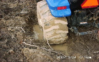

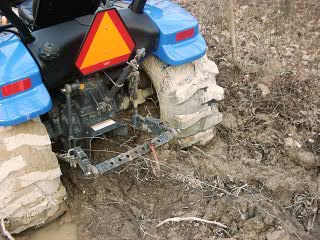

Here is a couple idea's...
Call a wrecker. The $50 or so would be small for getting your tractor out
Or, get a come-along. For $25-35, you would have something you could use again.
Get a Hi-Lift jack. For the $50, you could use it to winch, after you use it to jack/lift the tires a bit and block them up.
The drawbar is partially exposed. Get some planks under there, and a jack(you may need to dig it out a little to make room for the jack). Jack it up, and put blocks or planks under the tires. Repeat until it is high enough to easily get you out. Add those extra blocks; it would be bad to get it up just a little, go 2", and be just as stuck again.
I've put full size 3/4 ton 4x4's to the frame in the mud. Dig, dig some more, and jack/block it up.

Robert, I woould love to have another tractor come in and help out, but a tow truck would have to have a '500 cable to help out. Don't know if you can see that from the pics or not.

I agree with RobertN. A high lift jack will get you out. Put some planks under the draw bar, jack it up, put logs, rocks, or whatever you have under the tires and let the jack down. Repeat this until you have the rear tires up out of the hole. Use the FEL or jack to do the same with the front tires. Then, fill the trenches with logs, rocks or whatever. You'll have much better luck getting unstuck going downhill. Once it's out find another route up the hill. If you can't get it out that way, use the high lift jack as a come along. It's slow, but it will pull pretty hard. I got a full size Blazer unstuck that way and it was buried right up to the frame.

Otherwise... I would go back to the jack. You could even use the floor jack from you garage, so it does not cost you anything. Dig out under the drawbar so you can get a plank under there, and place the jack on the plank. Jack it up a little, and place boards under those tires. Jack it a little more, and more boards under the tires.
No matter what, it will take time, and be a pain. I've spent 2-3 hours getting unstuck that way.
