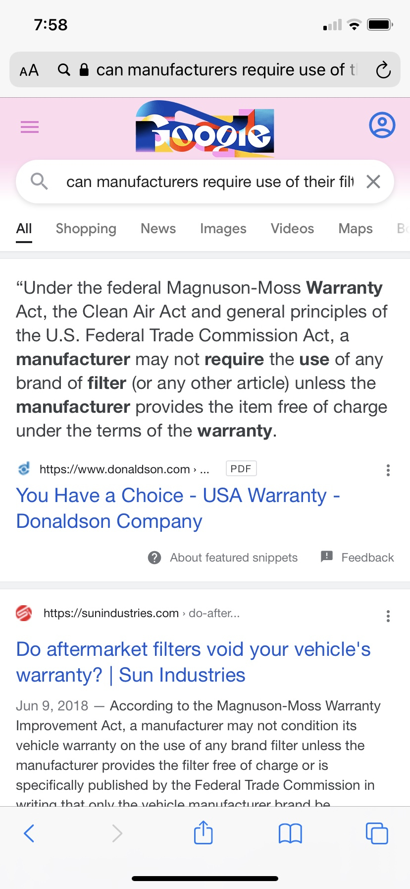

Here's the difference. If you took your warrantied tractor in to the dealer for engine problems and they open it up and find this and a non-OEM (this pic is from an engine that had a Wix installed, the orange bits are the pieces of the anit-drain back valve) filter installed they're going to void your warranty on the spot and tell you to talk to the filter manufacturer. If it's an OEM filter bought from an authorized dealer it's fully on the tractor manufacturer to resolve and under warrnty.

Not legally.

Apples and oranges. If a dealer finds pieces of a disintegrated anti-drain back valve from an after market oil filter clogging oil passage ways that has nothing to do with the Magnuson-Moss act. However, if it's an OEM filter then it's all one throat to choke and the dealer/manufacturer is on the hook to resolve the problem. Clearly the use of an after market filter, in and of itself, would not void the warranty. But again, that's not what I was talking about.

Kind of distill down to if there is a problem, the OEM can and will look for anything contributory and can and will deny if the determine there is. Using a non OEM part can be construed as a warranty breaker if the OEM decides it is and you are 100% at their mercy in that scenario. Sure you can litigate it but it will cost you in legal fees and in the end, you'll pay anyway. They have attorneys on the payroll for just that, you don't.
