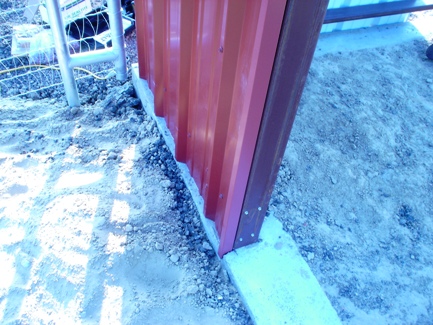

Here's why we do the ledge on the slab and beam. It not only helps seal the bottom of the building. It's a safety item when you consider the damage siding can do to a horse. This is a stall door to an outside paddock.

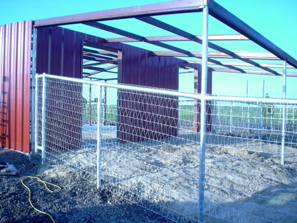

The horse barn is coming together.

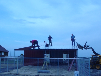

One of the things we do is put on the sheeting for the roof on the roof.
Here's four of us up there.
