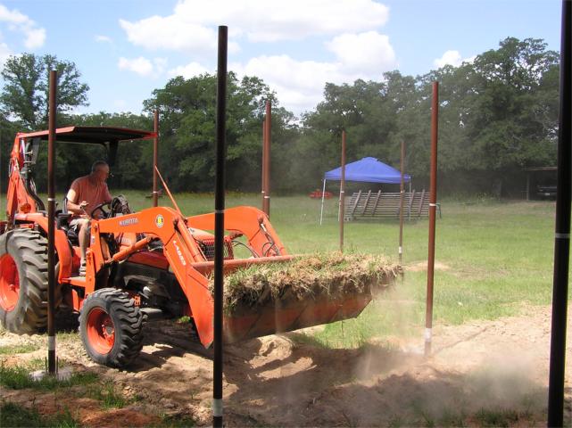

I decided to take a break today and do some TRACTOR work on the building. I need to remove the vegetation from the future storage slab area and replace it with compacted various sizes and fines of gravel.
Removing the grass and top soil. picture 1

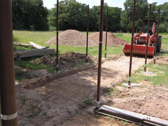

Picture 3.
Well, that took about 5 minutes.
As soon as it gets a bit cooler (this evening, not in the Fall) I will manually clear around the poles for the beam. /forums/images/graemlins/wink.gif

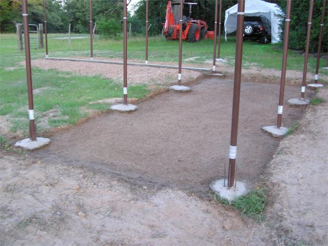

At sunset the storage slab area is cleared of vegetation and topsoil, raked, tamped and watered.
It is now ready to be graveled, leveled, and tamped tight, tomorrow.

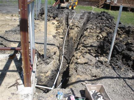

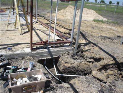

I explained to Don that I formed up the beam first. Then I decided where I wanted the water and electrical to come in to the building.
I cut two pieces of pvc at an angle and then drove them into the ground about a foot. This made it easier in this situation than digging out a cavity, roughing in the plumbing, and then filling the cavity for forming and pouring the beam.
Then I cut off the angle cuts and took off with the plumbing and electrical conduit.
This is in the county way out in the country. But I personally don't like water and electrical in the same trench. I ran the electrical about thirty inches deep and the water about eighteen.
A couple of years ago I put an auger through power and water at the same time. It was about a foot deep with direct buried romex and that black water tubing that comes in big coils. What made it extremely interesting was the electrical wasn't on a breaker and straight off the meter. /forums/images/graemlins/blush.gif
The auger came out of the hole automatically when it heard what sounded like a gunshot. I found the tap and cut it hot with bolt cutters. It's no fun hitting water and power at the same time.
