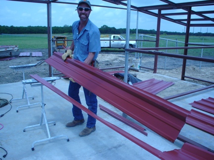

When I tell folks that us guys in Texas cut our thirty year siding with box knives they think we're talking stuff.

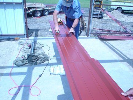

   / Only in Texas, Don and Harv doing
#174
And it is, tough stuff!
#176
Any time we have to make a cut and there's a seam to follow we'll usually use a box knife to score the metal using the seam as a guide. It's hard on the blades and thirty year sheeting is thick and tough. But after a couple of passes with the box knife we can fold the metal back and forth and it'll break clean as a whistle.
Keep in mind I carry all kinds of metal snips, a plasma torch, a Bosch nibbler, and a Milwaukee hand shear. But on long lengthwise cuts where I have a seam as a guide I prefer a box knife.
It just looks hard. /forums/images/graemlins/grin.gif

   / Only in Texas, Don and Harv doing #178
Hi Harvey,
When you say a box knife, is that the same as a sheetrock knife? Or are you talking about those smaller versions that you keep beaking the tip off of when it goes dull?
Great tip, thanks.
Eddie

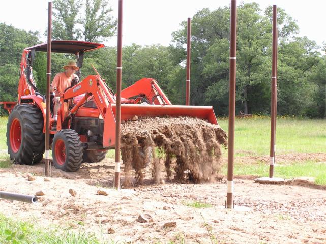

OK, continuing with the carport/storage, after the vegetation is removed I replace it with a good sand based gravel.
