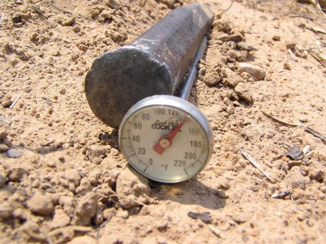

Trying to stay focused on a project when there are so many projects to do is a full time job. This retirement is almost like working and being self employed with myself being the only client. It is good.
Besides digging out the spring, attending community college, repairing things etc etc.... Anyway, enough excuses. Now that I have delayed my self into the summer the tools are really getting hot hot.

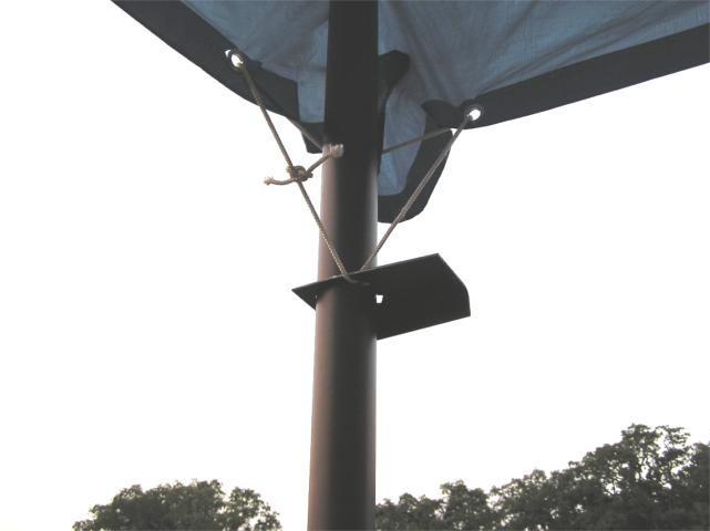

....but the Harvey "no slip" connectors and a tarp make some quick needed temporary shade.
Note: This is not the intended use of the clips but they worked great. The tension from the tarp holds them in a bind and no screws are needed.

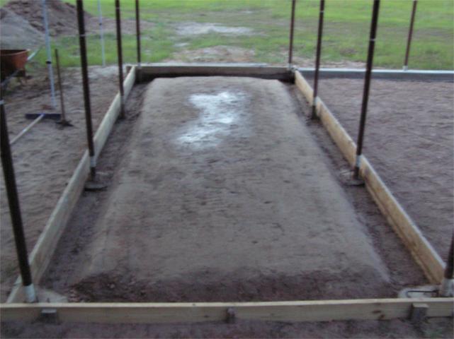

Finally finished the framing (except for the ledge) and packed in the gravel. On the top I put 1/2" of sand and tamped it again. I then soaked it and then tamped it again.
The beams are average 12" wide and 9" deep the slab (21'X9') will be 4" thick. I figure it will take about 3 and a half cubic yards of concrete including the beams.
Next will be the plastic and then the steel then the ledge and the electrical conduit and then I'll figure where the bolts will be located for one side of the door frame.
I was wondering, should I add another 9' beam in the center?
Sorry for the blurry picture it was taken in low light (9 P. M.).
