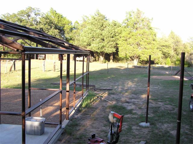

Harvey thanks for the info on the skin. I am almost ready to order. I want to take a few more pictures showing all angles to see If more bracing is required. The sun was in the way this evening.
The color of the walls will be brown or stone. The roof will be silver. I wish I could find some old barn wood for the carport area. The 4' peak at the entrance is a excellent place for some "art work".

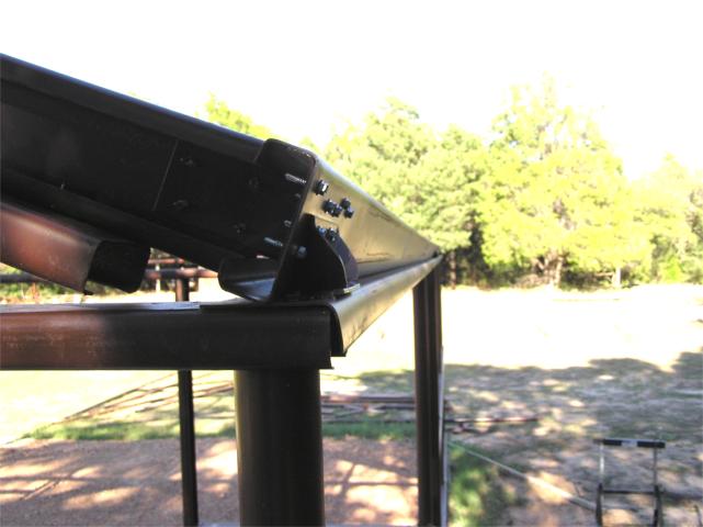

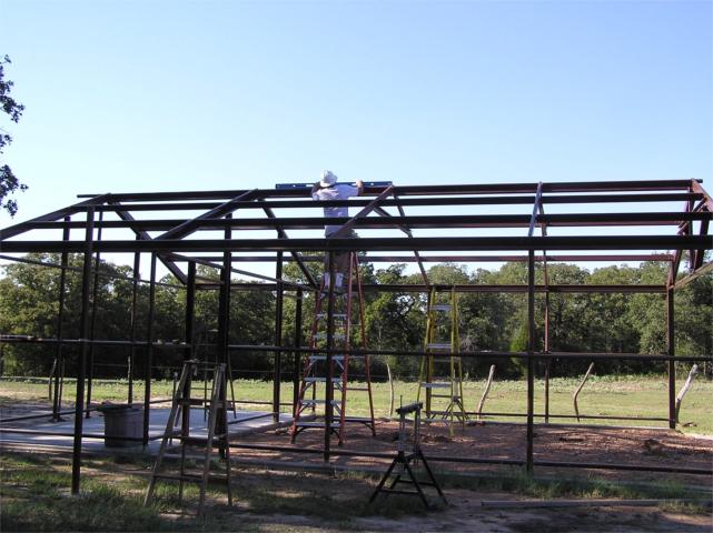

Well today I finally finished the purlins and collar ties and it was time to remove the TEMPORARY supports. For some reason this was both stressful and exciting. I was pretty sure it would not collapse, but I also did not want it to sag.

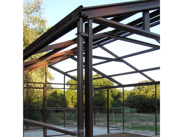

As you can tell it did not sag!

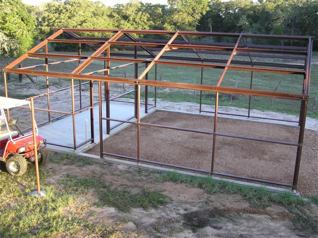

The next framing should be easy: the porched area for the golfcart.
Harvey how would you do it? Here are a few pictures.
After the porch there will the framing for the windows. Are the windows mounted on the inside or in the middle of the purlin. Will there be a angled window sill? Thanks!

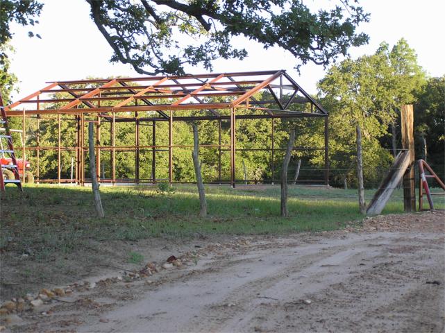

Don, that framing looks terrific. Everything is so straight and true that the crooked fence posts in the background stick out like sore thumbs in your "did it sag?" picture. I did a double-take until I realized what they are.:rolleyes:
   / Only in Texas, Don and Harv doing #308

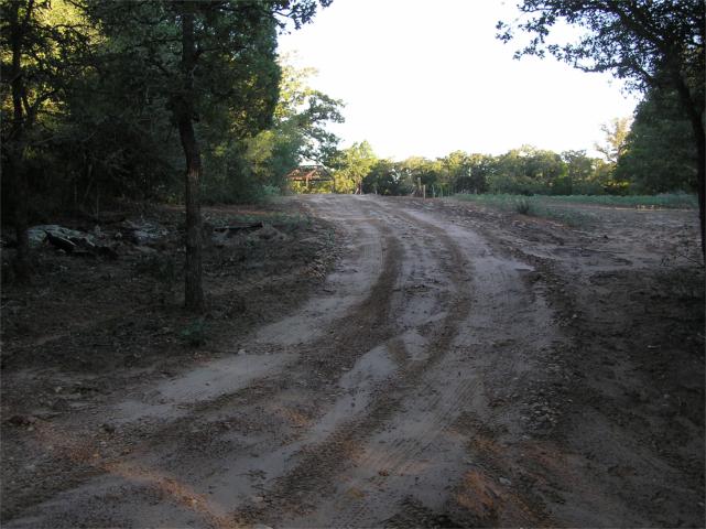

Thanks Jim. Those post are symbols of the simple way of life many years ago. They are from the property border fence and they outlasted the barbed wire.
I did not plan it but the old oak tree frames the building. The carport side and the front peak will be the first thing that you see as you come up the hill through the woods and around the corner. It will be important to incorporate the character of the place into the building.

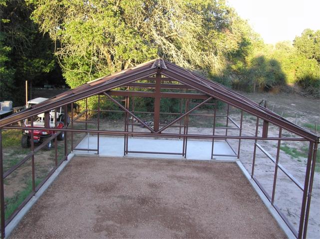

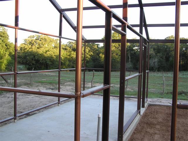

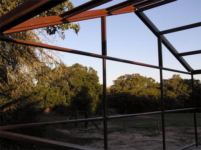

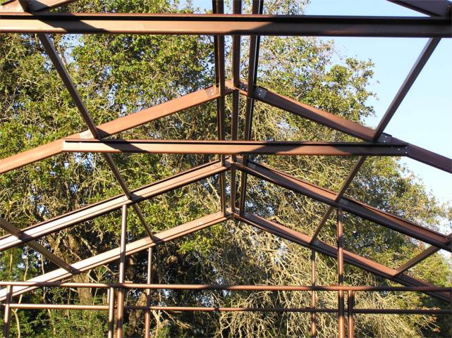

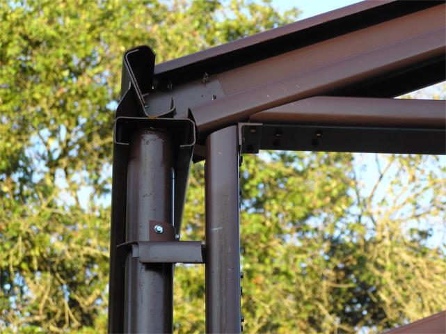

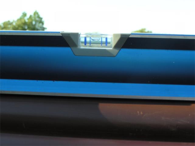

Harvey, here are some more pictures of the framing. If any additions or modification are needed let me know.

I'd shop at HD or Lowes or Ace or Seconds and Surplus for the windows and doors. The windows should have aluminum frames and then attach via screws and a flange screwed into the outside of the framework. The doors are installed just like you were building with stud or lumber framing.
The easiest way to do the portoche (LOL) is to extend the pitch from the roof straight down. If you have enough height that would be the way to do it. Then using brackets attach to your sill angled purlin and run rafters to the cartoche (new word for an old idea). That way you can order sheets that will run one piece. We might have to trim a piece if the sheets don't land just right. But it makes it easier and leaves a lot less potential for problems down the road.
If the angle of the pitch leaves the eave too short and a hazard for walking then place the rafters the same way but there will be a change at the edge of the building in the pitch. On Scotts we were able to do this and still use single sheets. But the change wasn't so great that we couldn't pull it down with the screws.
Keep in mind you'll need additonal gutter ends and down spouts.
