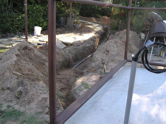

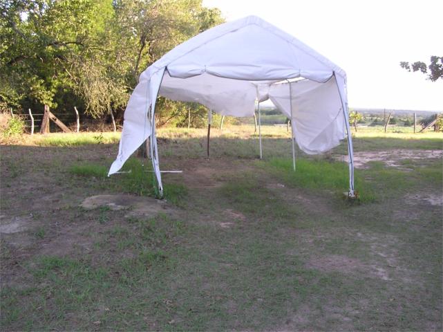

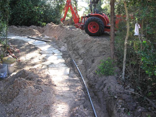

Update on the countdown, one month left:
Our temporary carport served us well, but the weekend wind was too much, we had to take 'er down.
I got the rock for the walkway and got about half through when the good rain came.
I had enough rock left over to rock the portico (a.k.a. lean-to).
But before I could place all the rock I first had to bury the electrical. This was the first time I dug a trench with the backhoe.
After the yard was closed up, rye grass was planted. I am ready to finish laying the rock....tomorrow.:) :)

The rock is Oklahoma 2" Patio. I got it from Bastrop Stone and Materials on Hwy 71. It cost $240 a ton. The amount of rock showing in the picture is about 2 tons.
I actually did part of the patio last year. This week I made it wider, and added the curved walk to the carport.
