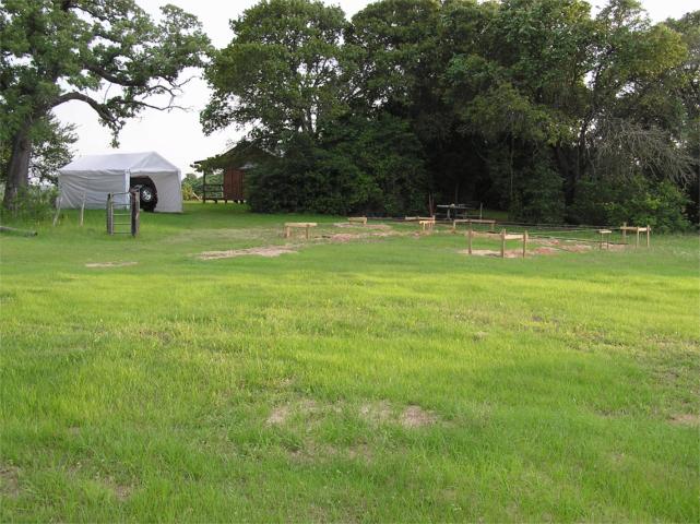

The batter boards are up and level to each other.
The building is fairly level front to back. From side to side (North to South) the North side is 10" lower.
The batter boards look like a woodpecker has attacked them but the nails now have their final resting place and the building is square.
Next time I will put the batter boards up first. I will have to re-dig two holes, but the rest look good. I am getting experienced.
This picture shows the location to the cabin. The official Texas TBN tent is serving as an temporary carport.
next on the agenda is to do a little hand digging and to set the first post. It is starting to get exciting! /forums/images/graemlins/smile.gif

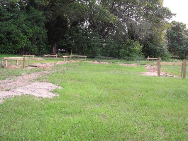

Here is another angle of the building site showing the slope of the land.

Hi Don,
Looks like your having fun. Just a litte question about your building pad. Are you going to put the posts in first, then level out the pad????
Why????? /forums/images/graemlins/confused.gif

Eddie Thanks, I'm not sure why. I think next time I will level first. I was wondering if it would be a problem. The project is small enough and I figured that I would just bring in some sand and gravel to level the 9'X21' slab. The top foot and a half of the building site is sugar sand and I thought I could build it up at anytime since there is an abundant supply of sand on the property. I really wanted to add the gravel so it would compact good and the slab will not crack. We leveled Scott's barn after the poles were set and there did not seem to be a problem. If this were a larger project I would level the site first.
