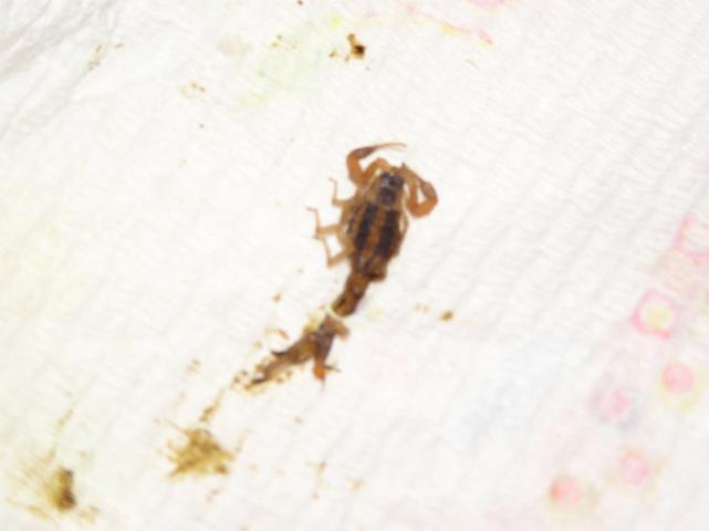

The computer is in the west wing, /forums/images/graemlins/grin.gif, the 16x16 room that is the living room, kitchen, dinning room and most recently the study. This was my first scorpion sting. There are so many around here I was beginning to wonder if they could sting. I was on TBN and felt something crawling on my leg, reached down to throw it off, without looking, and he got me on the finger. It stung for about an hour and this morning my finger is stiff when I bend it. If I find one at the bottom of a hole he will not get an elevator ride out. /forums/images/graemlins/mad.gif
Moderators, if the attachment is too graphic please delete. /forums/images/graemlins/grin.gif

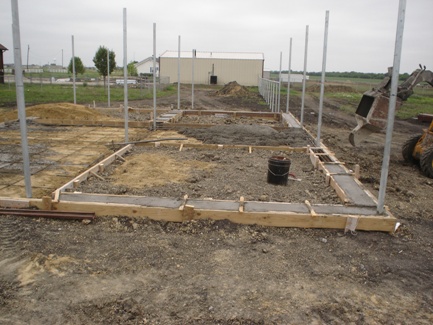

   / Only in Texas, Don and Harv doing
#49
</font><font color="blue" class="small">( Harvey, The poles for the storage area will be inside the slab area. Should I stick some rebarb in the top of the cemented pole holes that can be tied to the slab rebarb? That will be kind of like using the pole holes as piers. )</font>
What I did was put two lengths of rebar on each side of the posts forming a beam, incorporating the posts into the slab. I don't believe I'd worry about the tying of the piers to the slab, it's going to happen when you place the rebar around the posts.
I ended up with four pieces of rebar running the perimeter of the slab. The attachment will show you what I'm talking about.

Yesterday we re-dug a few holes. We made sure the post could level on their marks and were approximately the right height or higher. After we cement them in place we will cut the poles level on top.
Today we will start to place the poles in cement, this is the before picture.
