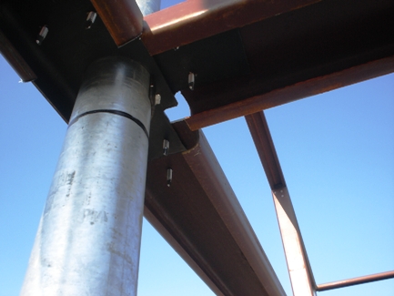

Eddie I do the pipe and purlin construction a little different than I would with lumber or conventional metal building methods.
After the posts are set I go in and shoot a baseline. The only thing about this baseline I care about is it's on a level line across all the posts.
I can then decide where I want grade to be, where my height will end up and have a place to measure from for all my horizontal rails. Here's a shot of the baseline on a post.

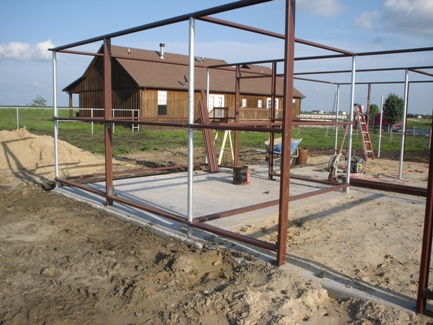

Yesterday at lunch I started installing brackets and laying out rails. I had some help cutting the rails but basically this has been a one man job.
I've been going slow and trying to figure out how best to explain the system.

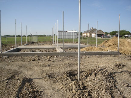

Here's a shot of what we had after the posts were set and concrete was poured.
   / Only in Texas, Don and Harv doing
#59
This is going to be a twenty four by thirty two horse barn with twelve foot overhangs.
This is view from the north west corner showing one of the three stalls. The concreted floor to the left is the twelve by twelve tack room.

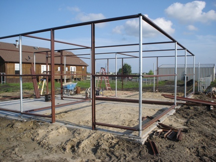

The layout and construction of the tack room is going to be close to the way Don is going to build his storage area.
The biggest difference is I have suggested Don use more posts. His are set on seven foot centers and the barn here I used twelve foot centers.
All of the walls on this barn will have a three quarter inch plywood interior wall. So I didn't feel we needed having the extra posts.
Another consideration was the fronts of the stalls will be shop made as will the divider between the south end stalls. That way the south pair of stalls can be opened up to one stall for events like foaling.
