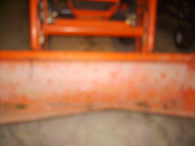

Well I made a mistake. Got off my tractor and forgot to put the brake on. It rolled about 30 ft., and the bucket hit a tree. As you can see from the picture, it's bent pretty good. Do you think it can be bent back to a usable state, or is a new bucket in my future? If you vote on repairing it, what type equipment will be needed to do the job? Do you have any idea of a ballpark cost to get it done?

Sure it can be repaired. I'd say put the bucket in the back of your truck (trailer) and go visit your local auto frame repair shop for an estimate.
/ Oops Bent Bucket #3
That can be bent back. I don't think I would use the hydraulics to try and straighten it out. If you can get a good sized bottle jack wedged in between the top lip and the bottom edge. Maybe use a good strong piece of steel to fill the gap between the jack ram and the bucket edge. Just watch so that the jack doesn't pop out at you.

That's what I would do also. Maybe when you're all done, a bolt on cutting edge on the bottom would help it retain it's shape now that it has a weak spot.

I would say that is repairable. If you have access to some good heavy angle to put across the top of the bucket so you do not bend it you should be able to use some jacks and straighten it out. Other option may be to come up with some kind of a jig to set it up on and then pull it. May have to drill a hole behind the wear bar edge and use some angle iron to get a bite on it.
/ Oops Bent Bucket #8
Better pictures at different angles would help with this internet looking. But it looks pretty bent to me,everything else alright,arms and stuff,be a shame to go to a whole mess of trouble just to find out something else is bent or damaged.
/ Oops Bent Bucket #9
Id say you could bend it back... but rigging up the tooling to do it is probably outside what the avg person can do. I have a 20ton bottle jack but your ablity to jack the bottom down is only relative to how stiff the top is.
You may need to take it to a local frame shop/machine shop to have it straightened.
As others have said, id add a tooth bar or cutting edge or something to reinforce the bottom now that it has been bent like that. to help keep it from bending as easy next time.
/ Oops Bent Bucket #10
Worst case, you may have to cut it at the worst bend section and bend the two halfs, then weld the split back.
/ Oops Bent Bucket #11
Don't bother trying to push against the topside of the bucket. Put a chain across the bucket and secure it at both sides at the bottom. Put a hydraulic jack between the chain and the bottom of the bucket right at the most bent part and push it back down. You will probably have to readjust the chain length if you run out of jack stroke.

Once the steel is stretched like that, it is hard to regain the integrity of the steel. I would just replace the bucket. I believe that if you don't reinforce it somehow it will bend again easily with any weight in it. If it was off to one side or the other, it would be stronger when straightened. Thank the good lord it wasn't like this.......

You can fix it. Find a 8" web "I" beam as wide as your bucket. Find two peices of 6" wide x 3/8 or 1/2 thick about 2' long. Weld the 2' long sections to the out side of your bucket and weld the "I" beam between the 2' long sections. Put it all together so the beam is above the bend. Use a porta power or a 20 ton jack and start pushing it back down until straight. When done cut off all the parts you welded on. I would bend it back cold.
Or take it to the local welding shop and let them do it. This is an easy fix.

In my body shop, I would put a piece of plate steel inside the bucket, and using a large hook, I would chain the center down, pulling down on top of the plate. Put a jack under each end of the bucket, and presto. :thumbsup:
